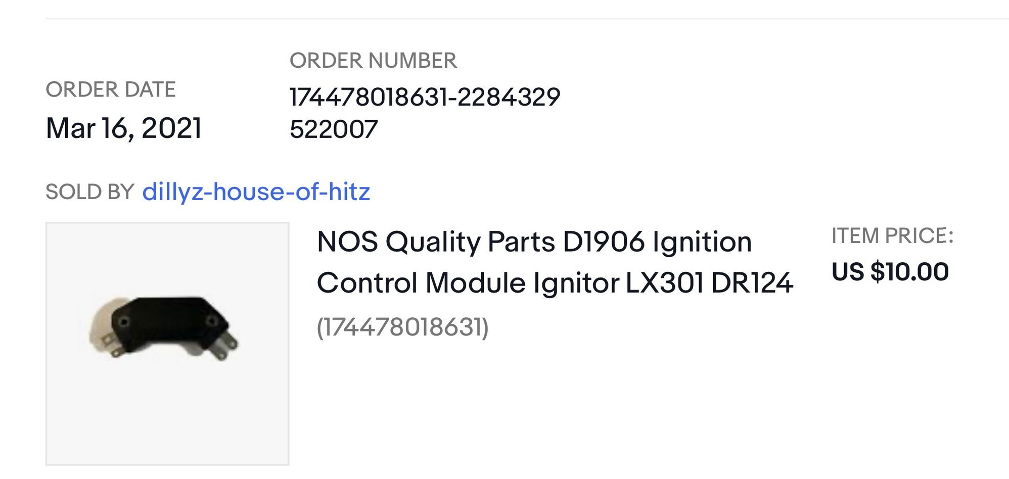

I just picked up one of these myself since they will only get harder to find. https://www.ebay.com/itm/32137912014....c100227.m3827
