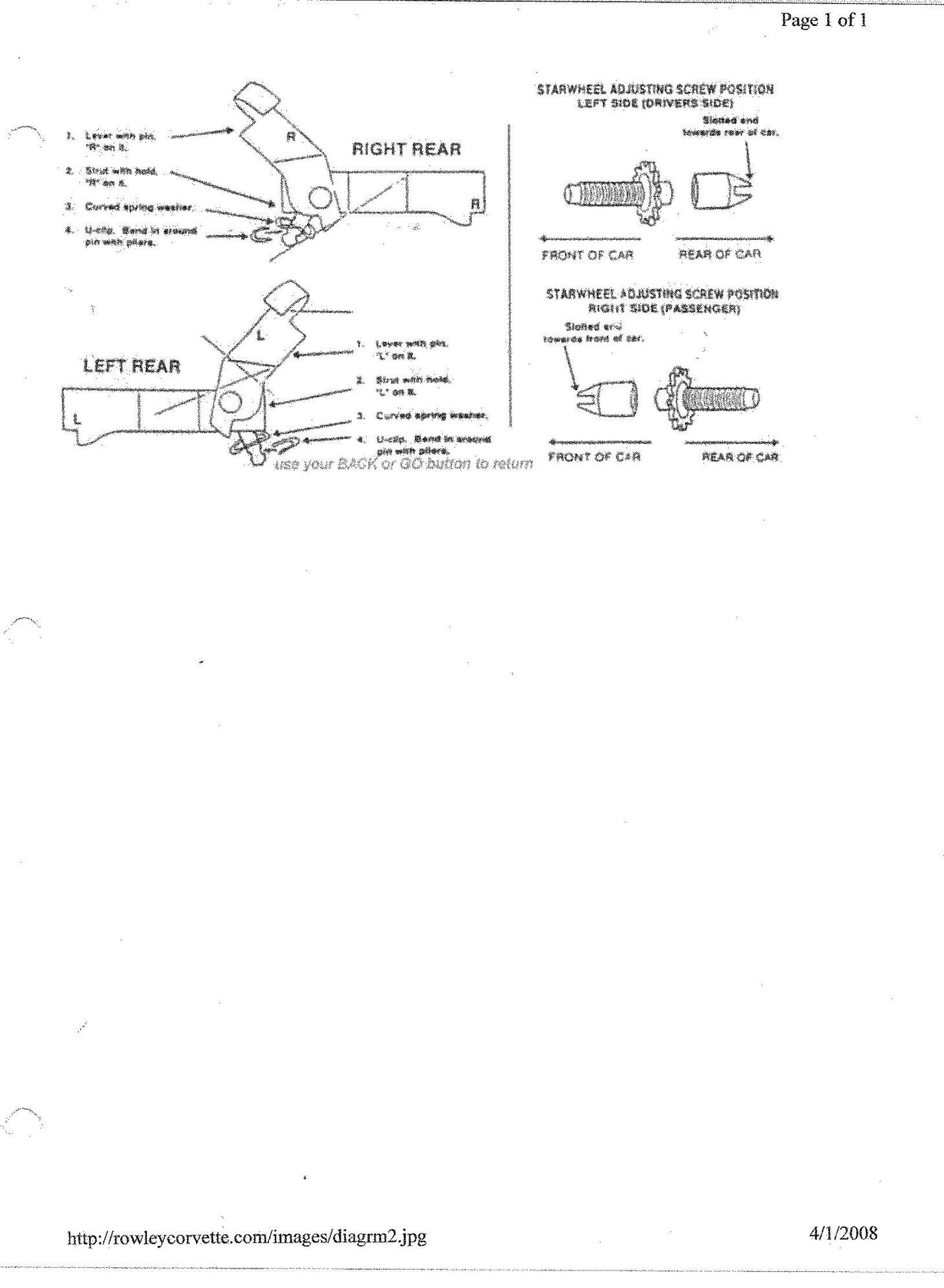

Do you see something wrong on my mounting :
Thank you again for your help :-)

The upper picture is the LH arm, the star wheel should be pointing to the rear. The RH points to the front as you have it. The anchor locks should not be bent over on the large ears, they act as guides for the shoes. The small tabs bend over to lock the bolt head as you did.
Also make sure the d-flat in the legs is on the rear leg otherwise, you won't get the shock mounts in.

I had remarked the false way of the star wheel on the picturesbut thought it is only disturbing for the tuning of parking brake, not the function of the starsheel itself : correct ? Otherwise, I'll try to also correct this.
Good remark for the D-flat : I had to change it before I mounted the arm ! (but remarked before...)
