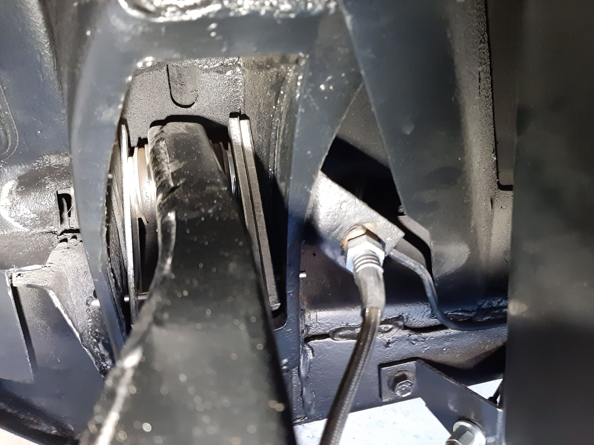

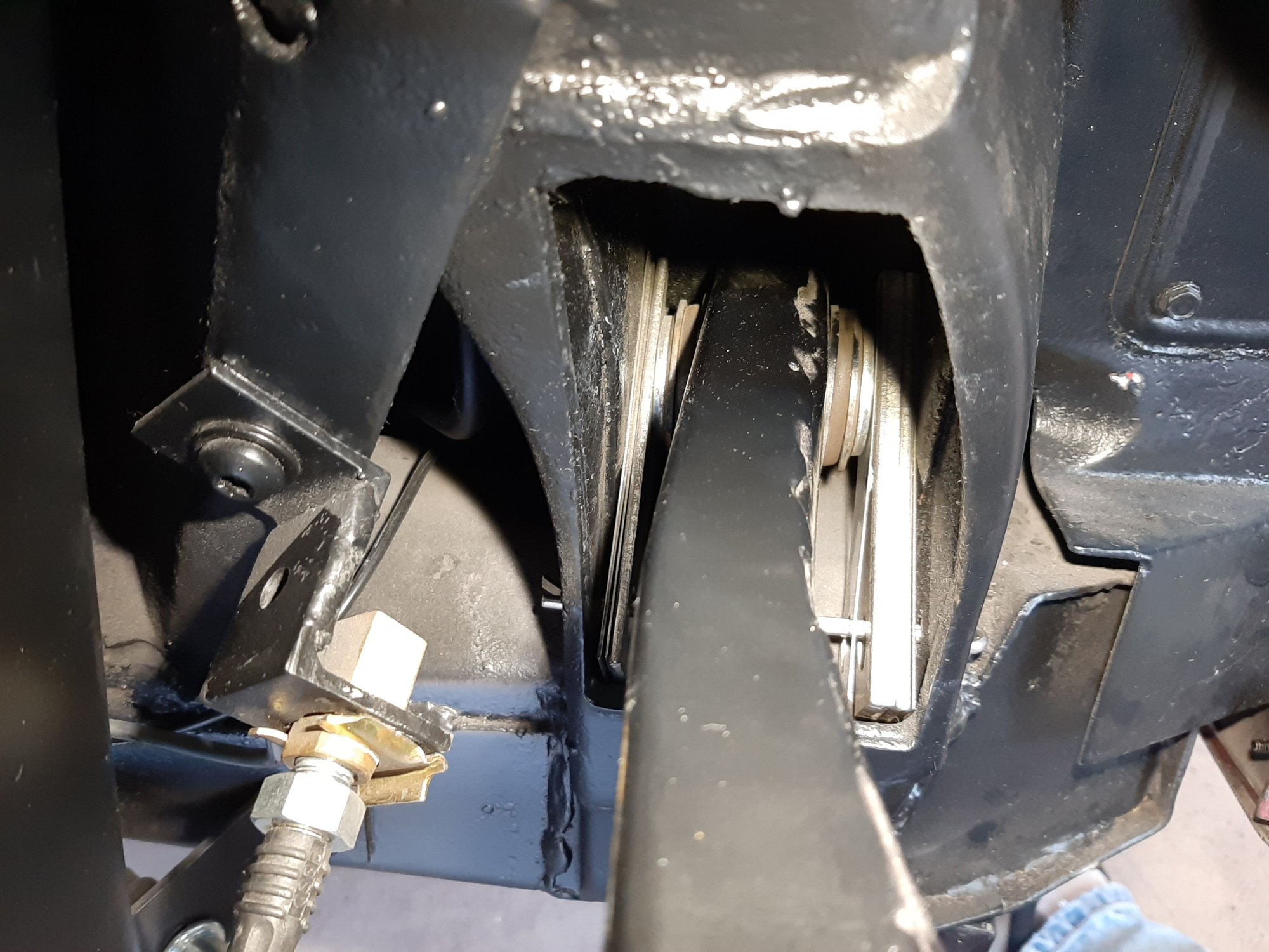

Thanks Leigh, and everyone else who responded. Planning on just making a small change myself as I can do it in the time it would take to just drive back there, much less have to argue with them to redo the job and then wait again for the car. The pass side will be a quick job to move the 1/32" from outboard to inboard. Have a number of extra shims so with my dig calipers, can get the right adjusted thickness on driver's side as well.
Sounds like no rush, but a quick fix to help the tires wear better. Will also confirm the readings afterward as well, as this is a pretty unscientific approach without a second toe measurement on a rack.
Here is the pass side. Easy to move a shim.
Driver side. A bit more to get the measurement right, but pretty quick job as well.
Thanks.

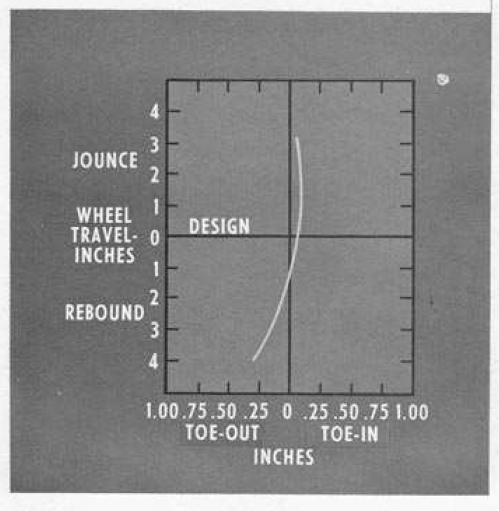

Here is the rear toe-in or bump curve according to Duntov:
We are most concerned with happens to the toe-in from 2" up or 2" down from normal.
It does look like it loses about 1/8" of toe-in in these conditions.
So a setting of 1/4" toe-in should prevent it from ever making it all the way to zero, or heading over to the dark side of "toe-out"
Toe-out n the rear would make it squirrely, either in a hard turn or under braking, neither of which is good and should be avoided.
So 1/4" is enough. to prevent that. Even 1/8" might be.
Any more just contributes to un-necessary tire wear.
Conversely I definately would not recommend less than 1/8"

I would leave it at 3/16" toe in on the rear, I'd even be tempted to add a little more if it still feels a bit squirrely in the rear when accelerating or turning hard. Leigh is on the money as to why - at your current ride height, any travel in bump (such as when accelerating hard, or on the critical outside rear when cornering hard) will result in the wheel and tyre moving towards toe out. You are currently sitting at about the 2" lower point on that graph. You need a decent amount of static toe in to counter this.
