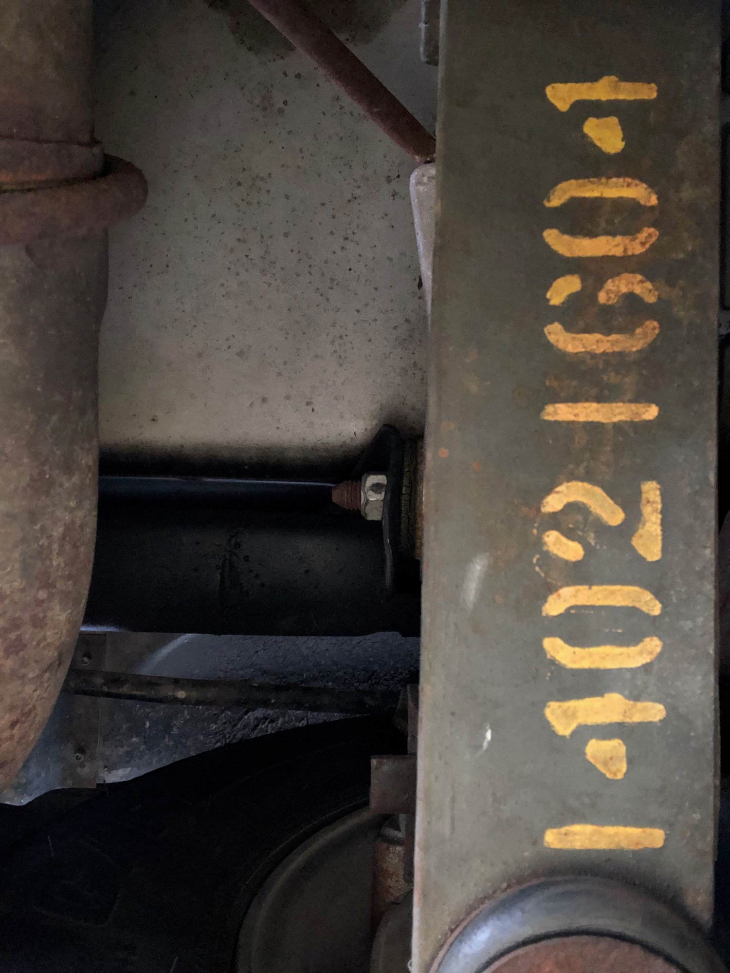

Thanks all for the advice! I went back to double check my leaf count and noticed a number on the spring. Doing a search for the part number, I think it's the same as the standard 9 leaf 2-1/2 spring from 78-80. Strange how the gymkhana in 81-82 had the standard spring rate as earlier standard suspensions.
I checked my trim height, it's 8.25" all around. So I think my spring is still good. I'll see if I can just replace the liners but I've yet to find any for the 9 leaf 2-1/2.
