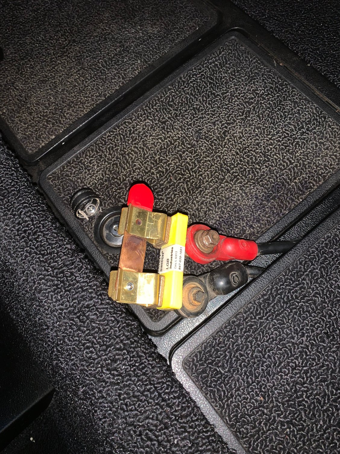

James is this what you are referring to by “quick disconnect”?
