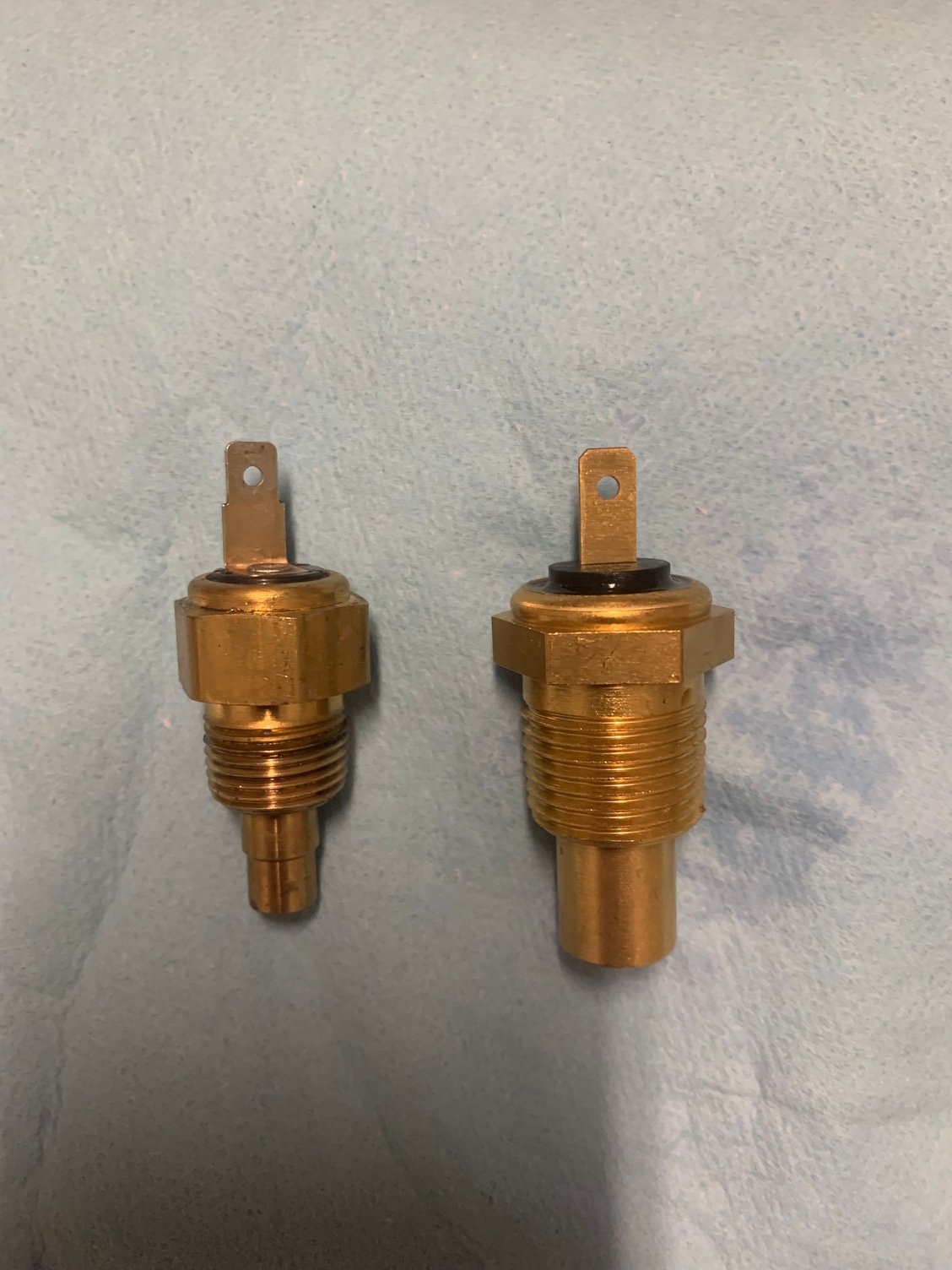

That part came in and I removed the sensor from between the #1 and #3 spark plug. What came out is on the left. The part we thought would fit is on the right. Size and threads are different. I have checked the engine block and the numbers match. Any guess as to what is going on?

The one you pulled out is 3/8 pipe thread. The new one is 1/2 pipe thread. Usually the 3/8 threaded ones were for cars that had a temperature light. The 1/2 ones for temp. Gauge. I know Wilcox corvette has the correct one that they machine down to 3/8 thread but I think they are out of stock for now.
Some one may have replaced the heads at some point in its past and that’s why it has smaller threads. The one you pulled out looks like the one I have controlling my electric fans. It’s an aftermarket preset on/off switch. May be why it doesn’t work with the gauge.

I want to thank everyone for their inputs. I was able to find an adaptor that allowed me to use the correct Water Temperature sensor. We placed the adaptor onto the sensor with oil in the gap and then screwed the adaptor into the head. Problem solved.
