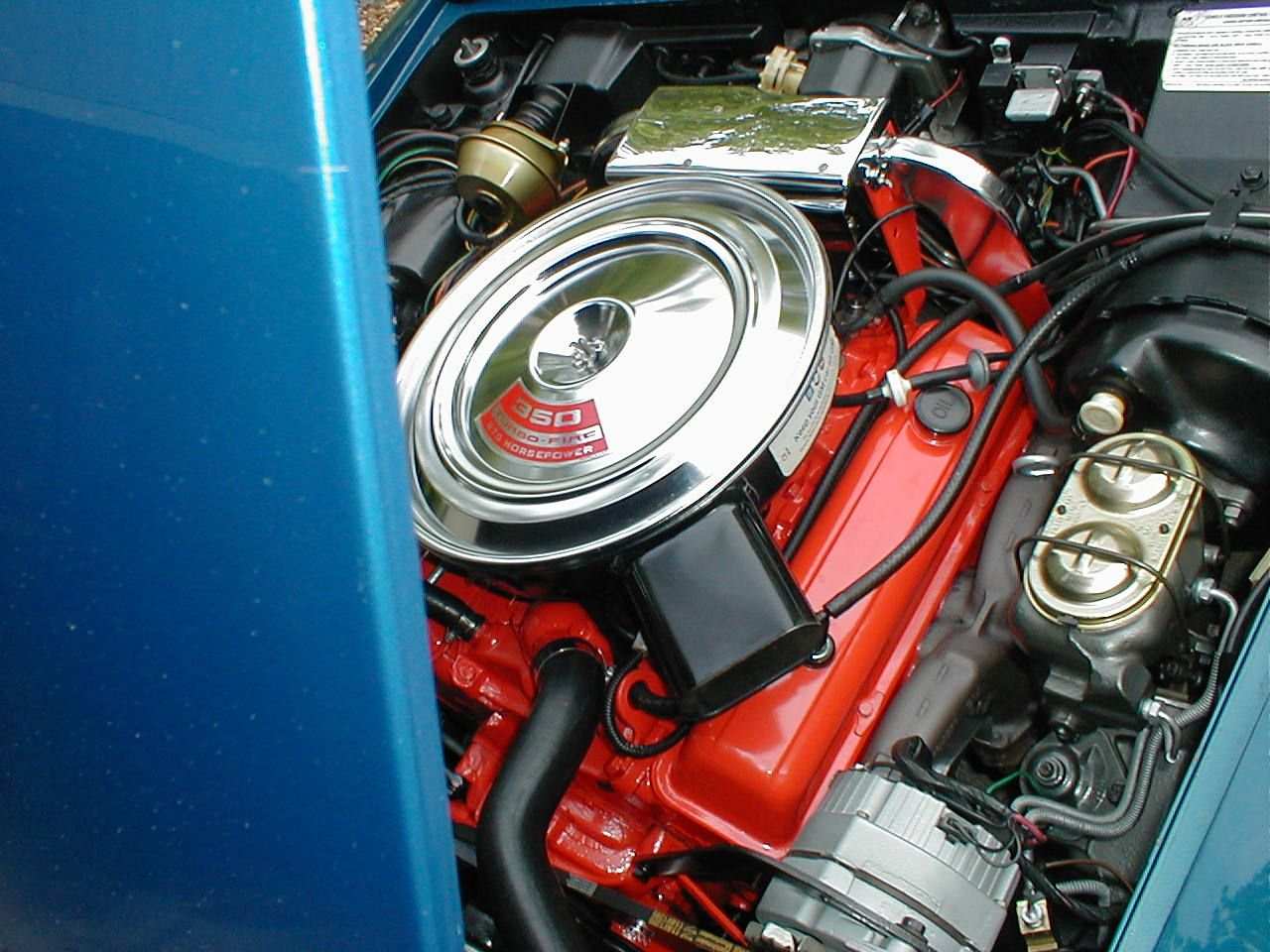

I took of my Big Block exhaust manifolds and replaced them with the Hedman headers.
The original big block exhaust manifold flows a lot better than the ram's horn style. I am going to send my original exhaust manifolds out to get them ceramic coated both inside and outside. I am also going to spec out the Higher temperature Ceramic Coatings they use on the NASCAR circuit with their high compression engines.
Below is a picture of what the factory Big Blocks left with.
