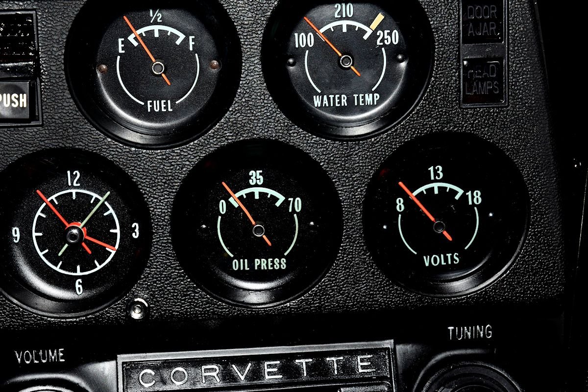

Old Aug 2, 2021 | 08:28 PM
C3 Stroker's Avatar
C3 Stroker
Posts: 3,922
Likes: 733
From: Youngstown Ohio
Originally Posted by theandies
I'll be ditching my ammeter when I go to electric fans. Does anyone make a stock looking voltmeter with the green letters/numbers? My '71 has the green gauges.
Yes, Zip........that's where I got mine.....68-71 with correct green characters......same link as noted above...https://www.zip-corvette.com/68-71-v...xoCvy8QAvD_BwE
Mine

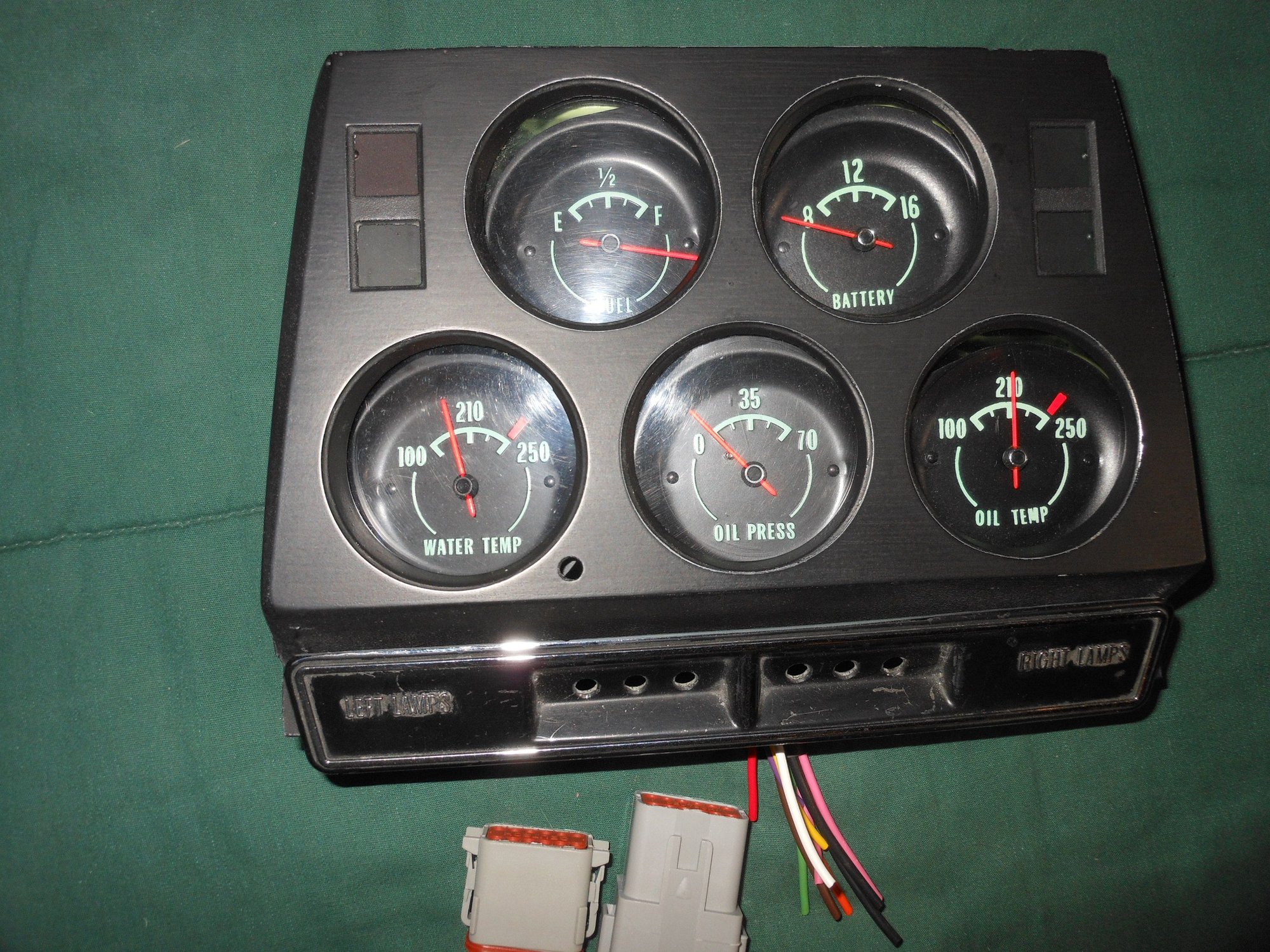

I even got an oil temp gauge to match-
Old Aug 3, 2021 | 12:37 AM
7T1vette's Avatar
7T1vette
Posts: 37,637
Likes: 3,116
From: Crossville TN
Did the vendor do that for you Richard? Or did you just black-out TEMP and use transfer lettering to add OIL???? Either way, it looks good....
Old Aug 3, 2021 | 09:35 AM
Richard454's Avatar
Richard454
Joined: May 2003
Posts: 8,875
Likes: 3,554
From: Fernandina Beach FL
It's an 81-82 gauge with the 71 face - Corvette Instrument Service did it for me. Using it on the dry sump tank.
