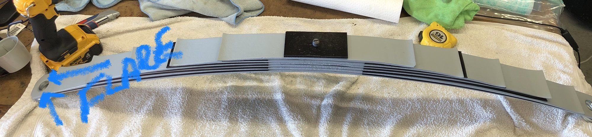

Looking at your picture I see some other things as well= The cups in the arm and spring are not flared, there is rust separation in the arm= look at the lower overlaps and the material in between them is rust scaling. I would be more concerned about this.

Can you show me a pic of what the "cups in the arm and spring are not flared" look like? Are you saying I need new arms?
took me a minute too…where the cup goes into spring and arm it gets flared to keep it in place.
Post 12 and 14
https://www.corvetteforum.com/forums...questions.html

There are some good pictures in the link referred to.
Your arm clearly shows rust separation. The arms are nothing more then overlapped c channel. Moisture, salt, etc gets in between and they rust from the inside out. The area inside the large opening is another one that swells up. I cover this in my seminars and have a cut away showing how much this continues to expand and weaken the arm. I have had arms come in with holes through them. I would check both arms and make your decision.
Post 12 and 14
what spring do you have? Im 28 +/- ish all around..
I have the original spring. Also my bushing is sitting in a cupped washer unless Im confused as to what your talking about.
