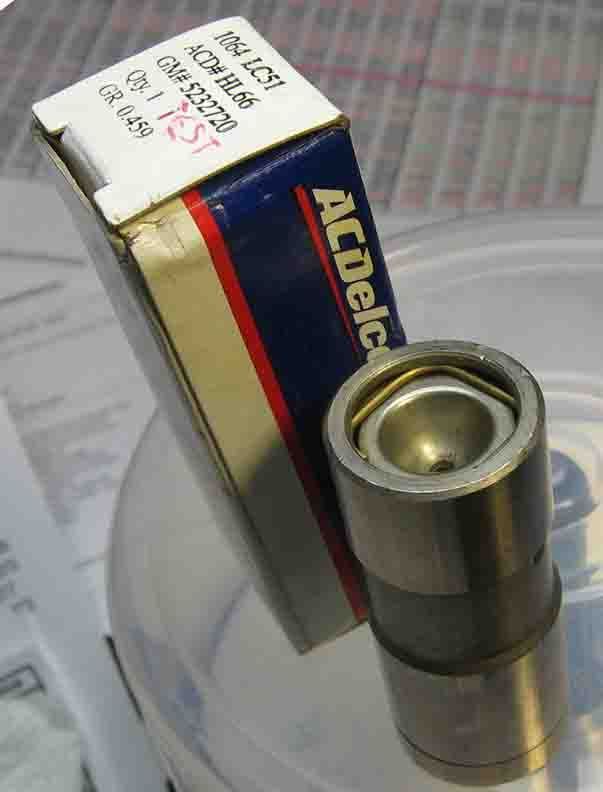

IMO there is only one SB Chevy flat tappet lifter, GM 5232720 @ $11.26 EA

The OEM lifters is probably the best flat tappet option regardless of price . I agree with the Ken Ellison in his recent cam failures videos,
