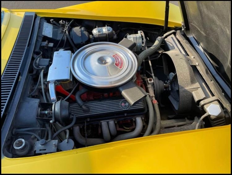

Hello, I’m new to C3s. I’d like to ask if this engine is original to the car (71). Thanks.

The answer for the 71 OP (poster #1) is it looks like it could be original but does have some modification (like headers). As mentioned by poster #2 and his 73 pictures, the VIN and engine code match is the way to check further. Got my laugh for the day...thanks guys!

Replaced parts or missing that can be seen.
Master cylinder.
Water pump.
Upper Radiator Hose.
Radiator.
Radiator Cap
Ignition Wires and cap
Valve covers
Wiper door actuator boot
Unusual bracket on passenger hood latch
Lower ignition shielding and spark plug heat shields
Alternator
As stated exhaust manifolds
