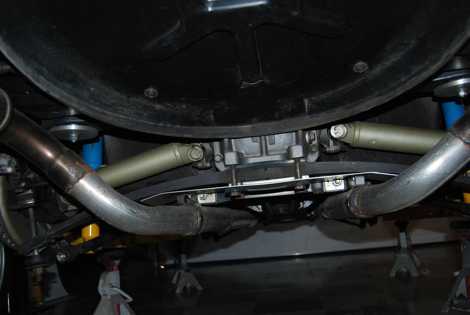

Originally Posted by ignatz
Nice job but I will mention one more thing. Some people wrap their exhaust in that area while others put in an aluminum shield. They were once available pre-drilled, I don't know the story now. Some have also said there never was a heat problem and didn't need anything.
Myself, I made my own shield extra wide and added some brackets to support my exhaust in that area. Each to his own, here's my setup. By the way I have had this spring for at least 25 years, same 330 as yours I think. It was a fantastic improvement over the steel spring. I never saw that insulating pad break down either.
The over-arched spring was the TRW. I threw that one away.
I just used header wrap. Been on there forever and works good.
