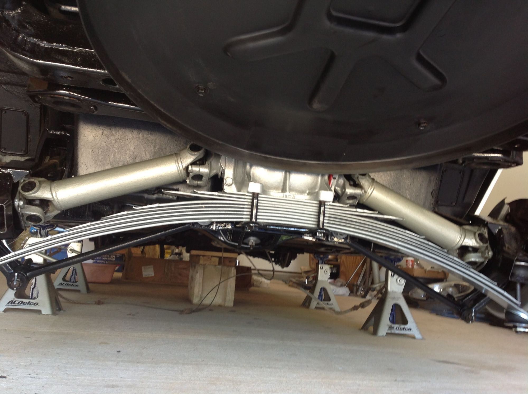

Originally Posted by 7T3stinger
Well other things have been replaced with new stuff I figured why not the spring. It does bow downward a little at both ends if that means anything. It also sits a little lower on one side (driver). There are new shocks, spring bolts and bushings from previous owner.
This is my original spring before I reconditioned it:
This is after with new liners and remounted:
This is how the spring looks back on rear:
Donnie
To leaf spring
