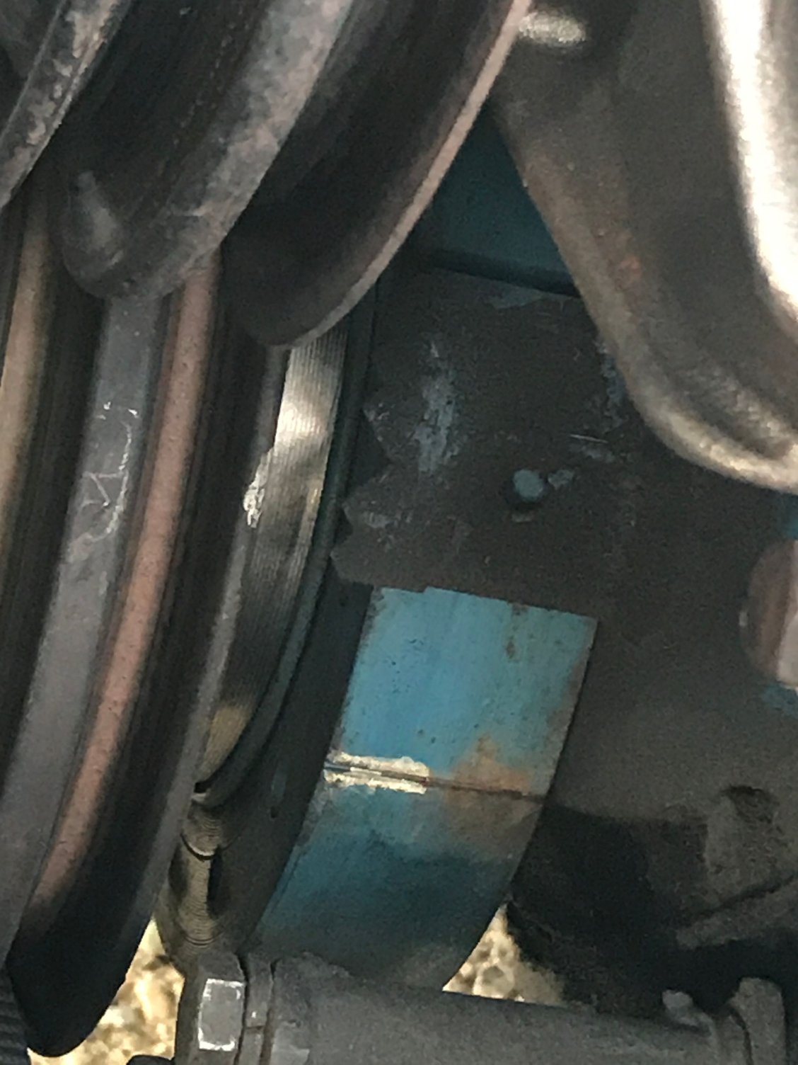

this is what the mark looks like at tdc. Its a lot closer than I thought it would be, but still off. I imagine the new mark with be where that hole and indent is on the bracket. Does this look in line with the symptoms above?

You should have opened with this photo, and we wouldn't have wasted time with advice.
You need a new harmonic balancer. Your outer ring has slipped BACKWARDS a half inch. I would not drive that car until it is replaced.

does driving with a slipped balancer cause damage? I had it tuned in Feb, and nothing was mentioned to me. I didnt even look down there until august i’d say, when issues started to arise. It looked like it does now, so its been in this position for at least a month to 5 months

It is not fully functioning as a harmonic damper. At a minimum, that can put extra stress on your crank and bearings.
Like I said, I would not drive it like that. I did not add that I have plenty of other cars to drive while I wait for the part, I have the tools for the job, and easy access to R&R with no shroud or clutch fan in the way.

You may need a new timing cover as well. That slipped balancer may have "rubbed" a hole in yours.

My balancer slipped about 30 degrees on the hub - thought my timing light was malfunctioning.
Sent the balancer to Damper Doctor for a rebuild.
