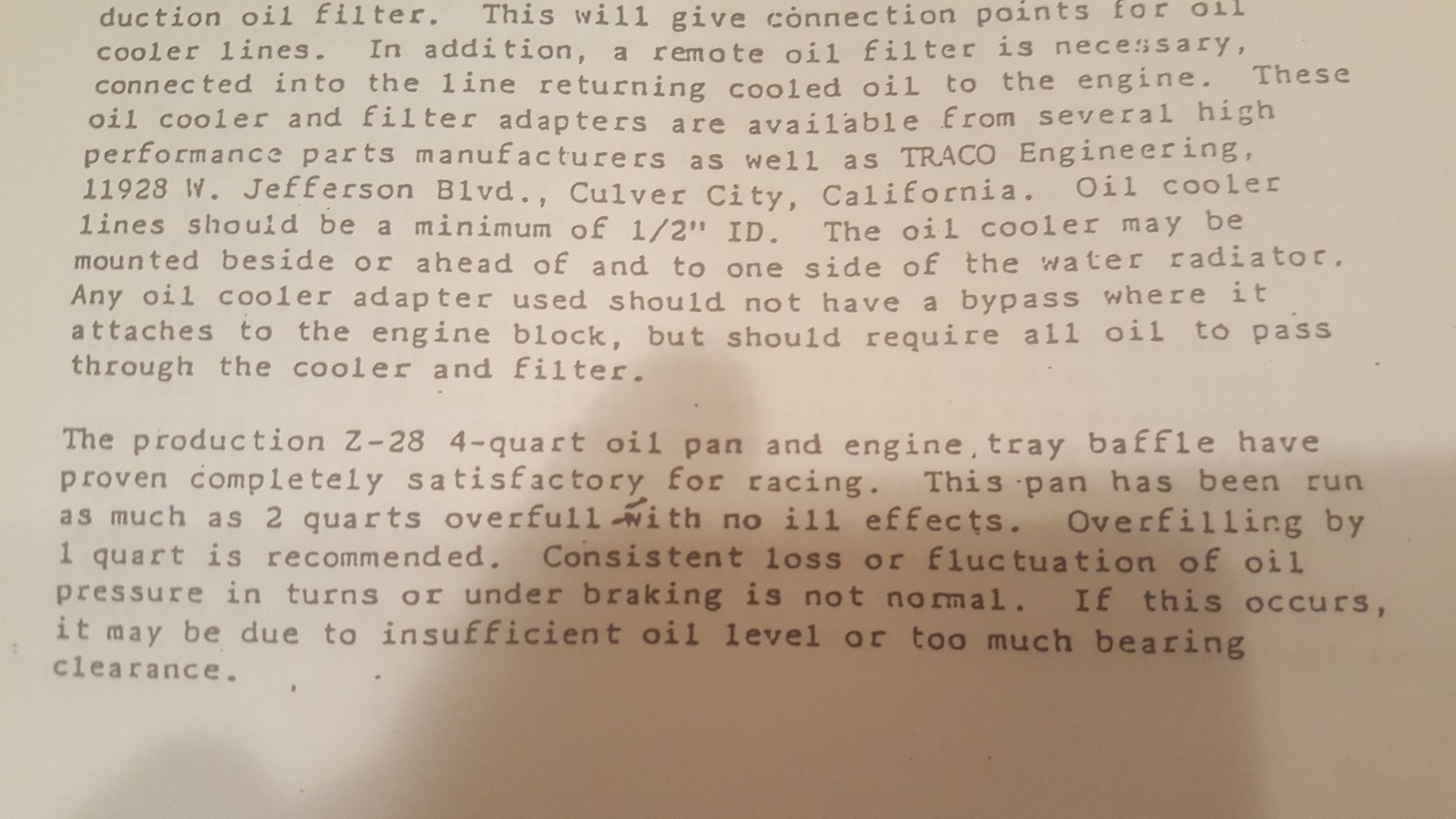

The concern about running the pan dry is not really a fairy tale. Running extended high RPM small block with bigger bearing clearances during a lively race track event CAN run a pan dry and expose the pickup. Obviously it is not good to have that happen. High RPM and high pressure slings more oil out the rod bearings and with excessive clearances it becomes an issue. This concern was mitigated with proper racing (sensible) bearing clearances and running stock volume pumps with high pressure springs along with the baffle tray and the matching pan. They advised running 1-2 quarts over full for competition events, as required.
A page from a GM "Camaro Chassis Preparation" packet. This was provided to SCCA racers who asked for it 50 years ago.
