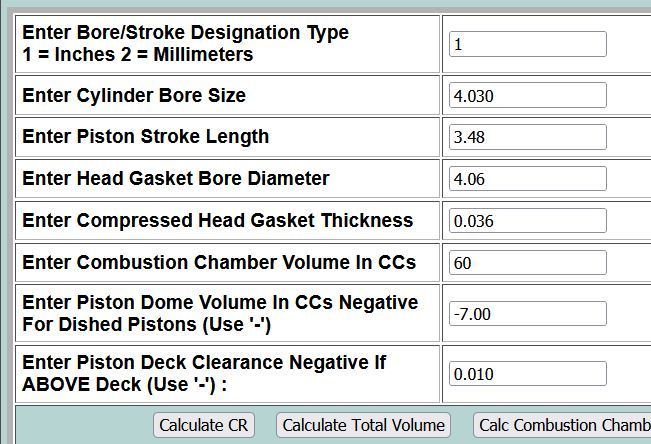

So here is my first stab at putting together a parts list for this engine. The more I've thought about it, the more I've wondered what effect lightening the RA might have, even if I don't change the stroke. Plus I suppose an argument could be made that 50 year old cranks may suffer some degree of metal fatigue. So I'm including the possibility of a new crank. I have two listed. The Eagle is a lighter, but it seems like Callies has a better reputation. What do you think about that?
Trick Flow 175 heads:
https://www.trickflow.com/parts/tfs-30210006
BAM Bushed Mechanical roller liters:
https://vincentperformance.com/shop/bam-b-2001-16-bb4/
Crower steel roller rockers:
https://www.summitracing.com/parts/cro-73641-16
Lightweight crank:
https://www.speedwaymotors.com/Calli...Rod,61365.html
OR
https://www.summitracing.com/parts/e...make/chevrolet
Cometic MLS head gasket:
https://www.summitracing.com/parts/c...make/chevrolet
Wiseco forged pistons:
https://www.summitracing.com/parts/w...make/chevrolet
Scat 4340 rods:
https://www.summitracing.com/parts/s...make/chevrolet
When I plugged this into a comp ratio calculator, it gave me a static value of 10.48:1 if I got all the numbers right. That's with the stock deck height though. If I need to have the deck leveled, I'll have to mess around with the gasket and/or pistons to get it right. I don't have a cam in there yet, but maybe use something like Leigh mentioned above.
What do you guys think of this list?

The first thing that I would do is sell those heads. Those heads have short valve stems and springs limiting to .540 lift. The heads valve diameter is actually the limiting factor on head flow. you should look at heads with 2.05 , 2.08. If you want over 400 hp you need to be looking for 195 to 200 cc intakes. I'm also an angle plug person because they generally use 3/4 inch deep reach plugs. Lot's of threads.
Rods. You should be looking at 6.00 inch II like higher end stuff because you only have to buy them once and they are good for lots of rebuilds. I also like rods that have HP ratings. Like both my engines have 1200 hp ratings
Manley 14054-8 Manley Steel H-Beam Connecting Rods | Summit Racing
Crankshafts. 42 pounds is a common light weight quality crank. Like I said when cranks cost the same price you might as well get the longer stroke. Their are all kinds of SBC stroke length.
These are the rockers that I use. They kind of have a lifetime partial warranty. Like I have some that are loosening up and I can send them back and I get new ones for about 1/2 price.
I use the Cometic .027 head gaskets
COMP Cams 1805-16 COMP Cams Ultra Pro Magnum XD Roller Rocker Arms | Summit Racing

I haven't bought anything yet, just trying to decide on what combination of parts make sense. The only reason I picked the TFS heads was because they are madeto look like the stock heads and I wanted it to look as stock as possible. And I figured they would be good enough to get 425 hp. But that's not a "must have". The intake will obviously not be stock anyway. Speaking of intakes, I forgot to list that. I do already have a Performer RPM. Would that be a good one to use for this build?
I was looking at the 6" rods, but I don't know enough about SBCs to know the benefit. You can use lighter pistons?
