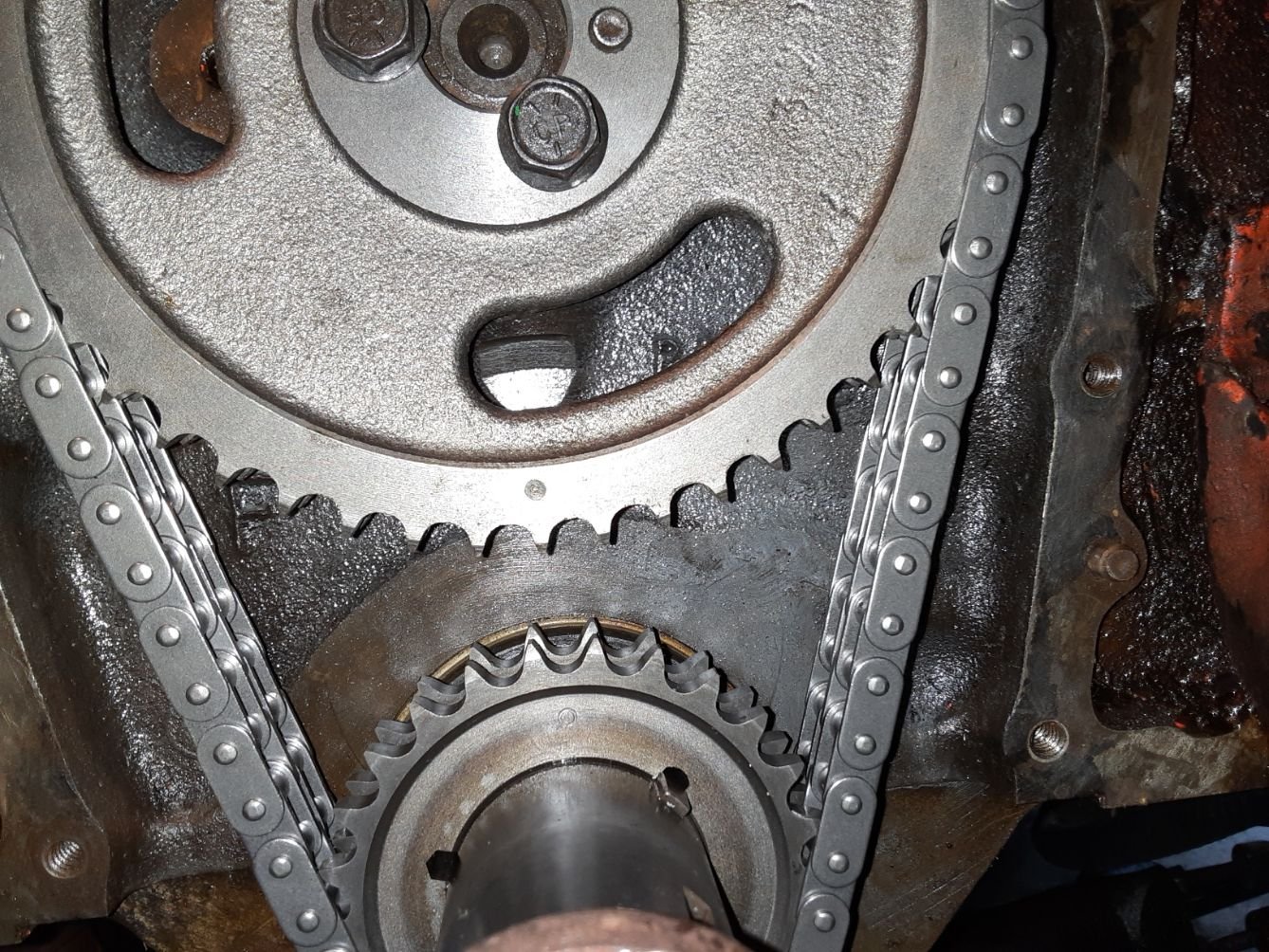

when I look at the Cloyes install instructions for the 3 position set they show the mark at the teeth of the gear not down on the hub of the gear. Is it possible that the gear is on backwards as non of the pics in the instructions show the teeth misaligned between the crank and cam sprockets for a GM engine.
Neal
Neal

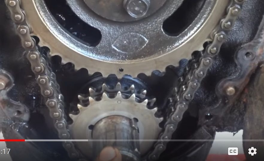

I've always wondered about that, my Cloyes timing set is like the OP's, but I've seen other sets that has the dots on the teeth of both gears.
Mine:
Some that I've seen on the teeth:

71 Green 454; yep conflicting instructions and images on the net compared to the install instructions
Neal
