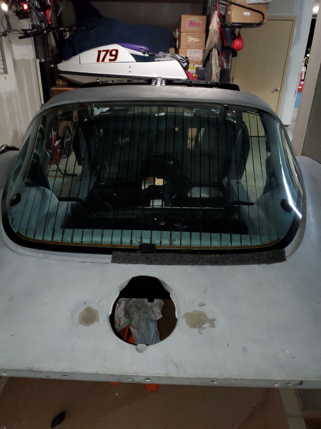

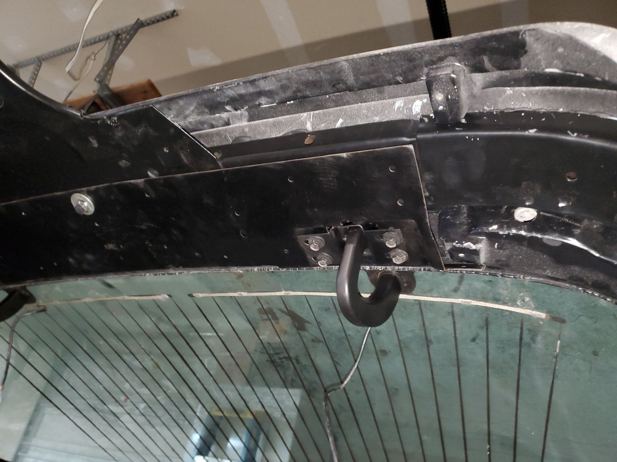

This shows the hatch in place. It's as far as I've got so far. (Edited)

That's cool. Seems like a lot of work. I guess if I come across an '82 CE for short money I'll part it out but I'll put this idea on the back burner for now.
