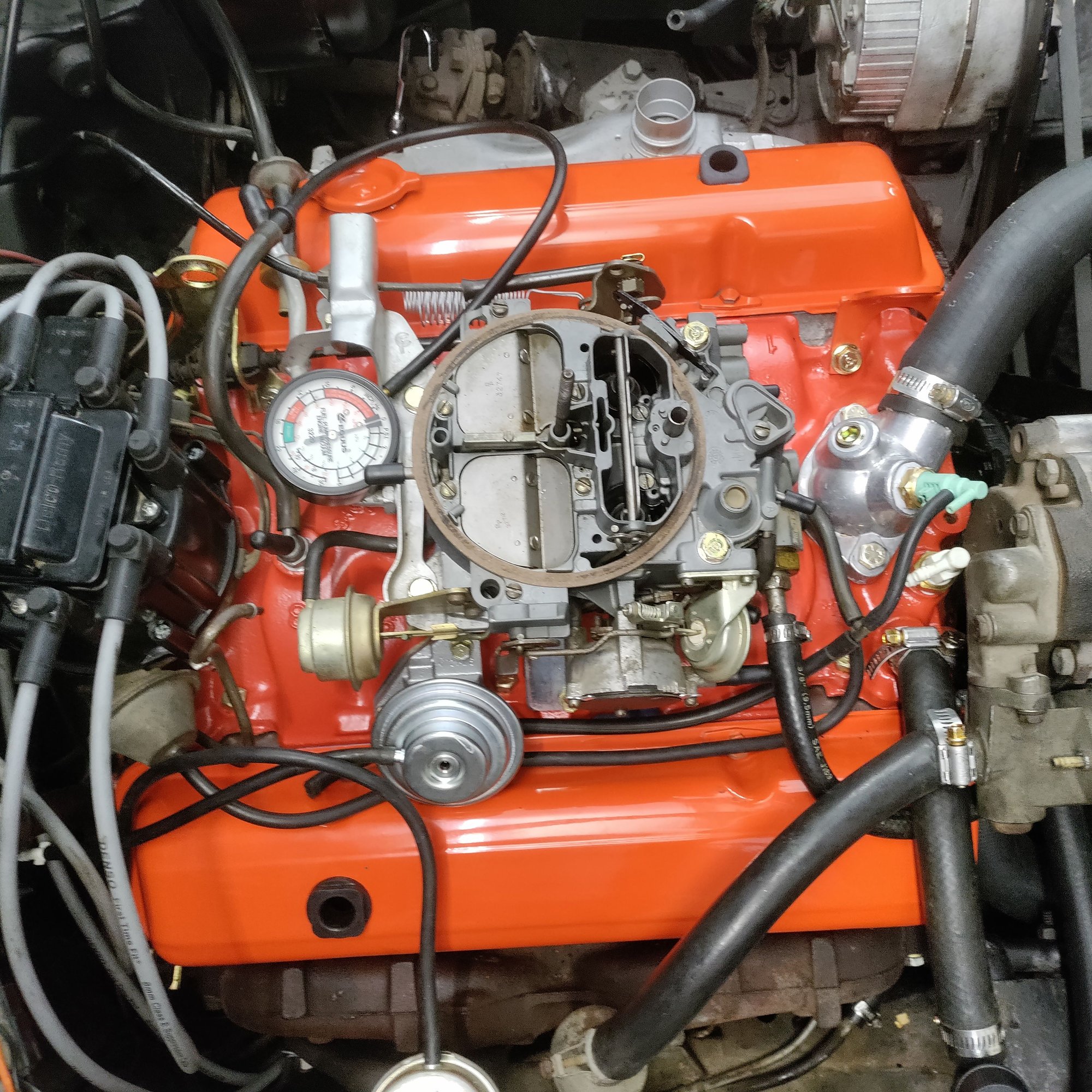

All together and it runs so much better! Definitely hitting on all 8 now and the smoke is starting to clear after a good 30 minutes or so of running. It really needs to stretch its legs and that will happen soon!
Looks like I got the correct red/orange for the intake and the PO went with Orange when he did the valve covers. Oh well! Looks OK to me.
In the picture all vacuum ports are plugged so I can add things back one at a time to make sure the vacuum holds. At a high idle it is around 16-17 inches and peaks up to about 20 when I rev a little.
We're getting there. Thanks again for all the help!

Great work there Socal Dad!
That looks a lot better and that Vacuum reading is great! The engine will "like" being nice and clean and I hope it rewards you with many miles of enjoyment and smiles on the highways!
nice work.
now that I see PO did some work, I feel better about my guess. Rarely does factory fail at intake mani install.
Looks like you have a solid motor.
the cat concerns me.
get it good and hot. I wonder if some water added as it is running will help clean the cat?
