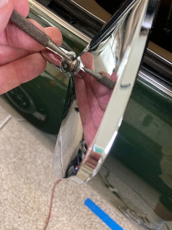

Hey all, Mirror is lose and over 40mph is lowers down. Someone told me work super glue into it but I'm thinking that may be a permanent fix or when adjusted it would just break lose. Any suggestions without having to replace the mirror? Appreciate it!!!

I saw all of the methods of removing the glass and fixing the inside of the mirror, but came up with my own fix which takes about 2 minutes which includes getting tools. Get a sharp center punch and a small tack hammer and then tip the mirror to several of its extreme positions and make a mark with the center punch in several of these positions. Do not hit it hard, you only want to make a small mark on the mounting ball. You do not have to take the mirror assembly off of the door.
I did this several years ago and it is still working fine
