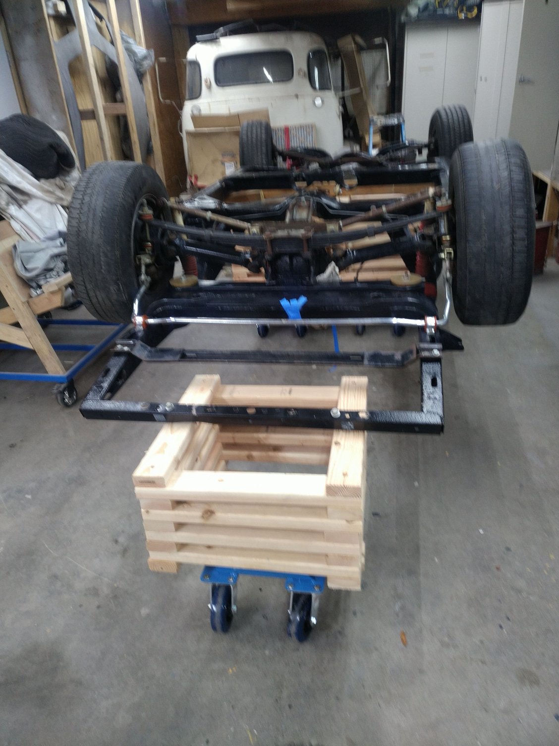

Finally got started on my Chassis rebuild. Good news is somebody has allready been in here before me so every bolt I turn has allready been done before and they come apart. Bad news is every thing was put togeather useing parts from everywhere and very few are original to this car. The Frame has all ready been blasted and painted but it looks as though there wasn't any primer paint used and the gloss paint chips off pretty easy.

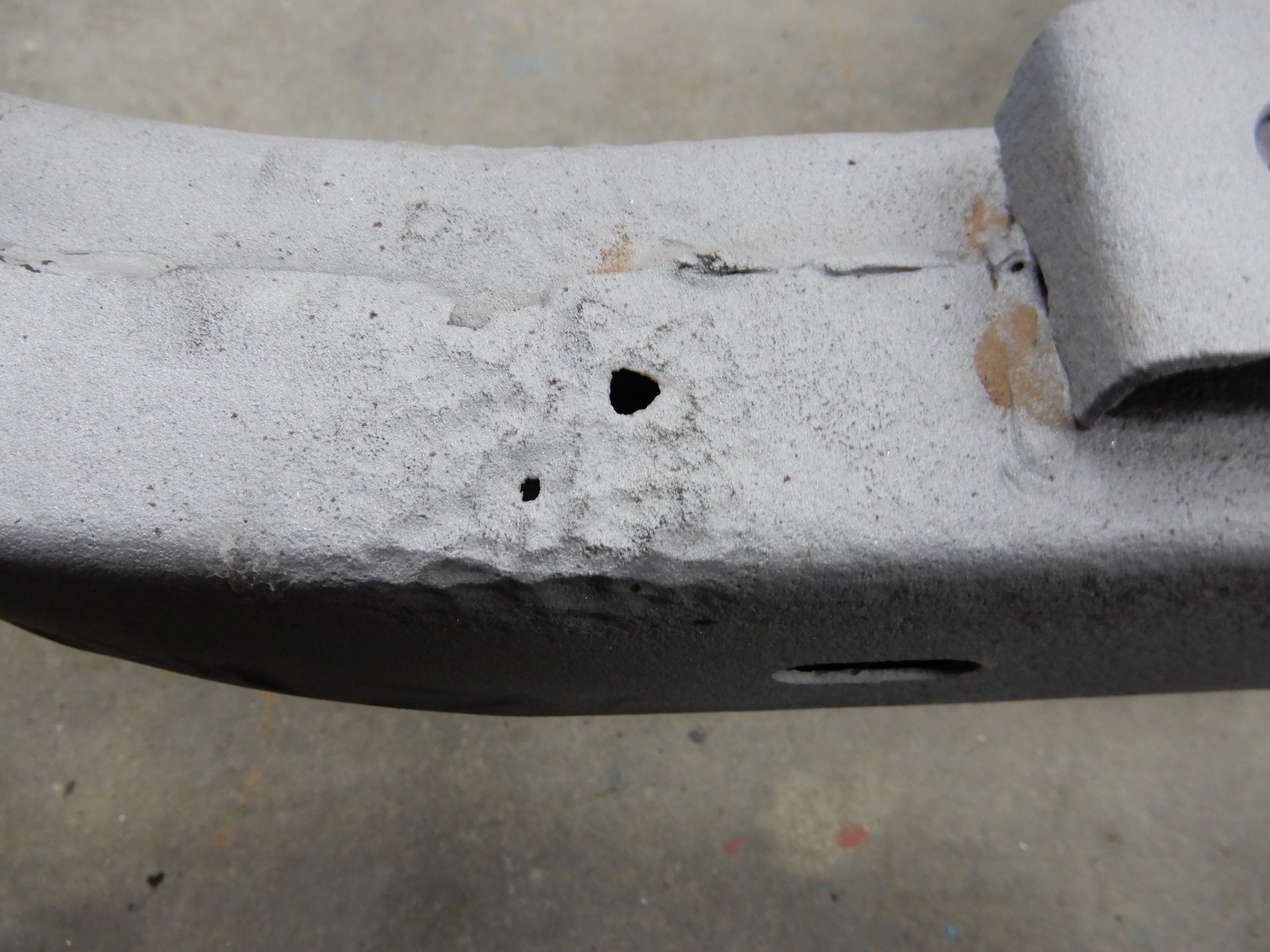

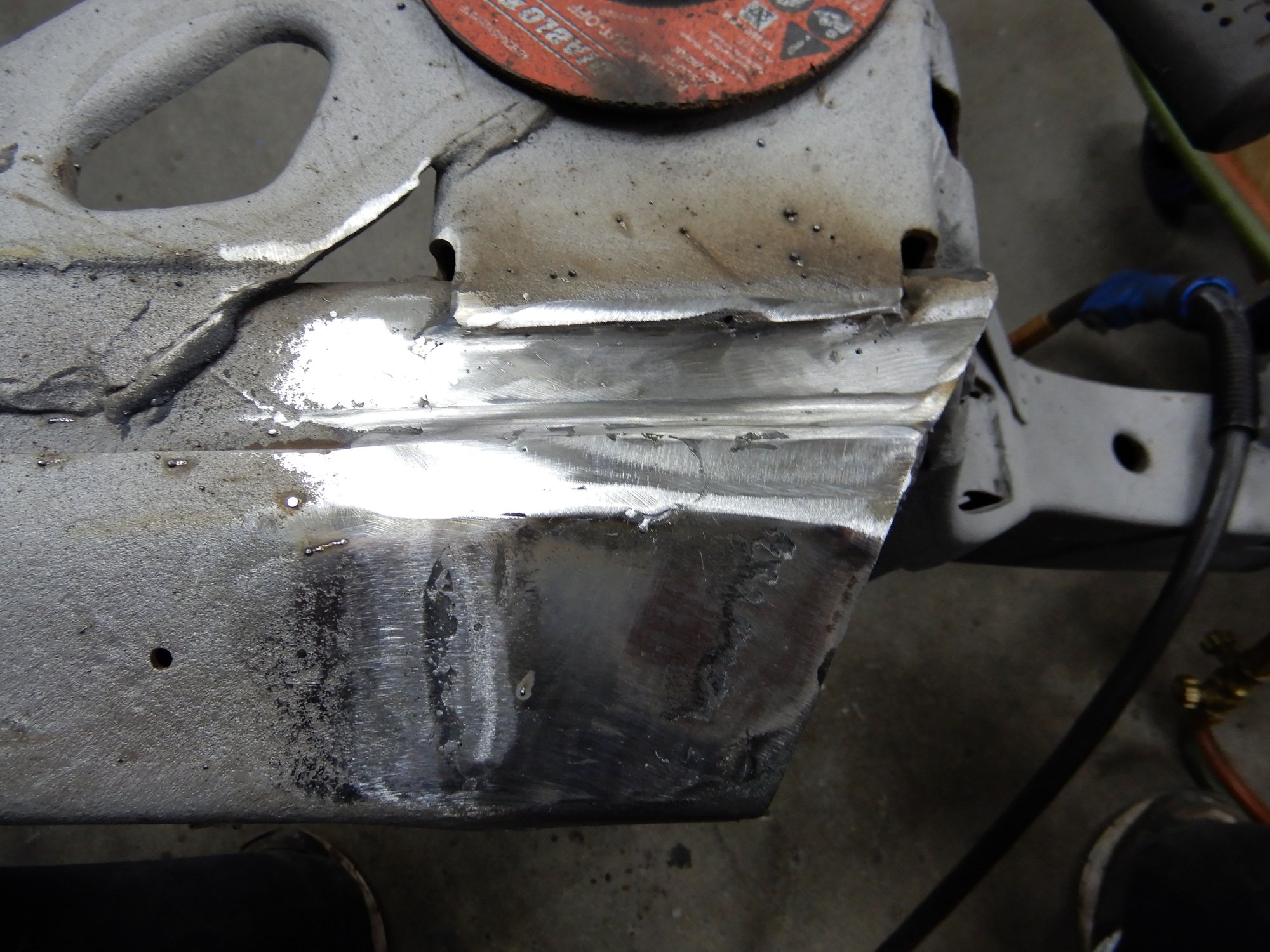

Front crossmember has the usual damage
As I work in the Marine industry I'm used to doing things the way a Shipyard would. Buy driving wedges under the U shaped Steel that has been tack welded to the low spot I can pull it out. I was surprised how much force it took to get the metal moving.
Using a Rosebud on the Torch makes it easyer to control where the metal moves.
Things are starting to look a bit better. Still needs some more TLC.

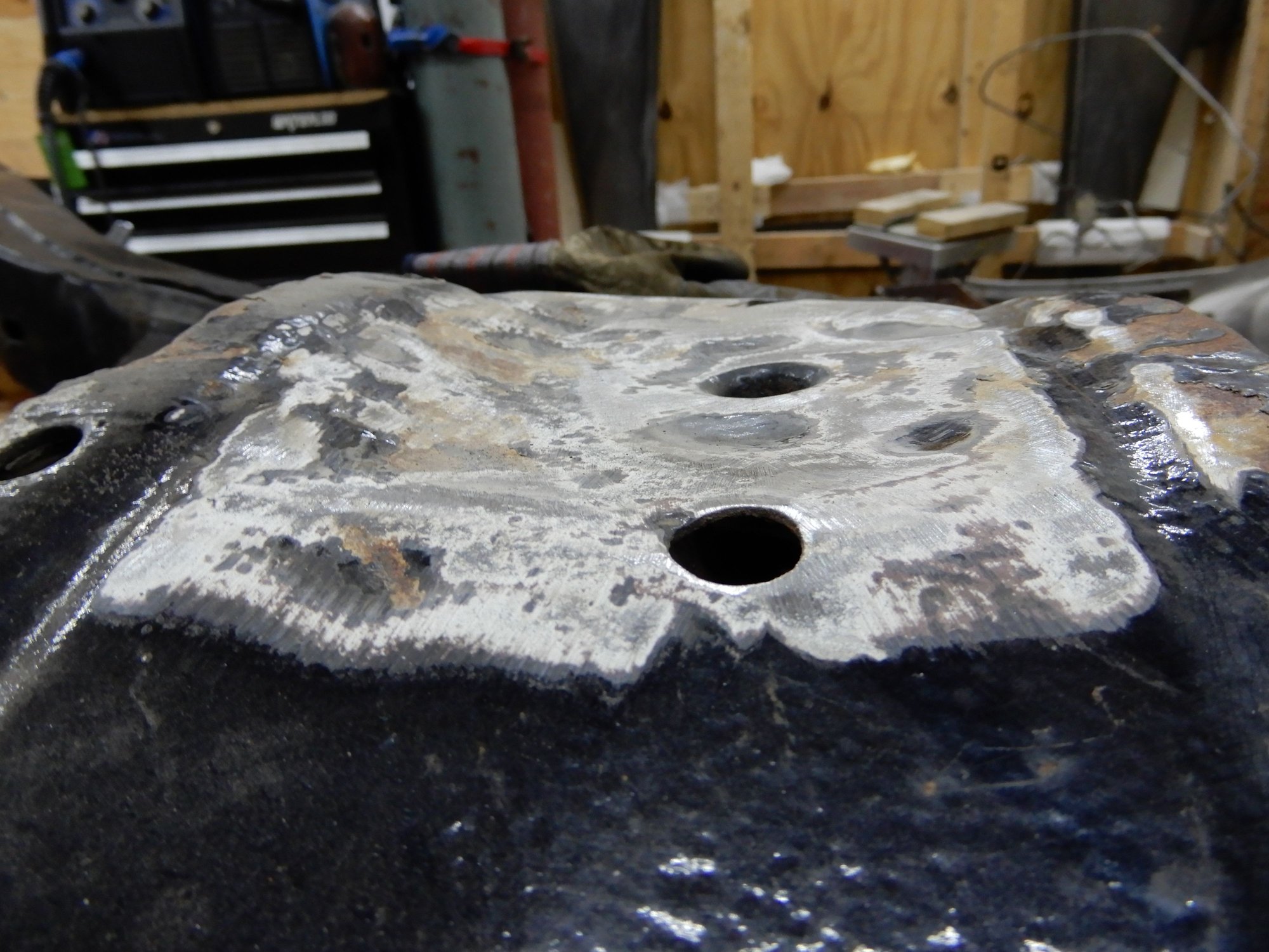

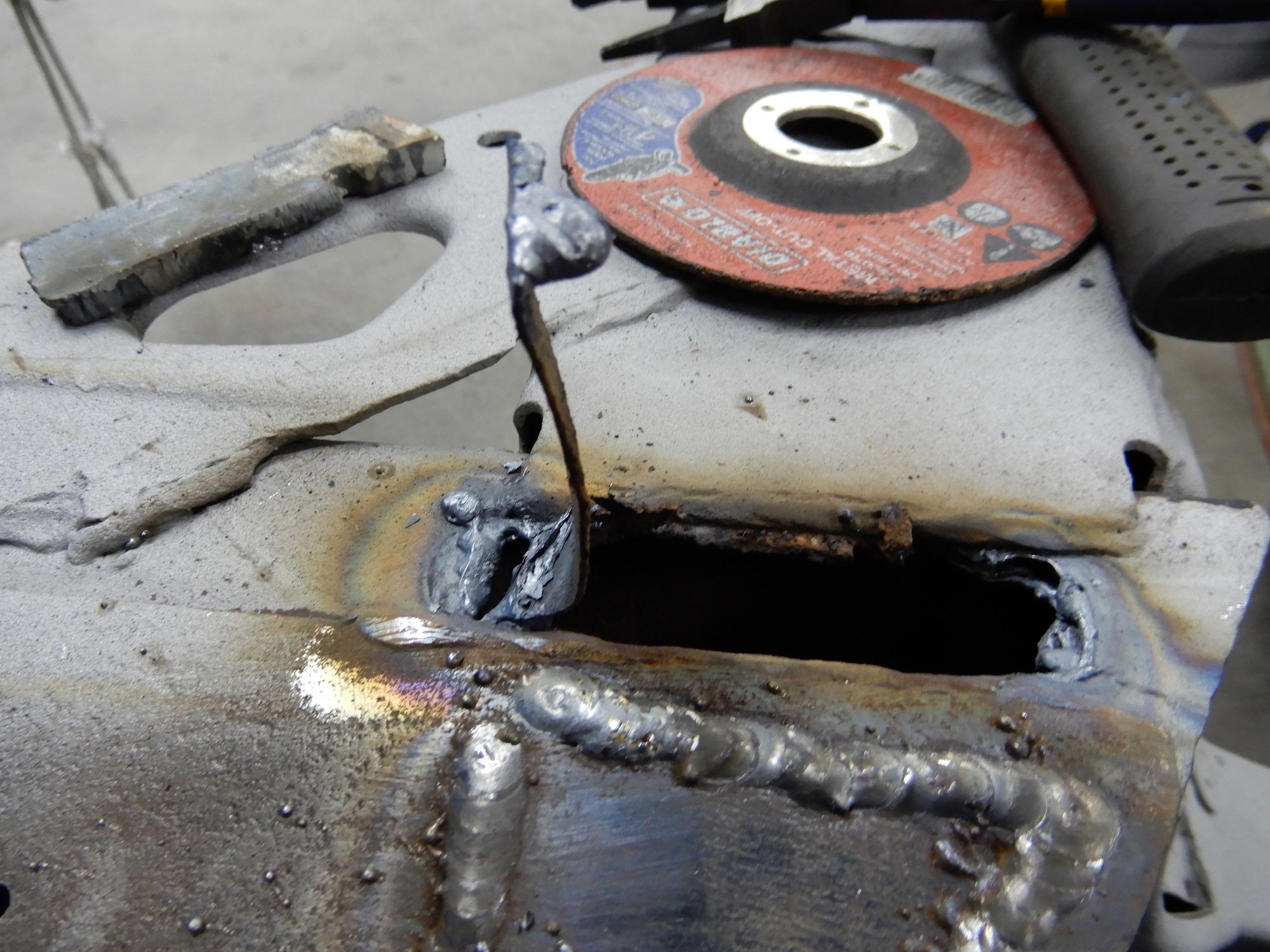

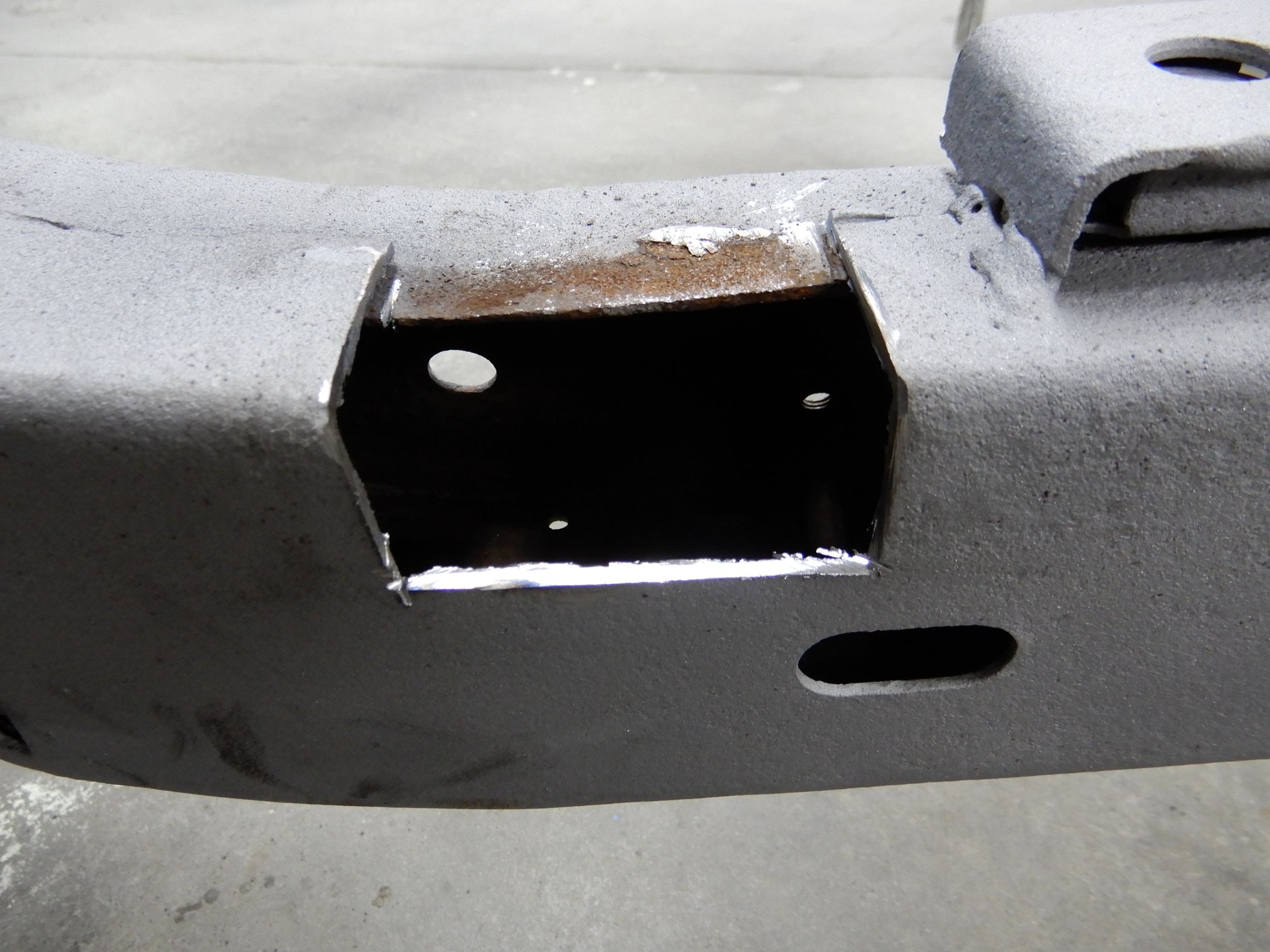

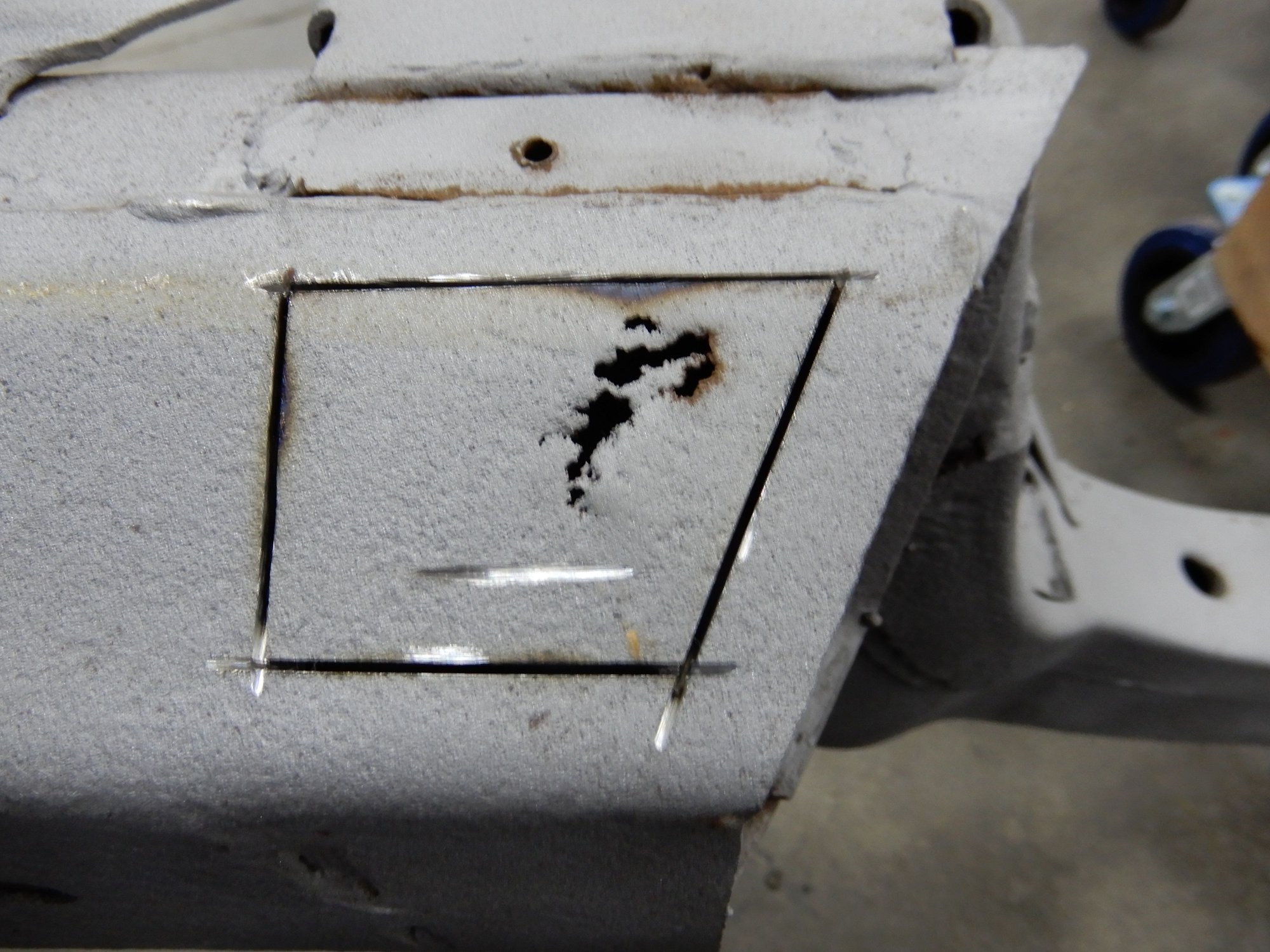

Got the frame back from blasting and spent some more time on the front crossmember.
Wile rolling over the frame to get the sand out I noticed it was coming out of a hole thats not supposed to be there.
Wasn't to bad. Looks like good metal now
This should work.

The Mouse Nest survived the Blast Shop ! No more mouse though.
And here I thought I was going to have the only Frame with no Rust at the Kick Ups. If you look above my cutout where the round hole is that is where somebody before me has patched a hole. Its gas Welded on either end but not welded along the sides ?
First Patch
Yikes, its just a piece of sheet metal, no wonder they didn't weld it in all the way.
Another Patch.
Thats enough for tonight. I see that the other side has had some rust holes Brazed back together. As if one guy was gas welding one side and another gas brazing the other. Will dive into it in the morning.

I was wondering if anybody would pick up on the 5 window. Its actually a 1954 GMC COE 450. The 450's are much harder to find and more sought after because they have wider front Fenders. I have a 06 Kodiak Duramax that got in the way of a falling Tree that I'm planning on using for it. Its planed to be a Corvette Hauler.

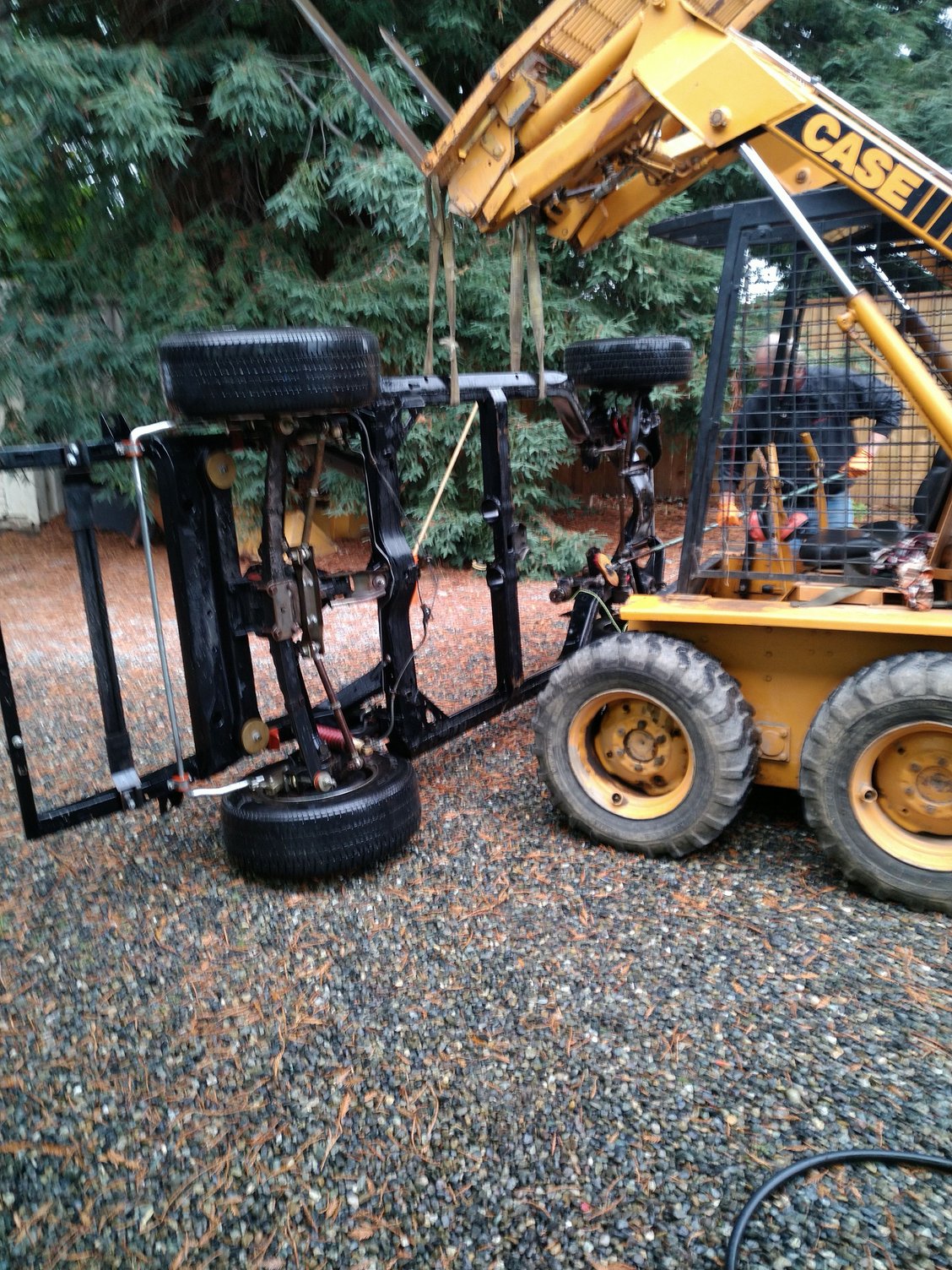

The very first pic it thought...."oh here we go, its upside down already!!!!" I was wondering how you would get it on its wheels again
