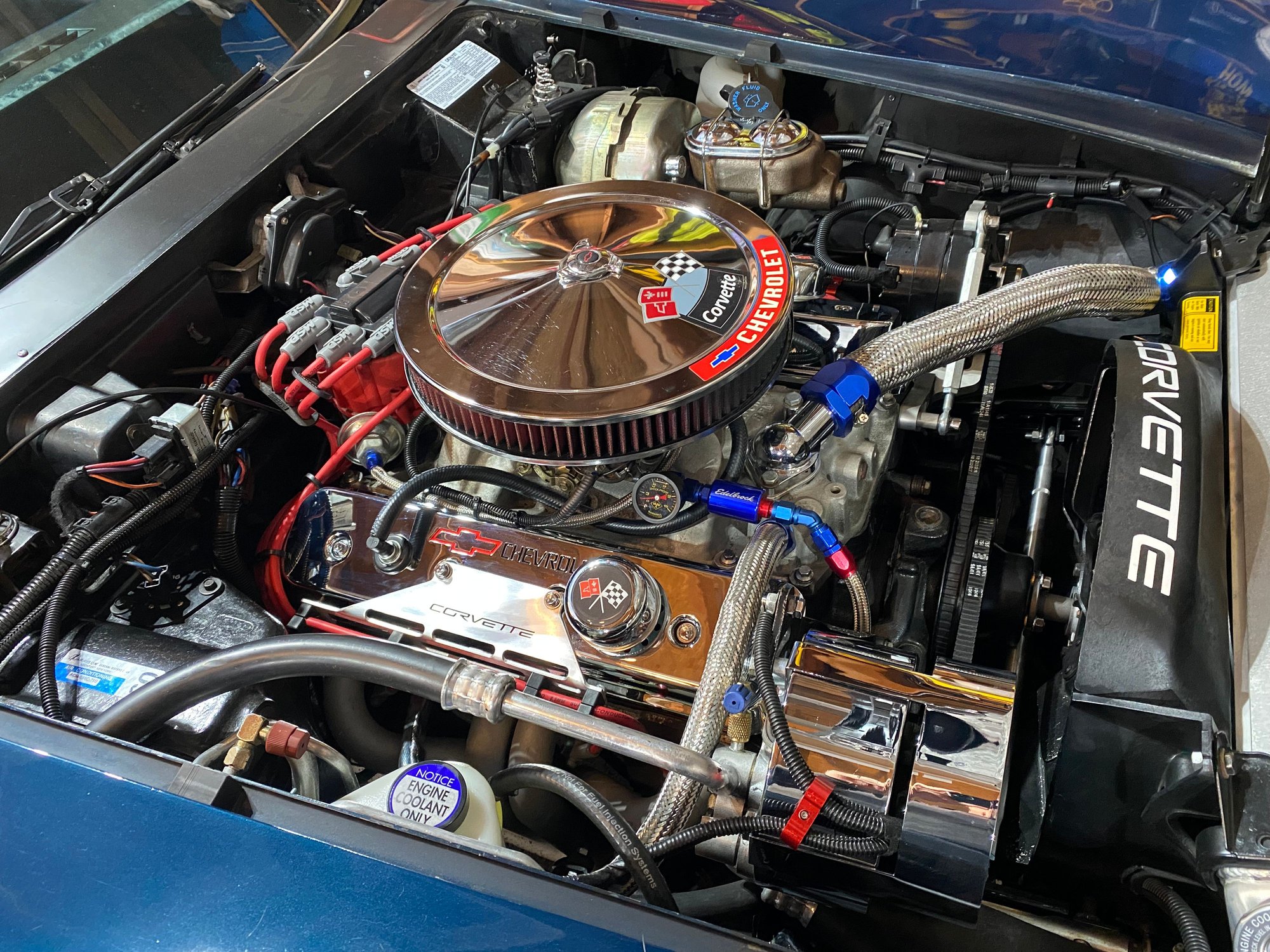

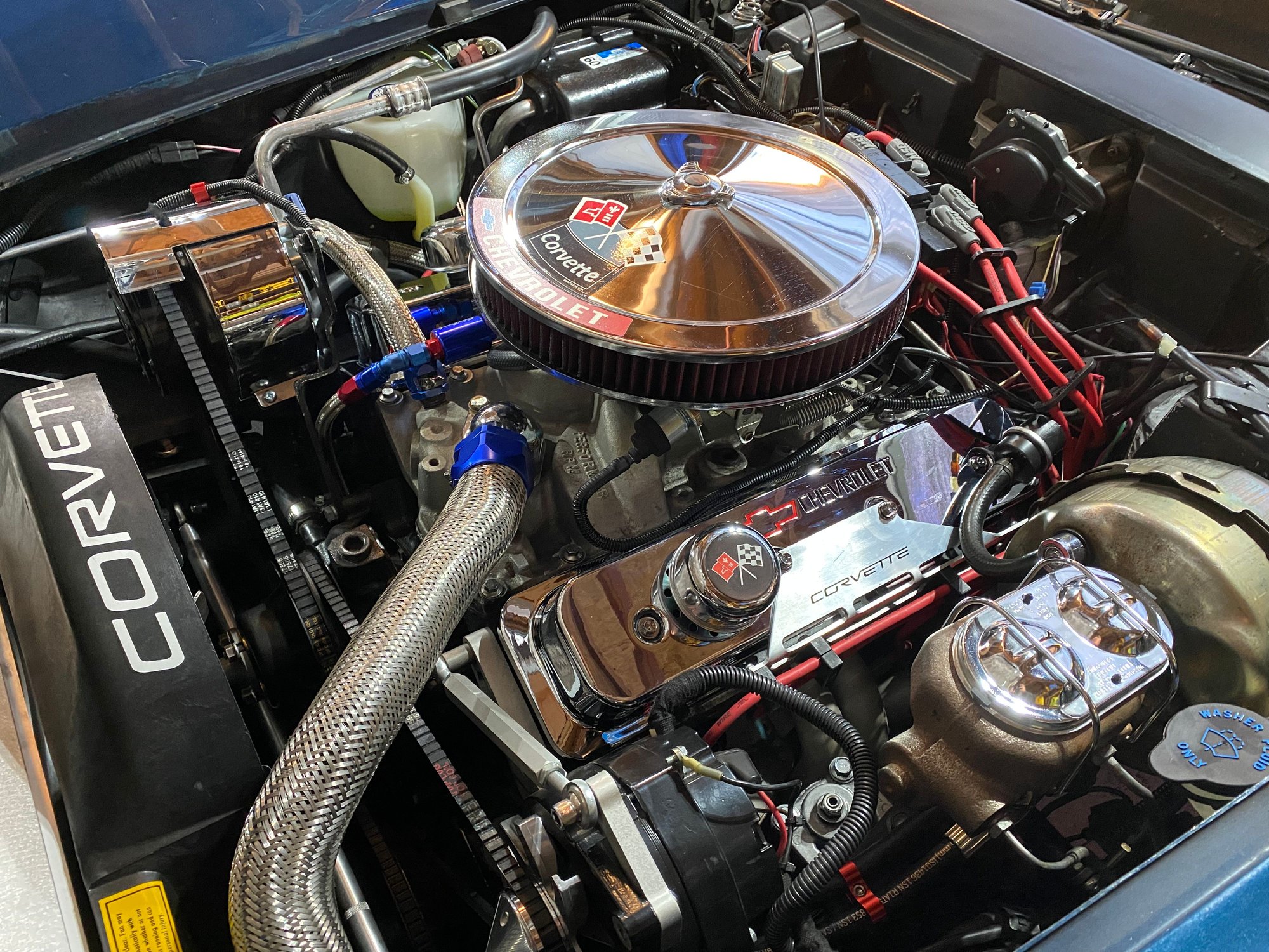

Hi, just curious if two breathers are necessary. Passenger side has a PCV valve and breather, driver side has breather. I was going to put in a push in oil fill cap on the passenger side instead.

At first I thought I saw a spec of dust on the engine. Then realized it was on my lap-top monitor.
Love those breathers. That's a class act right there.
What you could do because the twin breathers match so nice is, block off the passenger unit. It would just be for looks only. Fake.
Maybe some type of plastic plug inserted into the breather tube. Or even caulk the breather closed. The PCV will still work fine, even better.
I think Moroso has the rubber grommets that fit into the valve cover ports, 1 1/4". However, with theirs, I believe they came closed off and you had to slit open the grommet bottom for what ever air flow you needed. You want zero flow.
Not a big fan of those oil fill plugs. Most are just a boring rubber stopper that usually leak vapors.
Lots of people get the PCV system wrong. I have seen two PCV valves, no inlet.
Think, cross ventilation. Fresh air goes in one side. Gets sucked out the other side.

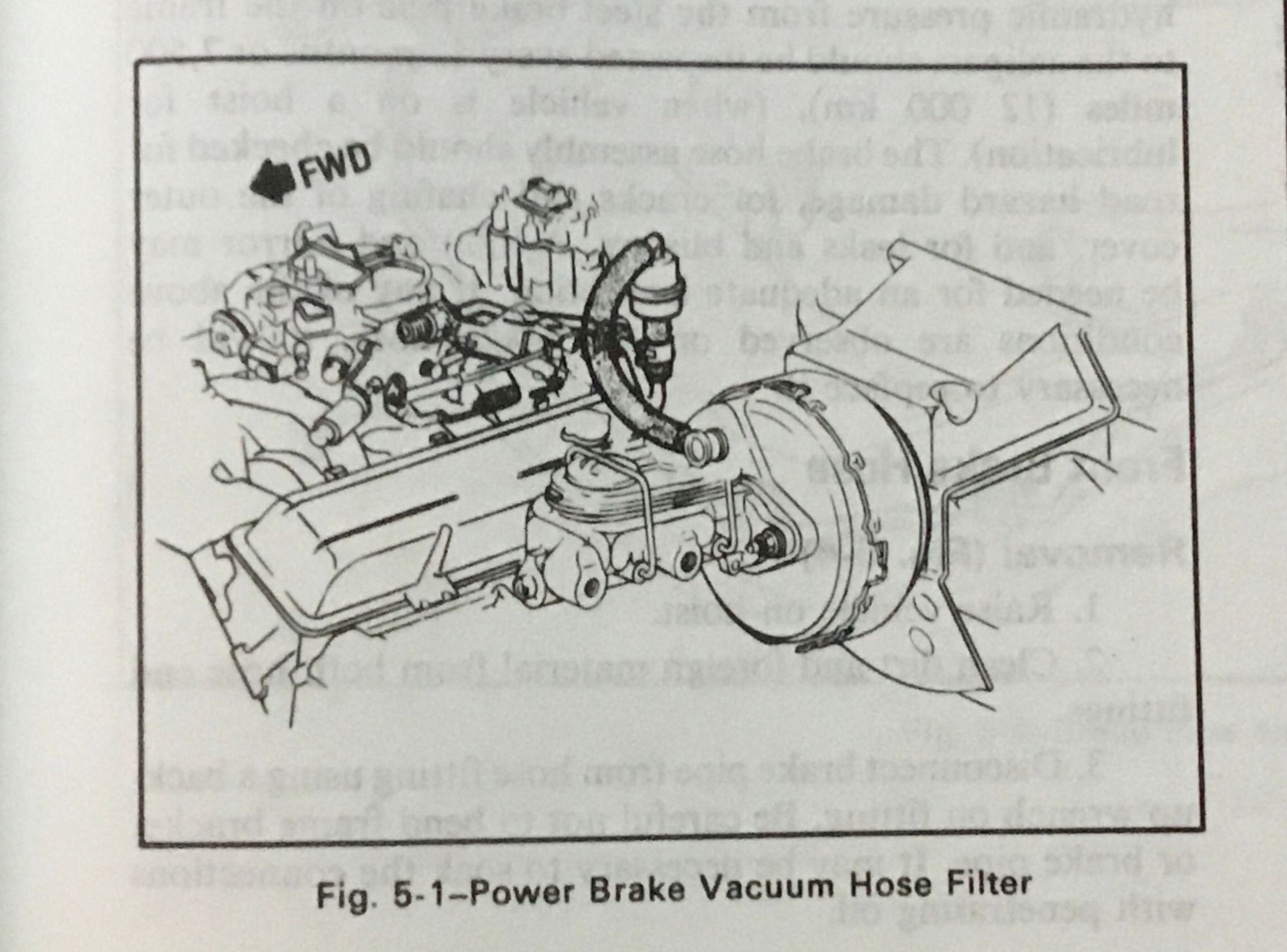

Nice engine! The power brake filter (carbon canister for fuel vapor) needs to be mounted vertical for proper function.
Fuel vapor condenses in the filter and drips back down toward the manifold.
