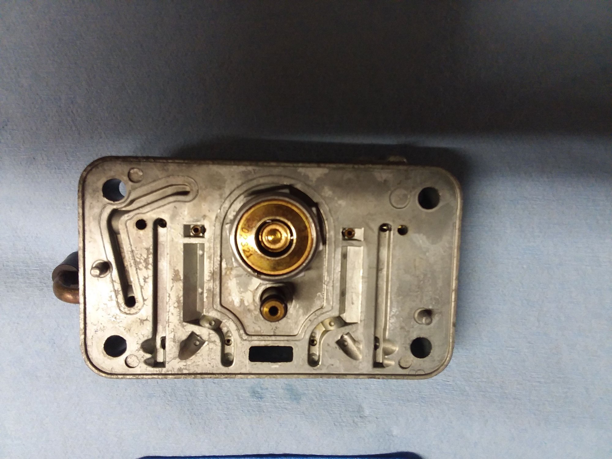

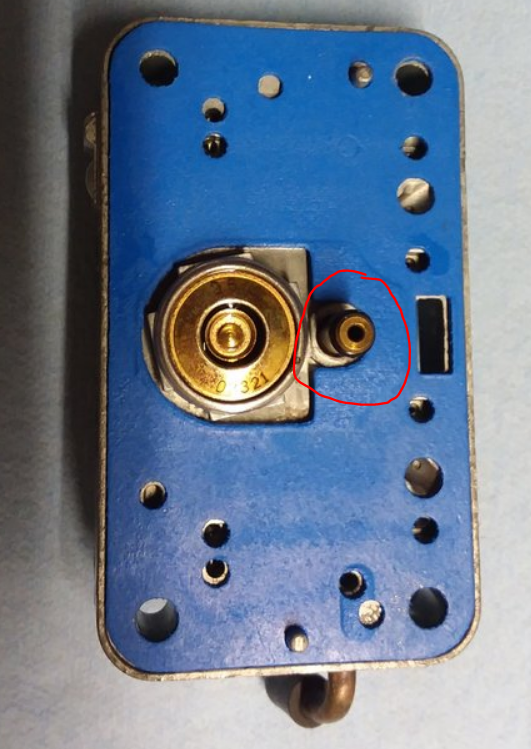

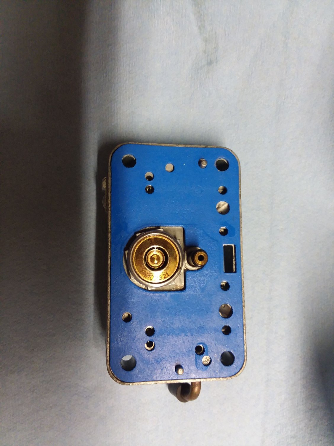

I think you have the wrong primary metering plate gasket installed. You need to pull it apart and post a pic of the gasket, main body and metering block with the gasket on it.

Old Oct 25, 2021 | 02:21 PM
Jebbysan's Avatar
Jebbysan
Dr. Detroit
Joined: Mar 2012
Posts: 10,097
Likes: 4,027
From: New Braunfels Texas
It has the right gasket....and it is sealing. The only other thing it can be is the red circled accel pump transfer tube o-ring......and this would have to be combined with a VERY high float level for it to "siphon" out of the squirter. It would also leak into the cavity behind the power valve and soak the baseplate gasket.
