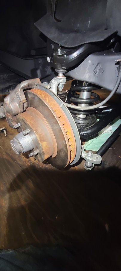

I'm just starting to put the front end together. Lots of delays the last couple of years.
Right now I have both upper and lower control arms fitted with the Ridetech delrin bushings and offset cross arms for the uppers.
My question is this: which way should the cross arms face to improve handling in straight runs? Should I mount the upper control arm so that the offset pushes the top of the tire away from the car? This should add degrees of camber, but I don't see how it really effects caster if they're both offset equally.
Isn't the goal to increase caster?

Isn't the offset from the new holes, or slots, in the arm "bar", that in turn moves the upper ball joint aft, and increases positive caster?
Do you still have the old pieces to compare?
This is why I use SPC adjustable A-arms instead.

They look very similar but each side is set back a bit compared to the stock ones.
There you go! That's the offset. There is no adjustment in the LCA, so moving the upper ball joint aft via the UCA is how you get more positive caster. I have about 6 degrees dialed in with my SPC UCAs.

I still don't get it. The offset is the same on each side of the cross arm. This makes the top of the wheel move closer or further away from the chassis depending on the orientation, but in equal amounts. It doesn't seem to move it rearward, only inward or outward.
Is there something built into the chassis that causes this to move caster? Right now it only looks like an increased or decreased camber.

Instead of describing what you see, feel free to post photos!
The offset UCAs, like these, allow you to add extra camber if your front suspension has sagged. You can then add extra caster with shims.

I believe the slotted cross piece allows you to move the upper control arm backwards, thereby increasing the caster. It does this without also changing the camber the way shims do.
I'm not sure where you are in the process at this point, but I was headed the same route you are, and found that when I went to install the new bushings the control arms themselves were bent. Probably from a previous owner beating on him to get a new set of bushings in. I ended up replacing both upper and lowers using Global West lowers and SPC adjustable uppers.

I think i see my problem. My cross arms are not slotted. The ends are offset a bit on each side as compared to the stock ones. The result is i can move the top A-arm in and out (camber), not front to back (caster) on the A-arms.

To add caster with the stock setup, you cannot move the arms front/rear.
You subtract shims from the front and add them to the rear stud. This moves the ball joint rearward.
2-3*post caster is about max for a stock setup, then you run out of rear stud.
With 1/4" slots in the shaft as well, you can make it to 5-6* caster before you run out of rear stud.
At this point, your ball joint will be about 1/2" rearward vs neutral.
-0.5 Neg Camber and +5* Pos Caster. More shims in back until ran out of stud, and also shifted slotted shaft 1/4" rearward.
