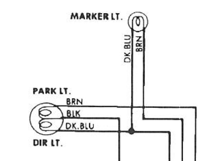

Here's the modified wiring diagram I used in the corners. More details are in the related LED thread. Clear front lights would make this even better, so I'll have to convert my 79, too.

The GM terminology for the front-facing corner lights is both "direction signal" and "parking light", and from 1963 to 1967, that is all C2s had. They use two-element 1157 bulbs, and can be directly replaced with white/amber switchbacks. Thanks for confirming that!
In 1968, GM added the front, side-facing "marker lights", which operated with the parking lights only (and had a ground). Looking at the wiring diagrams, 68 through 71 C3s should also work right out of the gate with white/amber switchbacks.
Starting in 1972 (again, based on wiring diagrams I found online, YMMV), GM removed the ground for the marker lights. From 72-82, they shared the circuit with both the parking and direction lights, such that current flows in different directions through the marker light bulb at different times, and at some times no current flows, allowing the marker lights to flash with the turn signals.
In a 72-82 car, LED marker lights should break all of this, but you can get DRLs and front-only turn signals using white/amber switchbacks in these C3s if you remove the front marker lights (the rear marker lights work differently).
To get the full functionality shown in the video in a C3, you will need a pair of the Blinker Genies, (and LED flashers). The marker lights will then flash opposite to the front turn signals, but that seems fine. With a few extra diodes and extra wire, you could get the marker lights to flash with the turn signals, and to be off when the DRLs are on, but I wanted to solve the problem without adding more than a few inches of extra wiring, which I did.
Here's the important part of the 79's wiring diagram that shows the issue (trace out the wires in the full diagram to better understand). @Richard454 explains it best of all in this thread:
https://www.corvetteforum.com/forums...rn-signal.html
