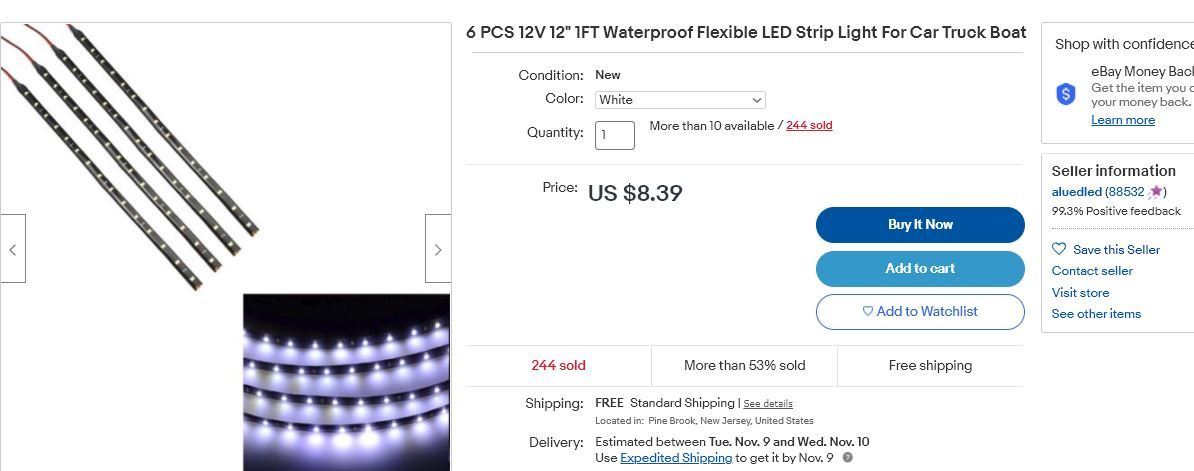

You can try one of these from ebay. But really, I didn't know they had jacked the prices up to that ridiculous level..... when I do mine I'll look at the local parts store but more than likely I'd rather pay for a 12 VDC LED strip and it would still be less than that ridiculous socket price.
