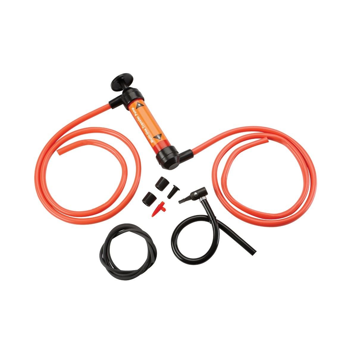

What is everyone’s tool of choice to suck the old differential fluid out, so I do t have to take off the entire case? Is there one at harbor freight that will get the job done?

yes, the HF suction seems to do well for me (still working for PS fluid etc..)..i put a coat hanger to guide hose to get near the bottom best i could..
drive it around to warm up prior..don't forget whale oil
https://www.corvetteforum.com/forums...ial-fluid.html
https://www.harborfreight.com/multi-...oaAjerEALw_wcB

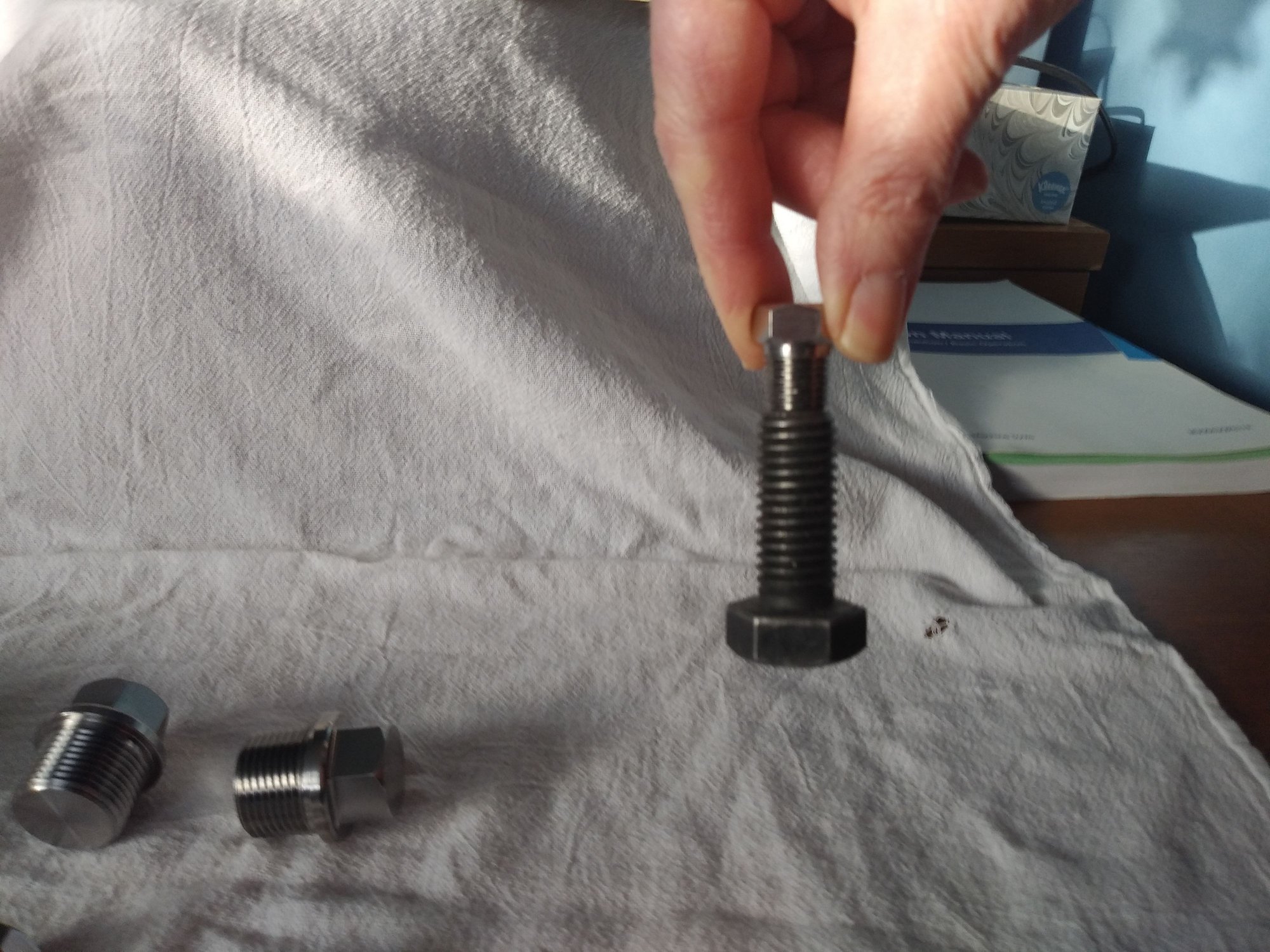

Another option is to add a drain plug...
https://www.corvetteforum.com/forums...rain-plug.html

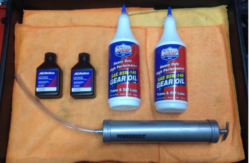

Probably just needs a fluid change but be sure to add the:
Amazon Amazon
The rear can raise some hell w/o it.

The two bottles of additive should help the posi chatter. After you’ve changed out the fluid, find a large parking lot and do a series of slow, tight figure eights to ensure the posi clutch plates move relative to each other and pick up the fresh fluid.

Drill and tap housing for a good quality magnetic drain plug. Problem solved for good with parts like these.
