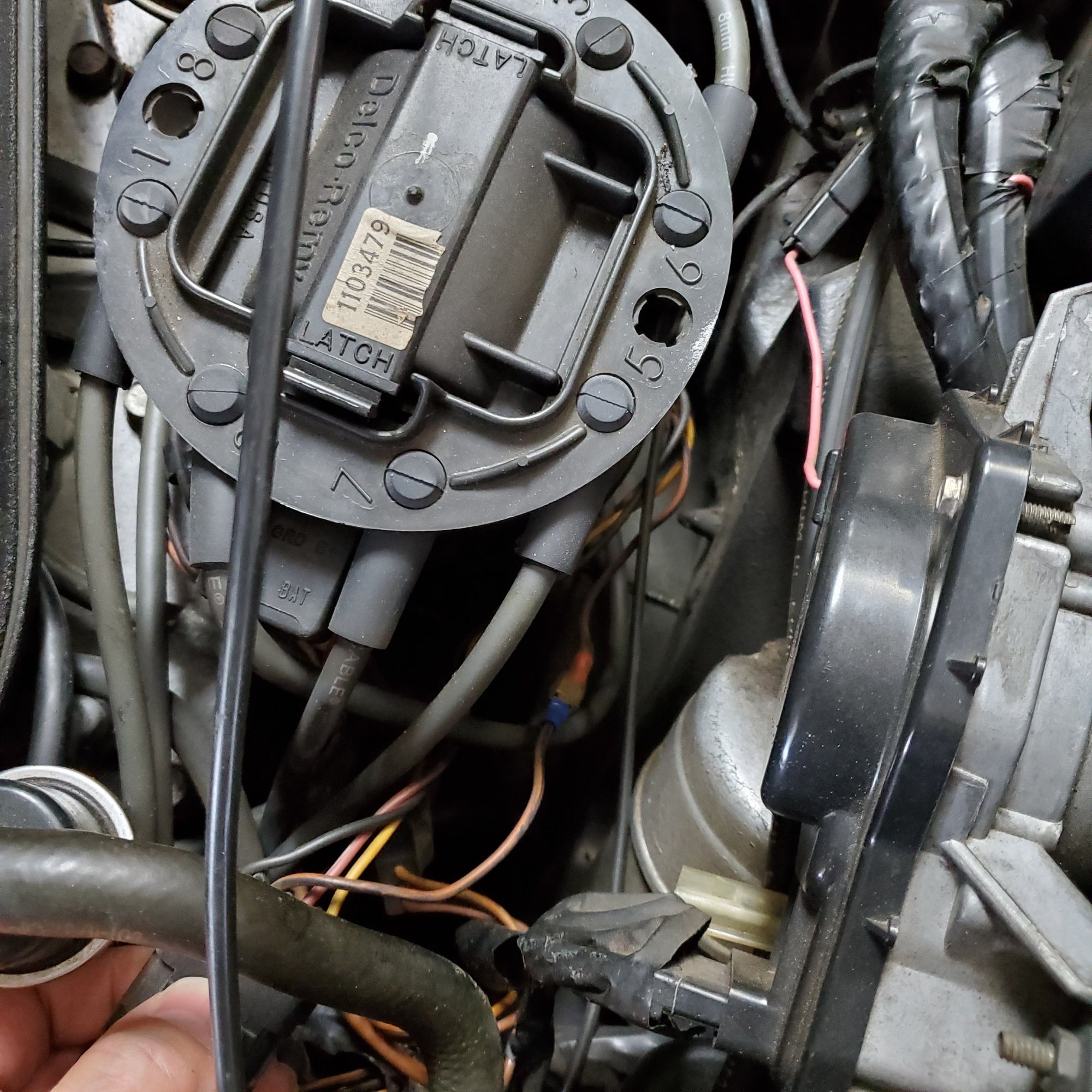

Suspect a knock sensor, poor gas quality and/or a firing issue. Start with the simple stuff - add some gas treatment and high octane fuel. Then I'd pull the plugs and look for signs of unburned fuel or low spark (bad wire). Agree with others on timing advance. Check to ensure the wire (brown in color - see picture below - the one with a quick disconnect) is connected. Has to do with spark advance.

Start with checking base timing with the single wire connector un-connected near the distributor , this puts it in base timing , plug the connector back in when done , if timing is good then the EGR tube needs checked for blockage , you will need a scan tool more than likely to determine if knock sensor works or not but those two things can be checked easily with out scan tool
