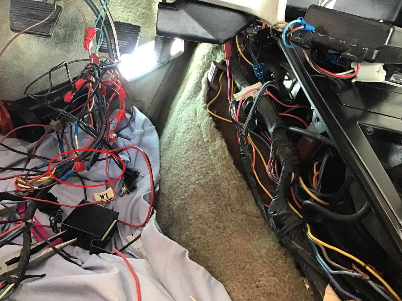

I just got an 82 vette that has a thug bug alarm. Keypad to start. Anyone know where I can get a diagram so I can remove it?

I had luck and only 2 pinched tapped wires from oem harness….

There are no words to accurately describe my woe and depression after seeing this.......
Many other ways to secure an automobile without that terrible pile of ****......
For Instance, a switchable 30a relay for the 12v PWR connection at the HEI. Simple and effective.....

Do you get paid by the splice or something?

If I saw a pile of wiring like that I would not buy the Corvette. That car is "Bubbafied" and undoing the damage to the wiring system might take a pro to figure it all out.

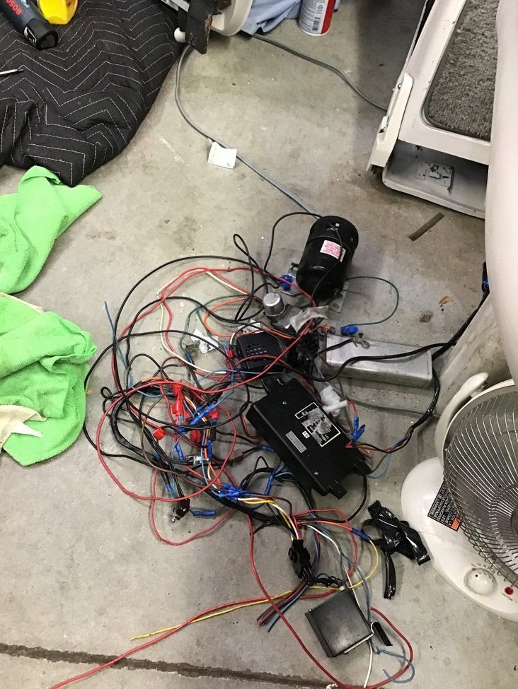

I was able to remove the thug bug. Once I found the brain (tucked inside fender) i was able to trace the wiring. As I expected it tapped into the tach wire on the HEI distributor. Turns out it was not as difficult as I thought.
