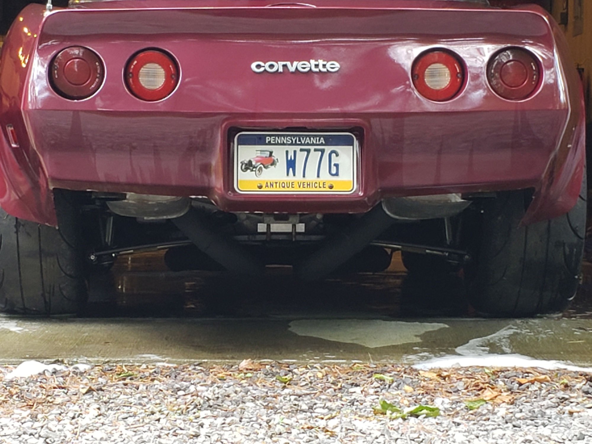

I have 15x10 with an effective backset of 5 inches. Tires are MT 295 55 15 drag radials,....They do not rub, but stick out about an inch past the fender. Some might not like that. I tried to pull the tire in more, but the tire hits the frame at the T-arm pocket.
If you want it all under the fender I think you can run 9 inch wide and 4 1/2 inch backset wheels,....tires maybe 275 60, or 255 60.

I had already replaced the spring with a custom length 440 lb fiberglass spring and offset the spring bolts, so that clearance issue was out of the way. A local shop quoted me $1000 to cut and weld the frame for clearance. In my mind I would only gain 1/2 inch max tire relocation inboard, and the tires would still poke out 1/2 inch. Not worth it to me, and the fact I'd be cutting the frame in the worst possible location. I have 500 plus horse power, and to weaken the frame there was not an option I was willing to consider.
