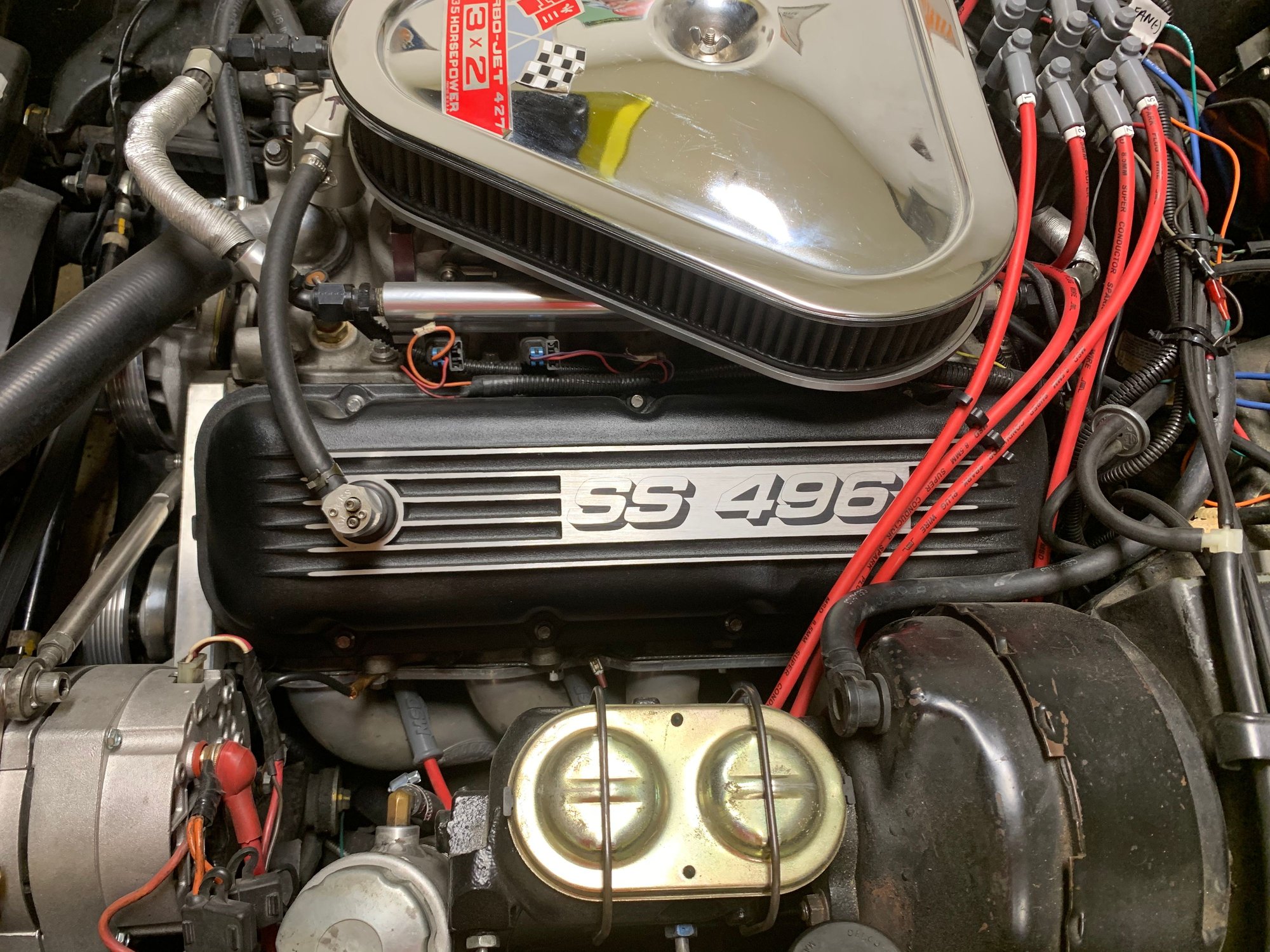

I'd like a smaller diameter booster as well, it is very tight in there even with a small block.

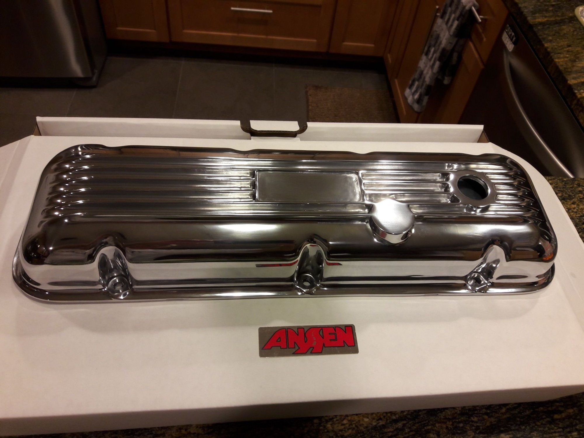

If you keep the stock diameter brake booster there are several tall style valve covers that will fit with the oem diameter booster.
I purchased a set of Teague Custom Marine tall valve covers that are designed to fit with an overhead marine exhaust system for a big block Chevy.
I also purchased a set of new Ansen's for a big block.
Both have clearance for the oem diameter booster and give clearance for roller rockers.

Those are nice, but regardless it is tight in there. I am going to look into the C4 swap. I even considered swapping over to manual brakes to make it easier to get to the spark plugs. I am ditching the factory A/C and going with Vintage Air for that very reason.
