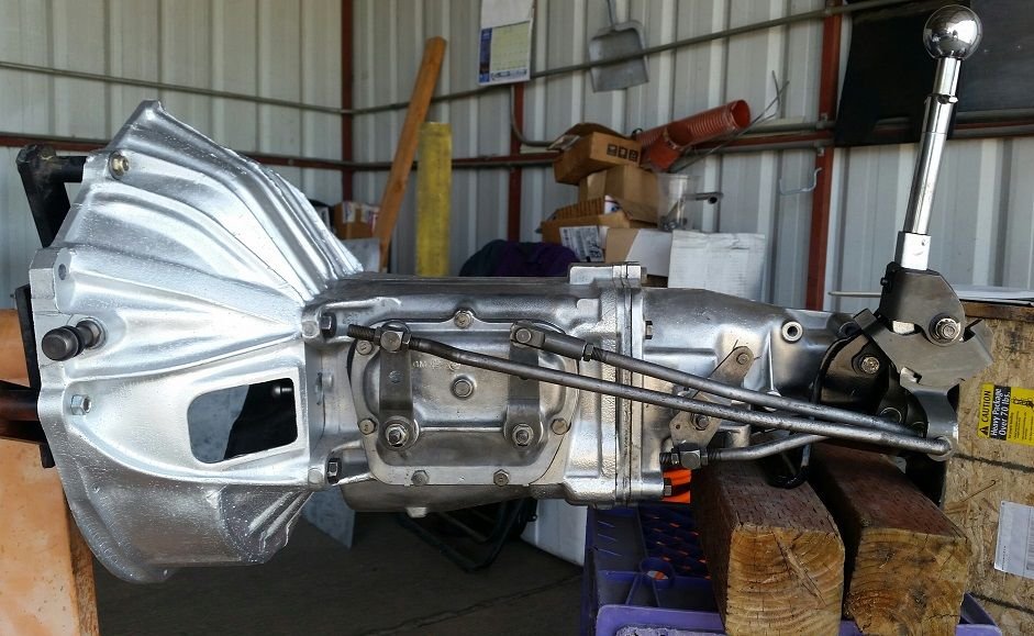

Originally Posted by interpon
Postsome pics of your tranny!
Don't really have many.
Short Throw setup.
Purchased as a set.
Steve
