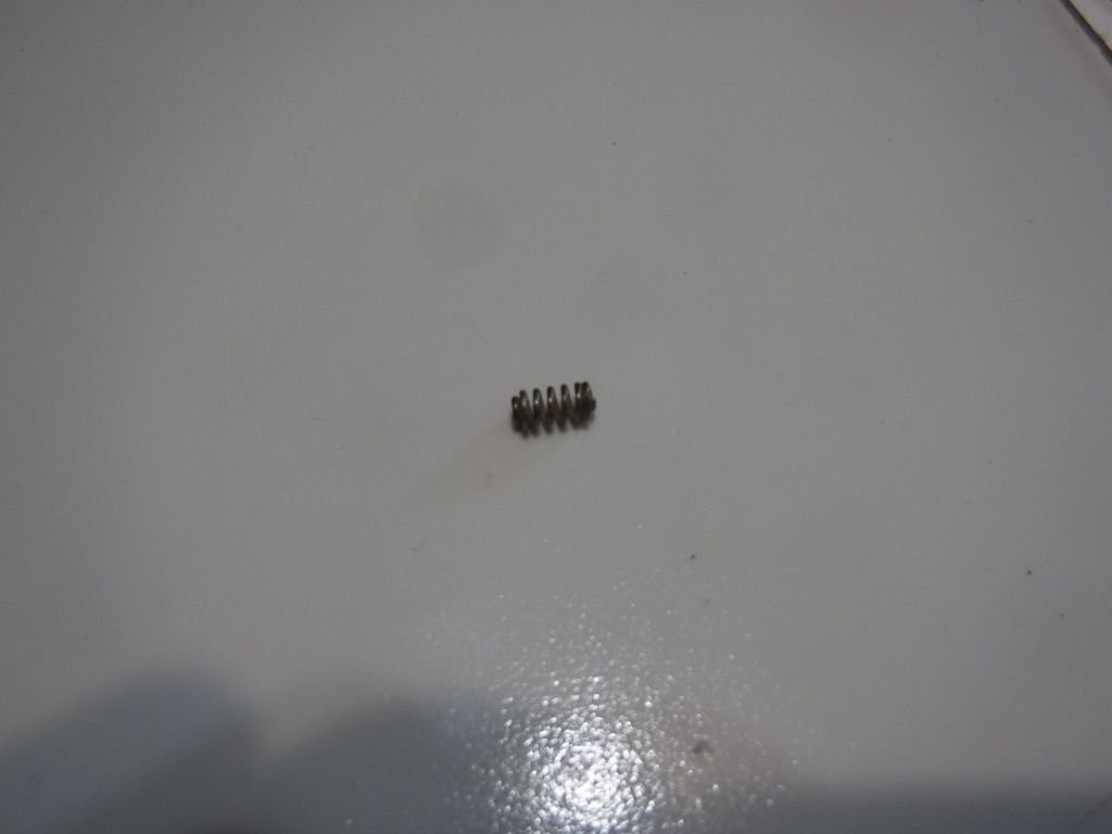

Seasons Greetings... I have two questions:
I have rebuilt my L-36 motor and am now trying to get it started to break in the new rings and cam. I have set the timing at 10º BTDC as verified by timing light upon cranking. Newly rebuilt damper and verified mark correct with true TDC. Valves all adjusted half a turn down on the base circles. Spark plug wiring triple checked and getting orange spark (not HEI) from coil cable. Oil pressure at 35 psi upon cranking and coil wire unconnected and fuel (which may be my culprit) is cranking out into jar. Carb pump is squirting so fuel made it into carb. Quadrajet Carb was emptied two years ago when I first began the project and was basically new then (triple gasket per Lars posting). I found this spring under the car and cannot for the life of me figure out what it is from. It was not there all the other times I was underneath when getting motor all connected up. See photos below
Upon cranking to finally try to light it up, It backfired (no flame) through carb and sounded like a gun shot ringing my ears. My daughter filmed this and swears she saw something shoot out the carb. I looked but could find nothing out of order upon visual inspection. (I had already discovered the spring before this.)
The gallon or so of gas in the newer tank is two years old but it looked and smelled fine, so I added 2 and a half gallons of fresh gas to the tank before any cranking occurred. Several attempts to start the engine resulted in backfires through the carb and absolutely no detectible combustion, not even a cough or sputter. Before the rebuild, all plugs fired fine so I know the cap and rotor was working and they just stayed on the distributor in a plastic bag the entire time.
My two questions are...
What the heck is this spring? And, would my next move be to check compression or remove top of carb to inspect, or something else I may be missing? As always, thanks for any input!
roughly 1/4" by 1/8"

It looks like some sort of ball detent spring.

Sounds like perhaps the timing is 180* out of phase. Make sure #1 is TDC on the compression stroke and that the rotor is pointing (roughly) at the #1 plug wire position.
That spring must be the anti-backfire valve spring.

Never thought about that infamous anti-backfire spring I've read so much about!

Spring looks like the one that goes into the sun visor hinges. Very small.

Spring looks like the little spring that goes between the ***** in the shifter fork cover of a Muncie / BW transmission - did you take the transmission apart too?
To Anyone recognize this spring?

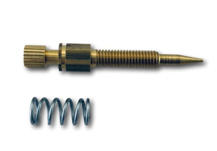

Idle air mix screw spring?
Old Dec 6, 2021 | 05:28 PM
calwldlife's Avatar
calwldlife
Posts: 53,648
Likes: 878
From: Southern Cal Ca
St. Jude Donor '22
good thought
