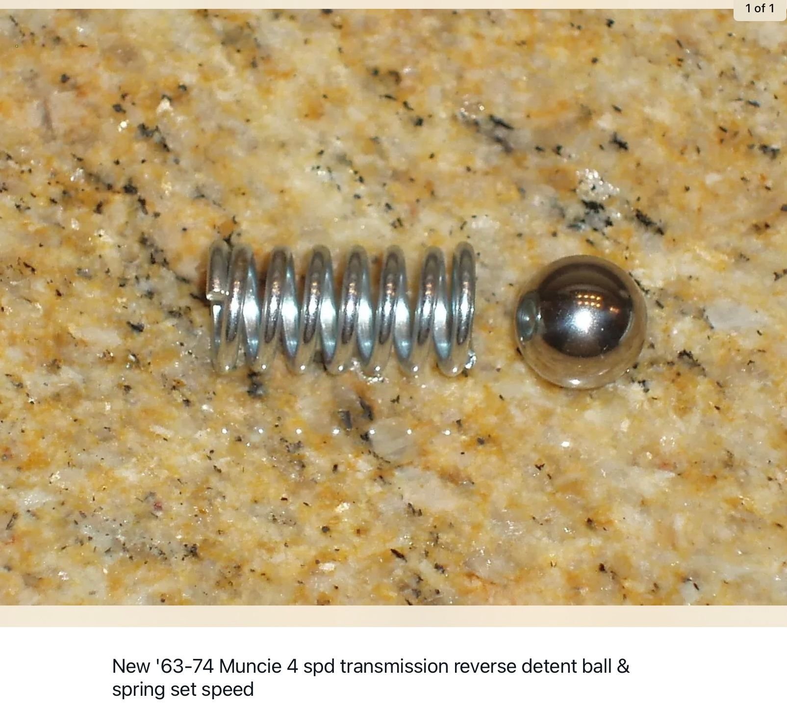

Anyone recognize this spring?

Or advance weight spring?

Never mind ....those springs have hooks on the ends.

Does the carburetor have a spring inside the filter housing?

As far as the little spring goes, I will check the idle screws but I think the spring is too small for that. I did find it under the car and I did put in a new clutch on the Muncie 4 speed, but I'm not familiar with any springs in the fork, other than the large anti-rattle springs on the linkage.

I worry about this spring...

Who says that spring even goes to your car?
I have seen stuff like that on Briggs & Straton, Tecumseh and Kohler engines.
Have one of those in the garage?

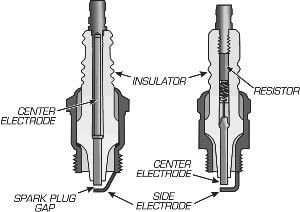

I am only posting this because I have seen too many problems die out without resolution. Not that it's very important, but that little spring, I'm pretty sure now, came from the spark plug that I broke before starting the motor. It never occurred to me that they have springs inside for the resistor piece inside the insulator. Plus I had never broken a plug before to even notice a new tiny spring on the ground.
