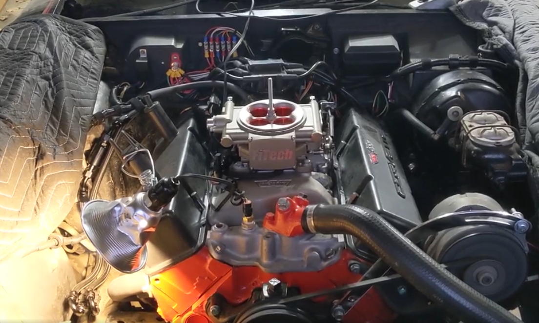

I have converted my 77 to a FiTech EFI system.
You can look at numerous you tube videos showing dyno shoot outs between EFI and Carburetors.
You will find a fairly mixed message.
Bottom line, we put EFI systems on for easy start ups. Drivability, and often better fuel economy. Ease of dialing in the fuel mixture, computer controlled Ign timing. And sometimes just to replace a worn aging Carbureted fuel system.
But peak horse power. Not so much.
Which intake manifold your using may make some difference.
But a properly sized carb, properly jetted up will make the same if not more horse power than EFI.
just 2 different systems getting the same job done.
If your looking for ease of start ups, warm ups. Better general Drivability. and even a bit better fuel economy provided by keeping the mixture spot on 99 percent of the time. Go EFI. I did and I'm very happy with the difference.
If your looking for increased power. Look at better heads. bigger cam, things that will make more power. EFI helps with tuning, but it doesn't make more power.

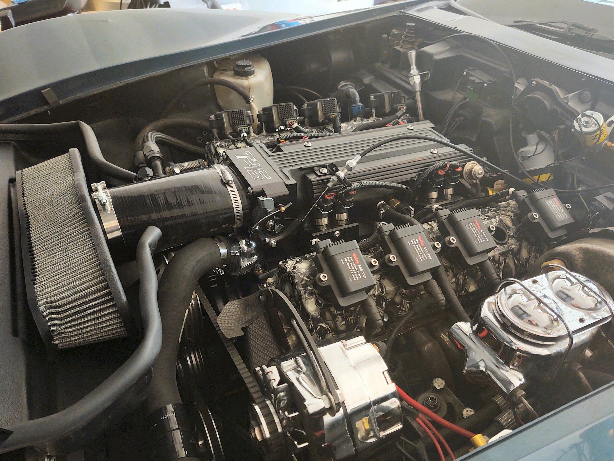

MPFI typically does not add power. If you have 485 you will keep it, and in some cases lose a few hp at the very top of your RPM vs a Carb.
I use the Holley set up. For both fuel and ignition. And I have a stout 434 with a 251/262 duration cam. About 600 lift that makes 652/602 for power. So for me the MPFI was for tuning. I am dialed in so well that anyone can drive this car in any situation. And not stall or experience any driving issues at all. I also run a coil on plug ignition just like a modern LS. And its often confused as a LS by everyone.

love your set up. Thanks for the feedback and picture.

This is exactly what I consider a perfect setup for a Gen 1, Kudos ! I have a RamJet intake that I may finally use with an aftermarket controller and with CNP also.

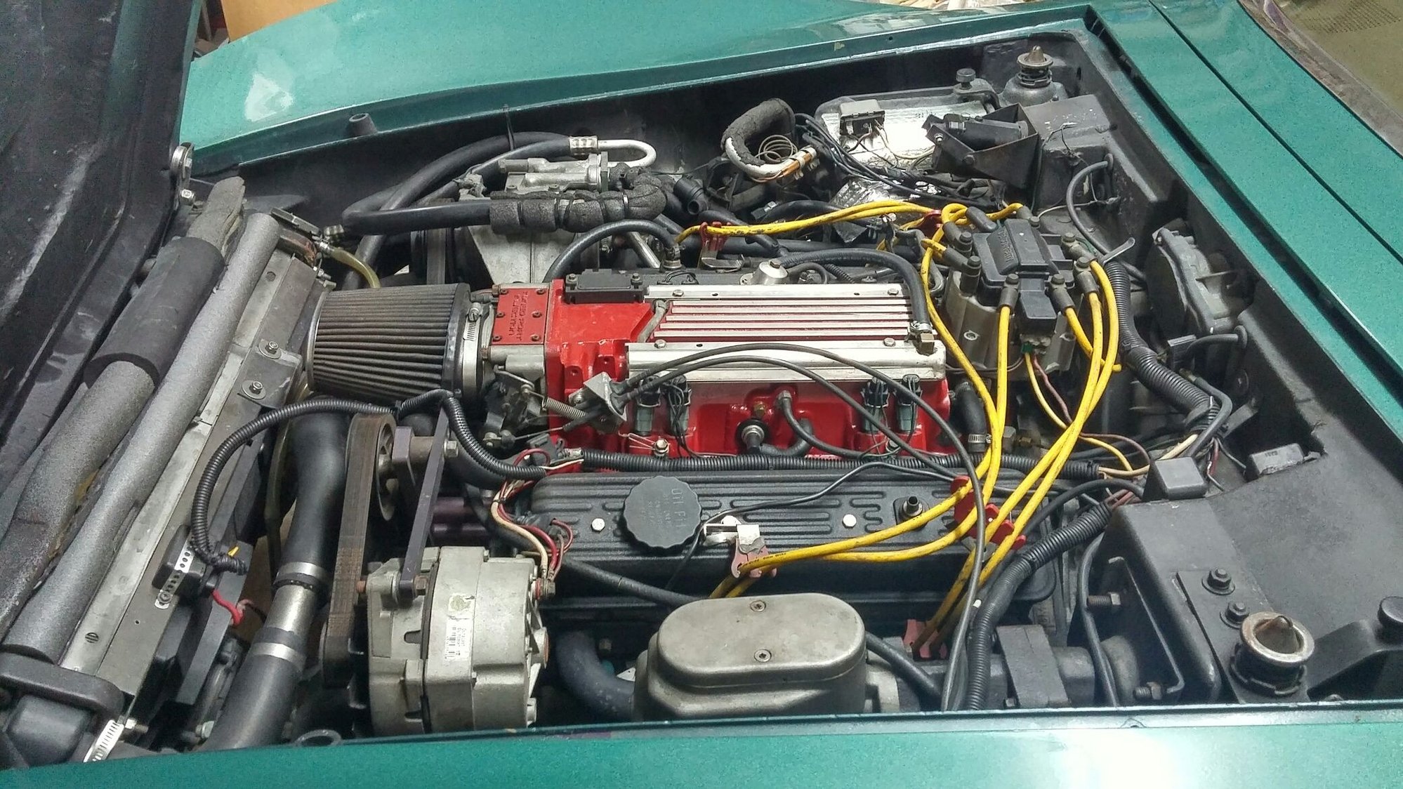

Some 20 years ago I got a welder buddy to mod an LT intake for an HEI up top where GOD intended....sparks and water ****......and so.....same thing.....
