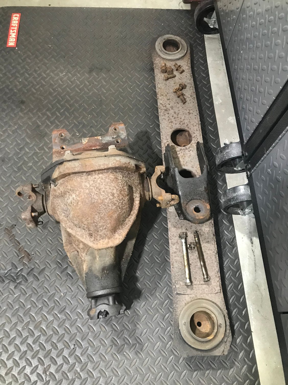

Rear awaiting a rebuild. Going from 3.08 to 3.70
If you ever wonder why they clunk going into reverse. Check out the gap here.
Looked OK from the bottom but the top biscuit here just is crumbled away.
You could grab the front of the diff and shove it up and down. Old worn out rubber.

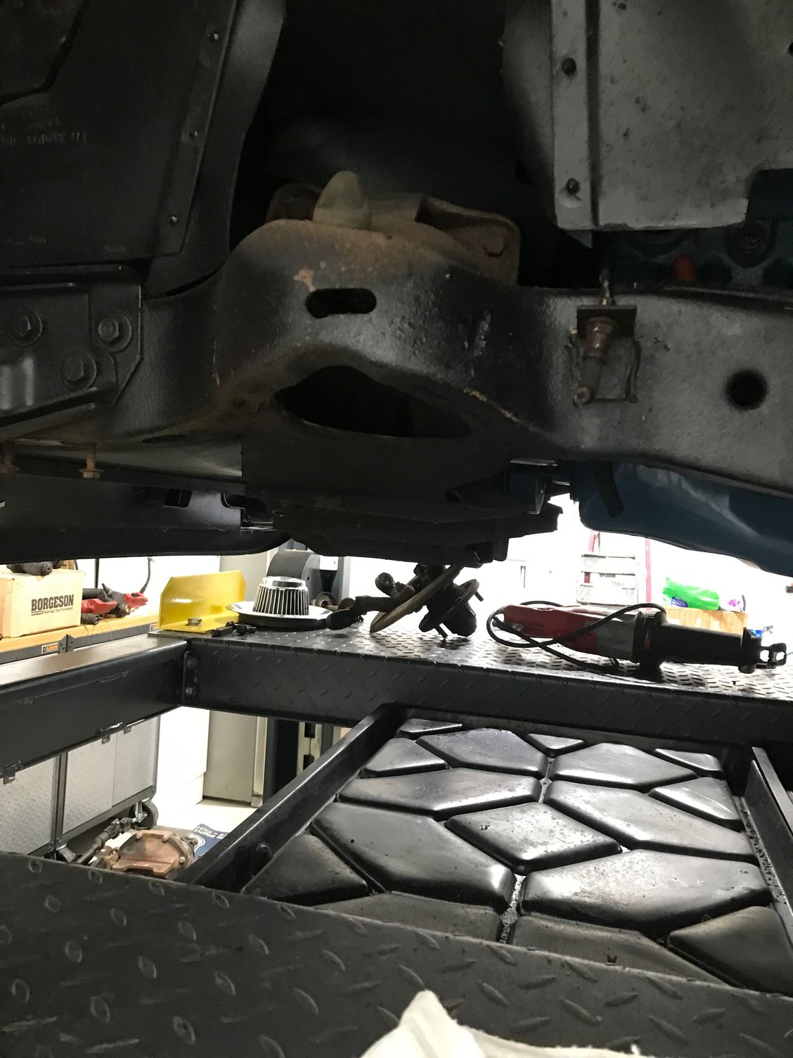

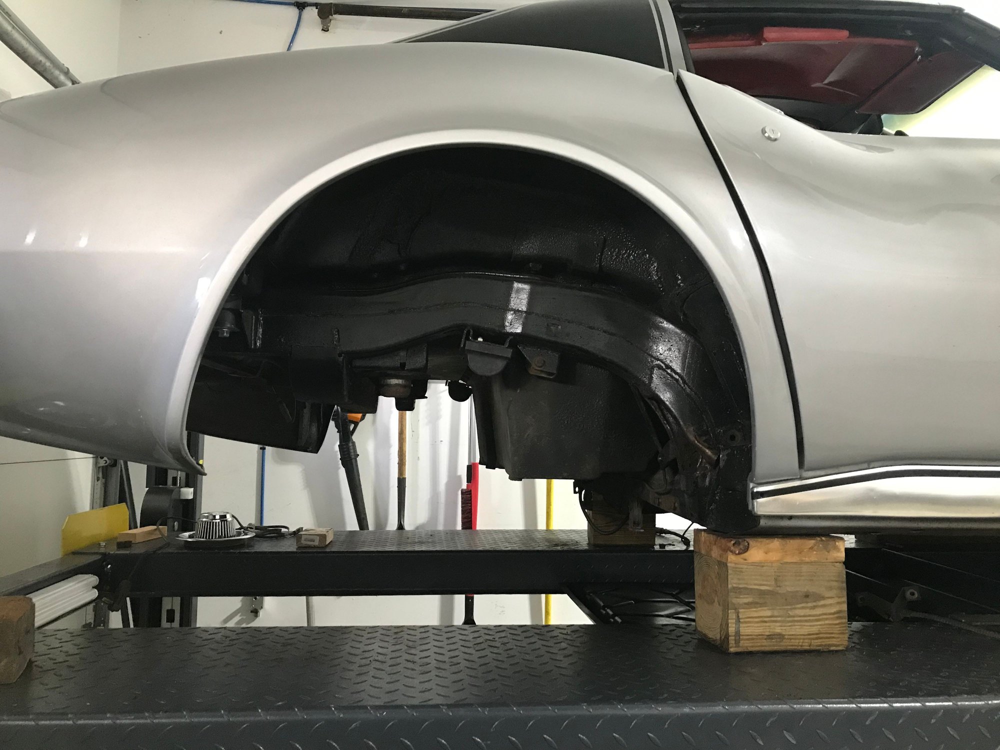

They are out
Rear suspension gone
Front suspension gone
After a long battle with the Sawzall they are finally out. The front and rear suspension are all out ready for the rebuilt parts to be installed. Making good progress so far.

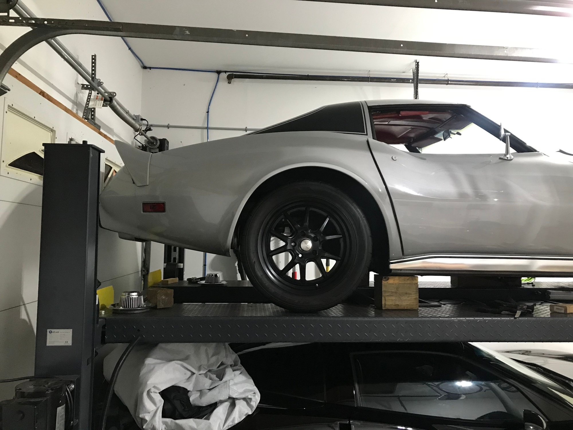

Picture of new tire and rim just placed in the wheel well. There is no suspension behind it.

Had a spare couple of minutes yesterday among all the pre Christmas stuff going on. Decided to get the rear trailing arms in and off the floor. Just bolted in and ran the E brake cable and the rubber brake lines.

Are there any limitations using that four post lift?
Old Dec 26, 2021 | 06:11 PM
Gordonm's Avatar
Gordonm
Joined: Dec 1999
Posts: 19,610
Likes: 778
From: Forked River NJ
You learn to get around them. I had a 2 post lift but it would not fit well in the new garage so. I had to get the 4 post. I prefer to use a 2 post for working on cars since the axles are free and there is way more room. A body removal is much easier with a 2 post but can be done on a 4 post.

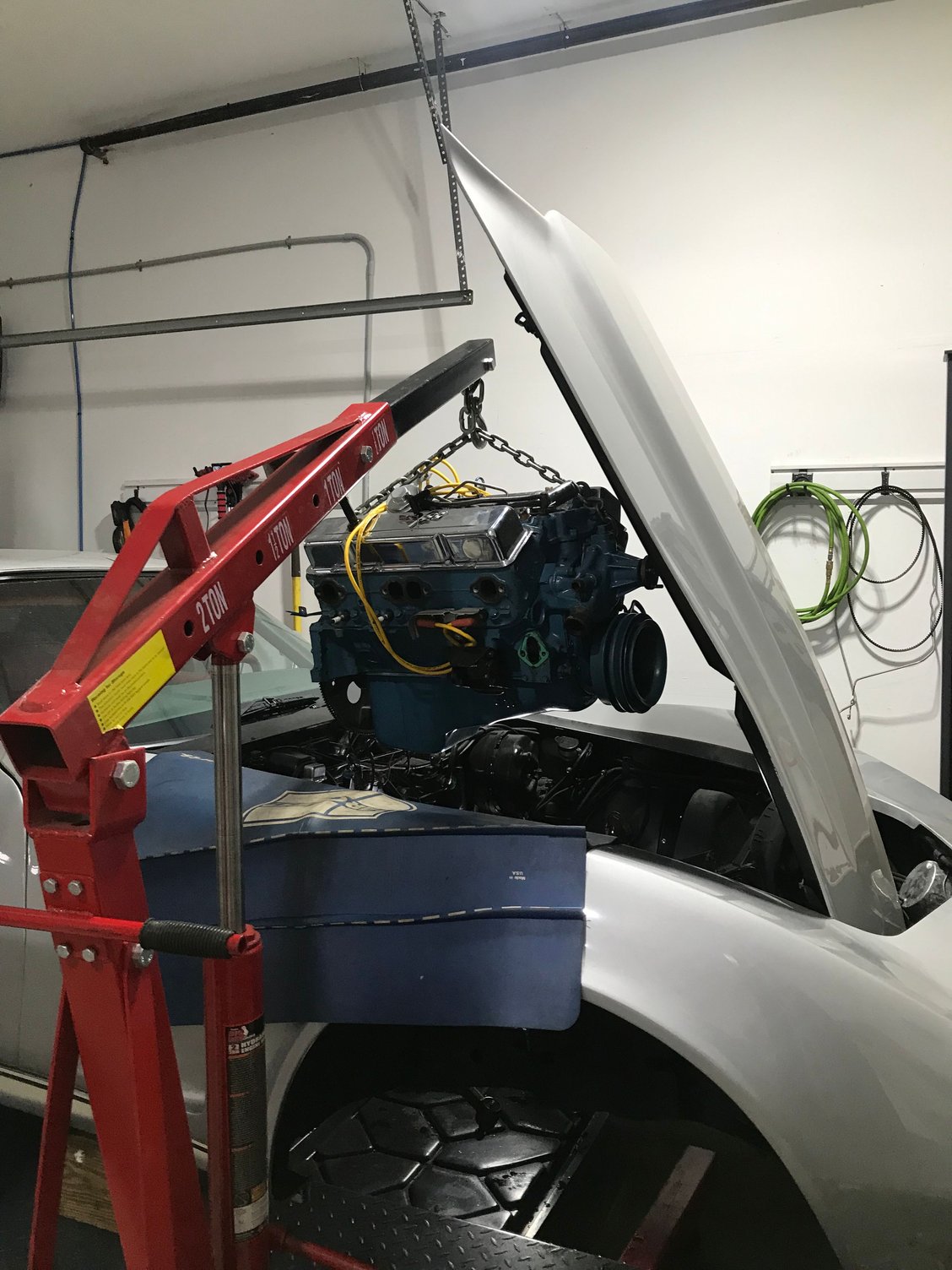

Motor coming out
Motor and trans awaiting the new owner to come pick them up
This morning I got my hoist and yanked the motor and pulled out the trans. I sold them and the new owner came this afternoon and I loaded it up. New motor coming later this week. Working on the 5 speed conversion now. Radiator was in poor condition so I scored a Dewits and duel Spal setup courtesy of David Howard for the car. Installed some new brake hard lines this afternoon. Making good progress so far.

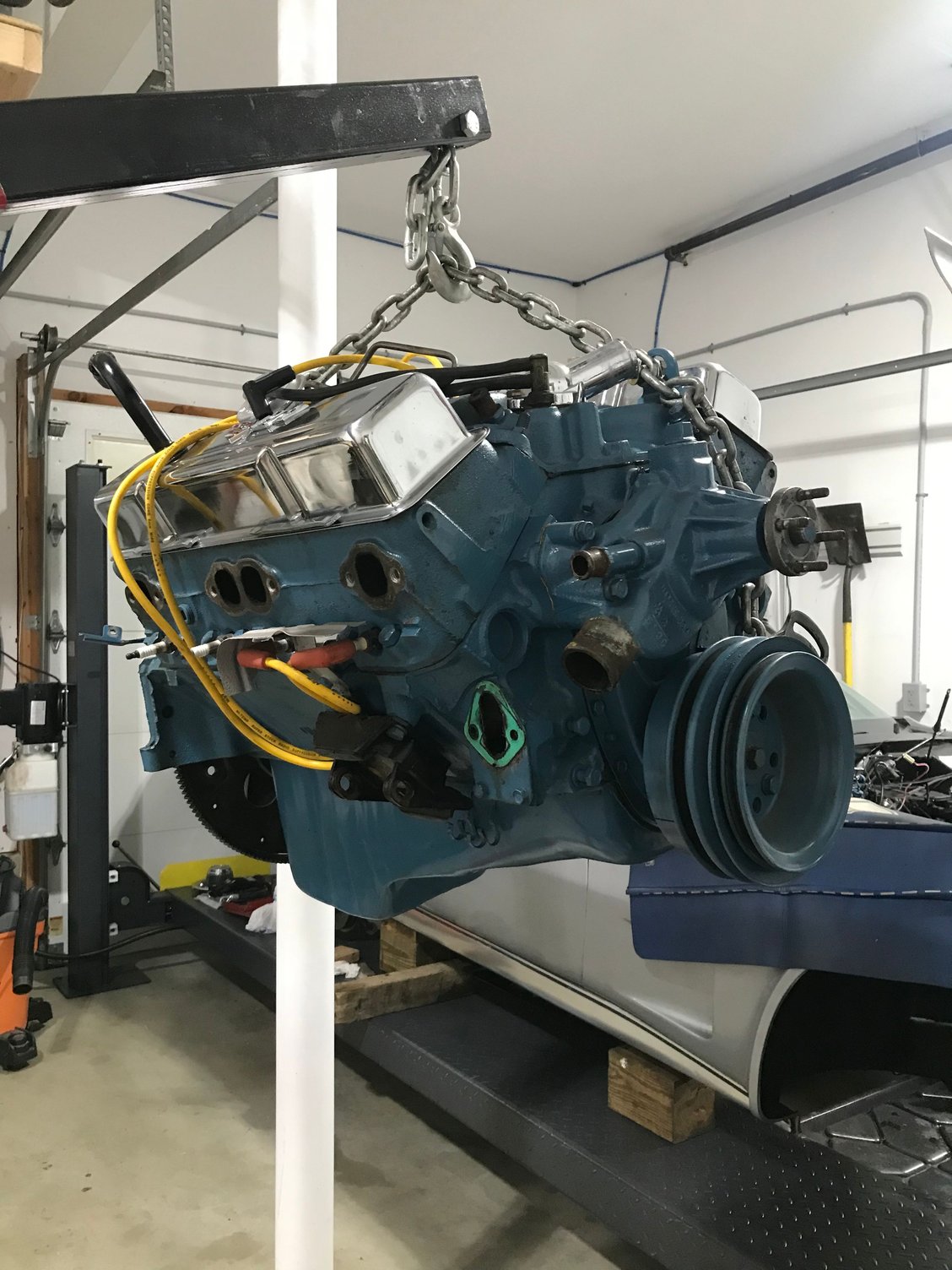

New motor arrived
What’s inside
Going to have to replace the WP but if it runs as good as it looks should be a nice upgrade form the original motor

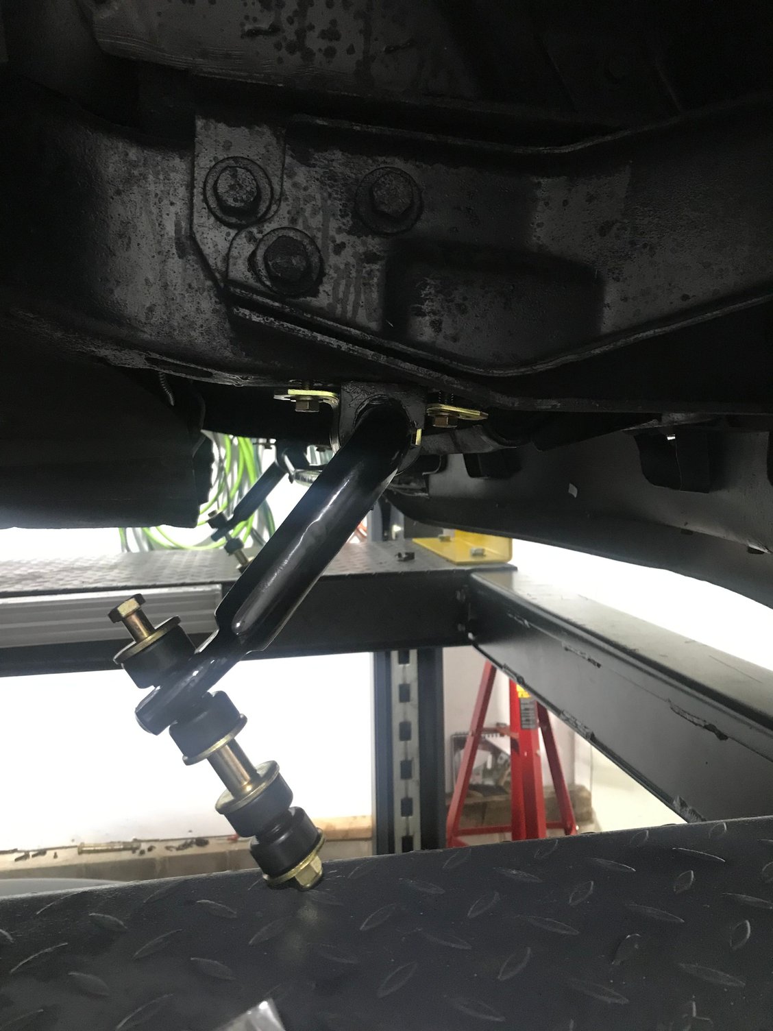

Sway bar kind of mounted, new brake lines and brakes are on. The shock is just hanging at the moment and the camber rods are in but nothing tight.
Fronts sway bar mounted
Had a slight setback. The rear that Bairs was rebuilding came in but wrong ratio. Long story short COVID had some working from home and they had a miscommunication on what ratio I needed. The 3:08 came back. Well they are now building me a 3:70 and should be here next week sometime. If I had the rear I would be all done except the rear spring which Van Steel is making them as fast as they can but are a little behind. I can’t do a whole lot with the front suspension since no motor is in and tough to compress those springs with no weight up front. Working on the Borgeson box a litttle. Next I will remove the steering column and pedal box. The TREMEC should arrive around the 12th of January. Also lost a day due to my hot water heater taking a dump. I did install a tankless system though. These are nice units and had one in my old house also.

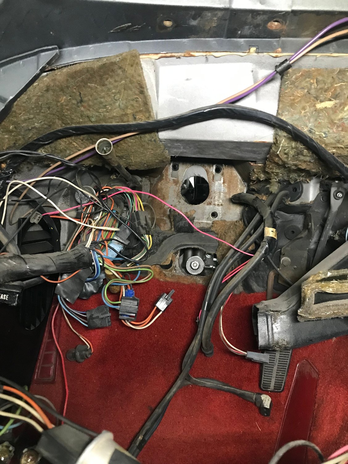

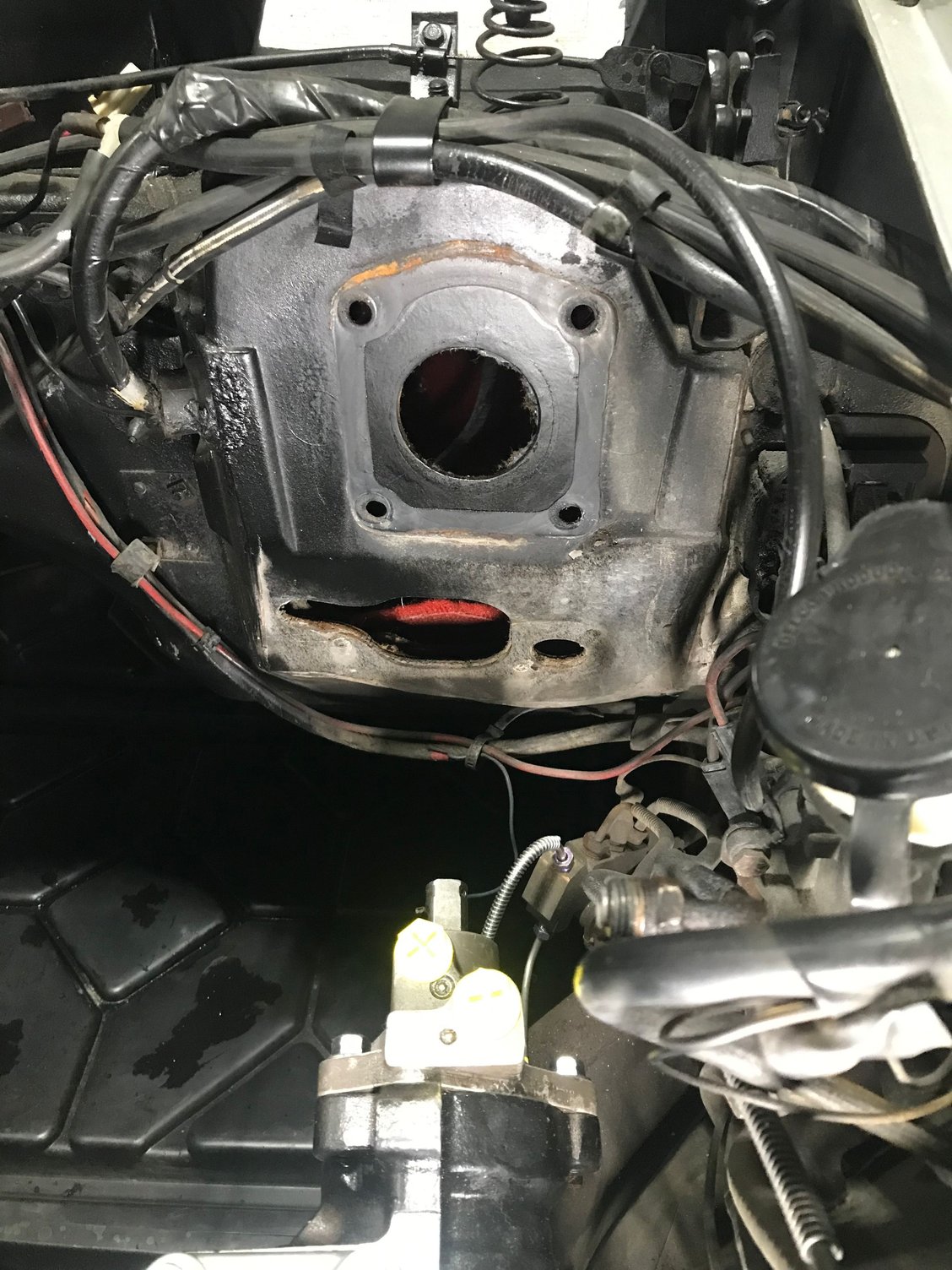

View from drivers seat
View from engine side

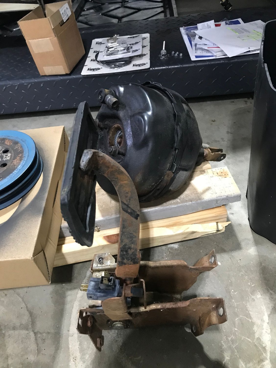

Look what I found behind the dash
Old automatic pedal box and old booster
Now just awaiting the transmission kit which should be here tomorrow and the 3:70 rear from Bairs. I’m at a standstill until more parts are in. Just cleaning up things getting them ready to be reinstalled now.

Nice finding the build sheet under the dash.
Looks like it was well preserved up there.
