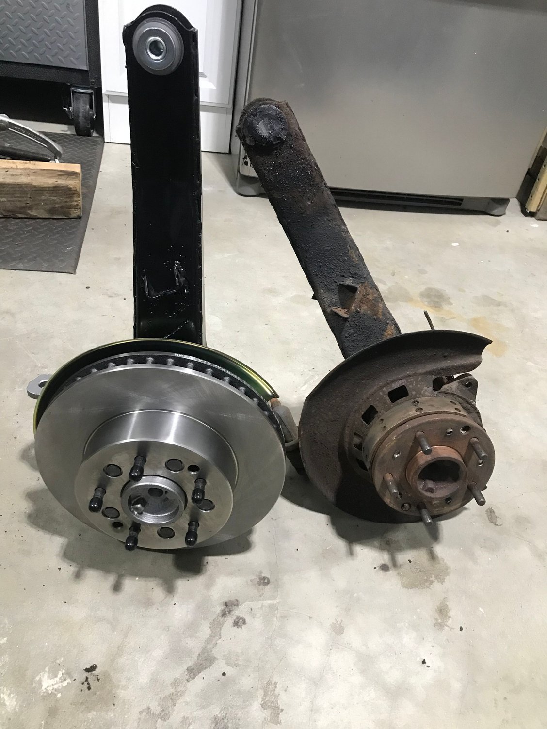

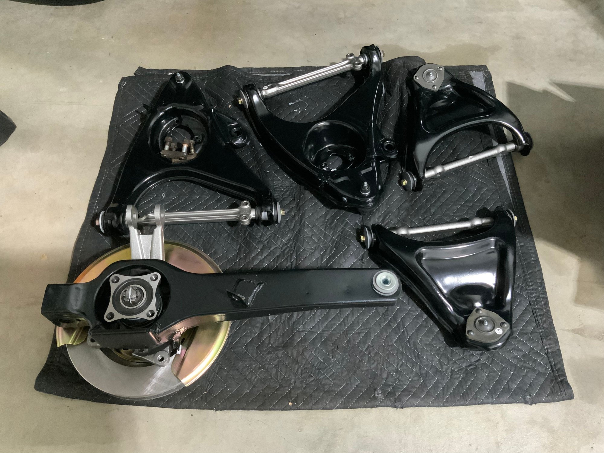

Out with the old in with the new
New parts awaiting install
I got these parts from Bairs. They did a great job and have the rear end now. It is being rebuilt and converted to 3.70 gears to go along with the 5 speed TKX that is going in also.

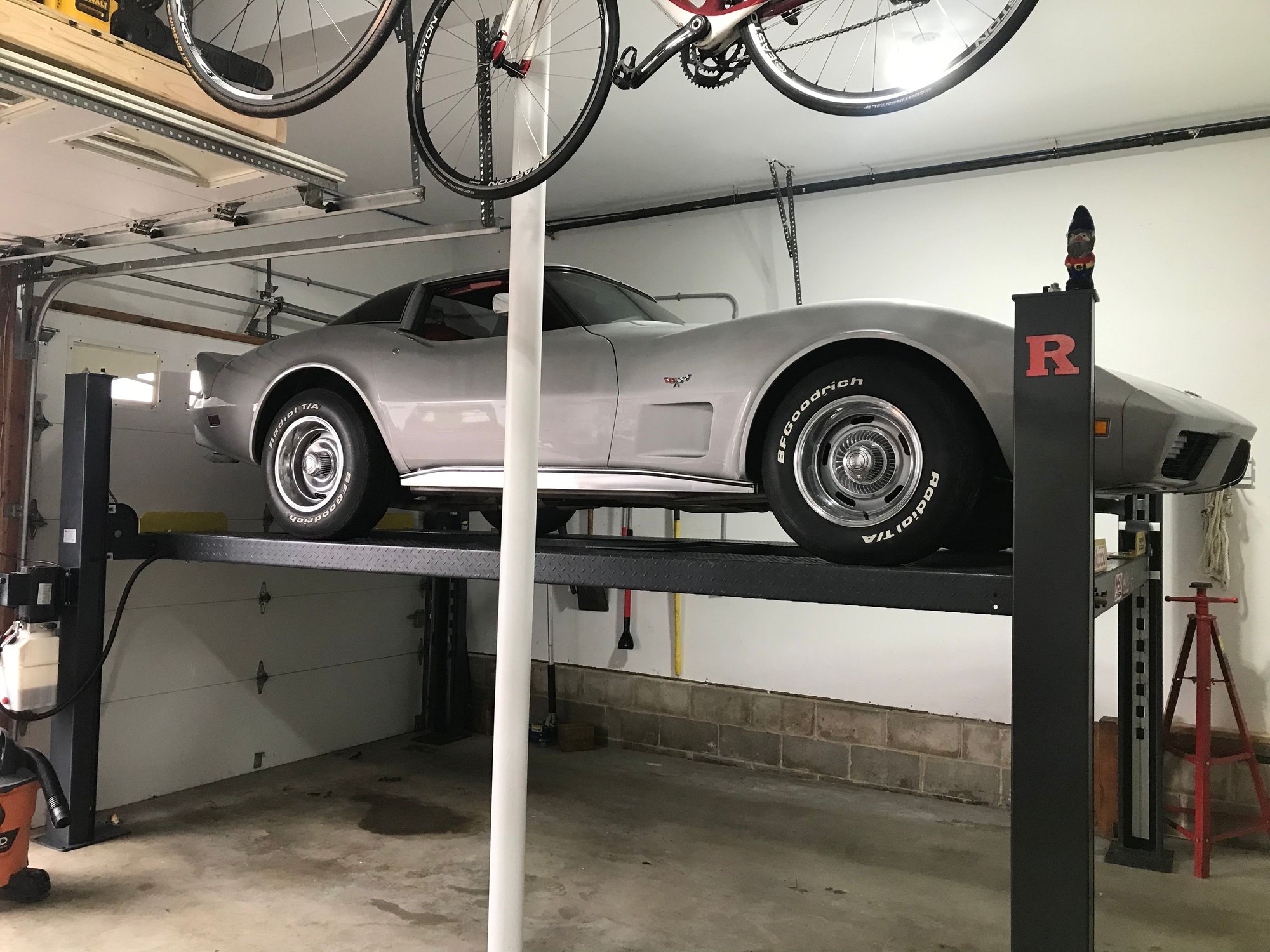

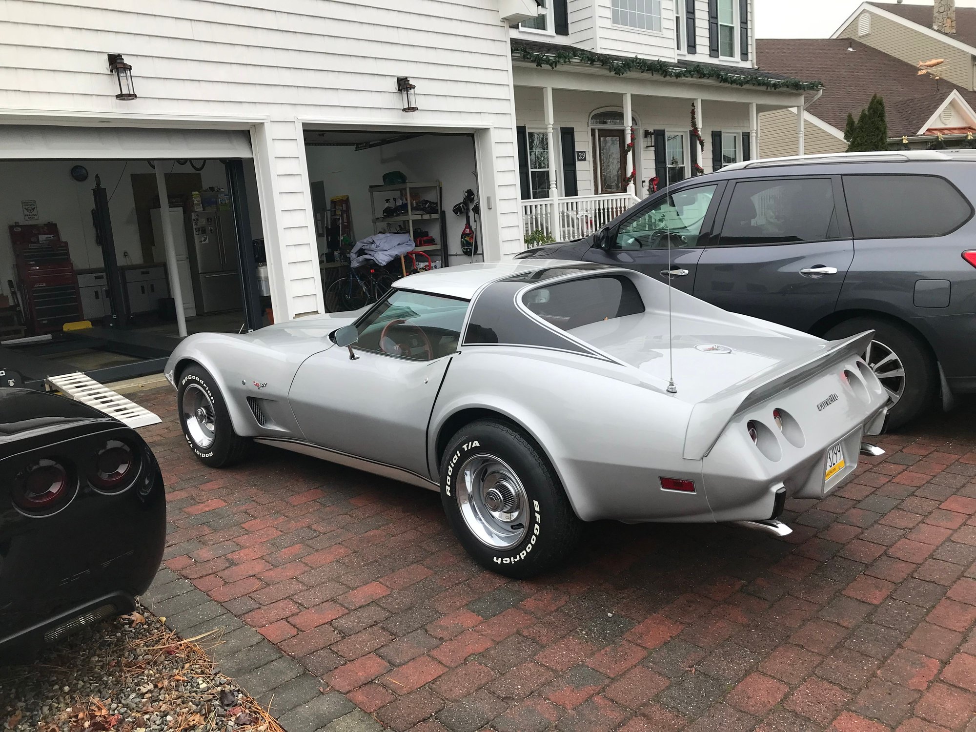

Here is the car in my driveway. Looks very good from this angle.
Up on my lift ready to get to work. First car on my lift in the new house. Everything clears.

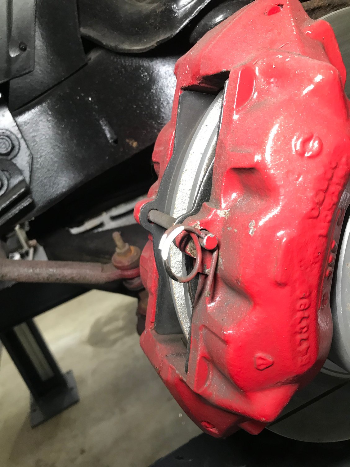

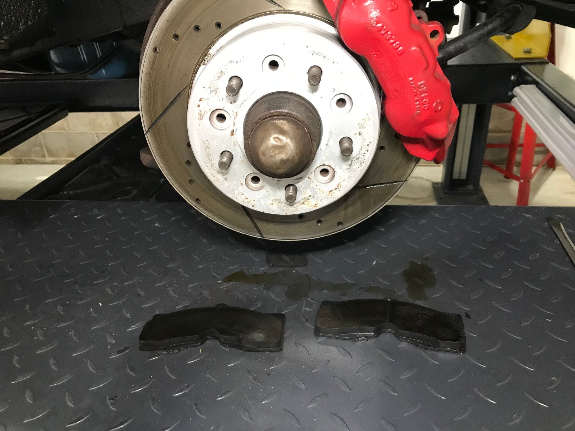

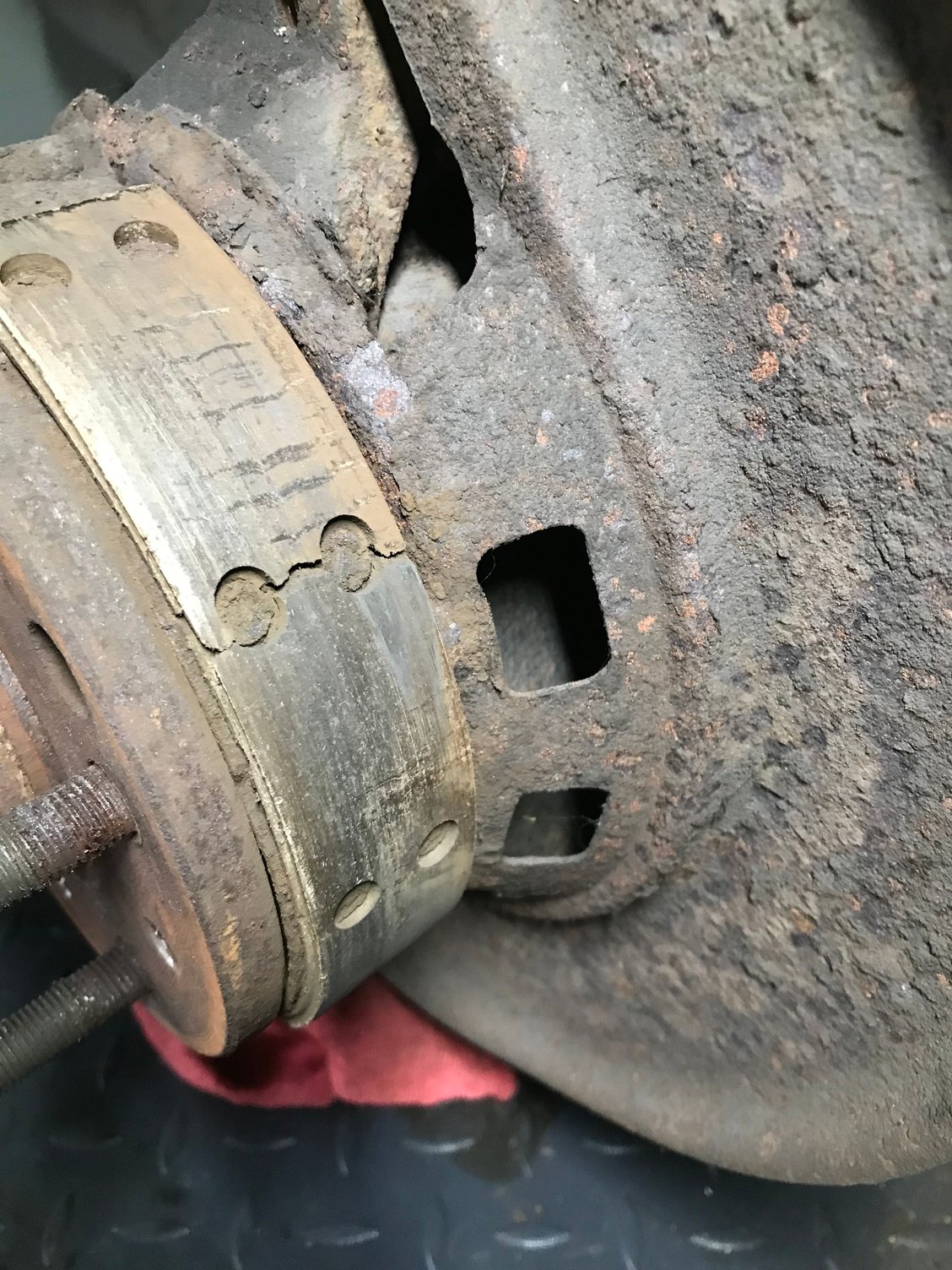

This did not take long to figure out the problem. It was leaking from the time it got on the lift. Gee I wonder why it was pulling left.

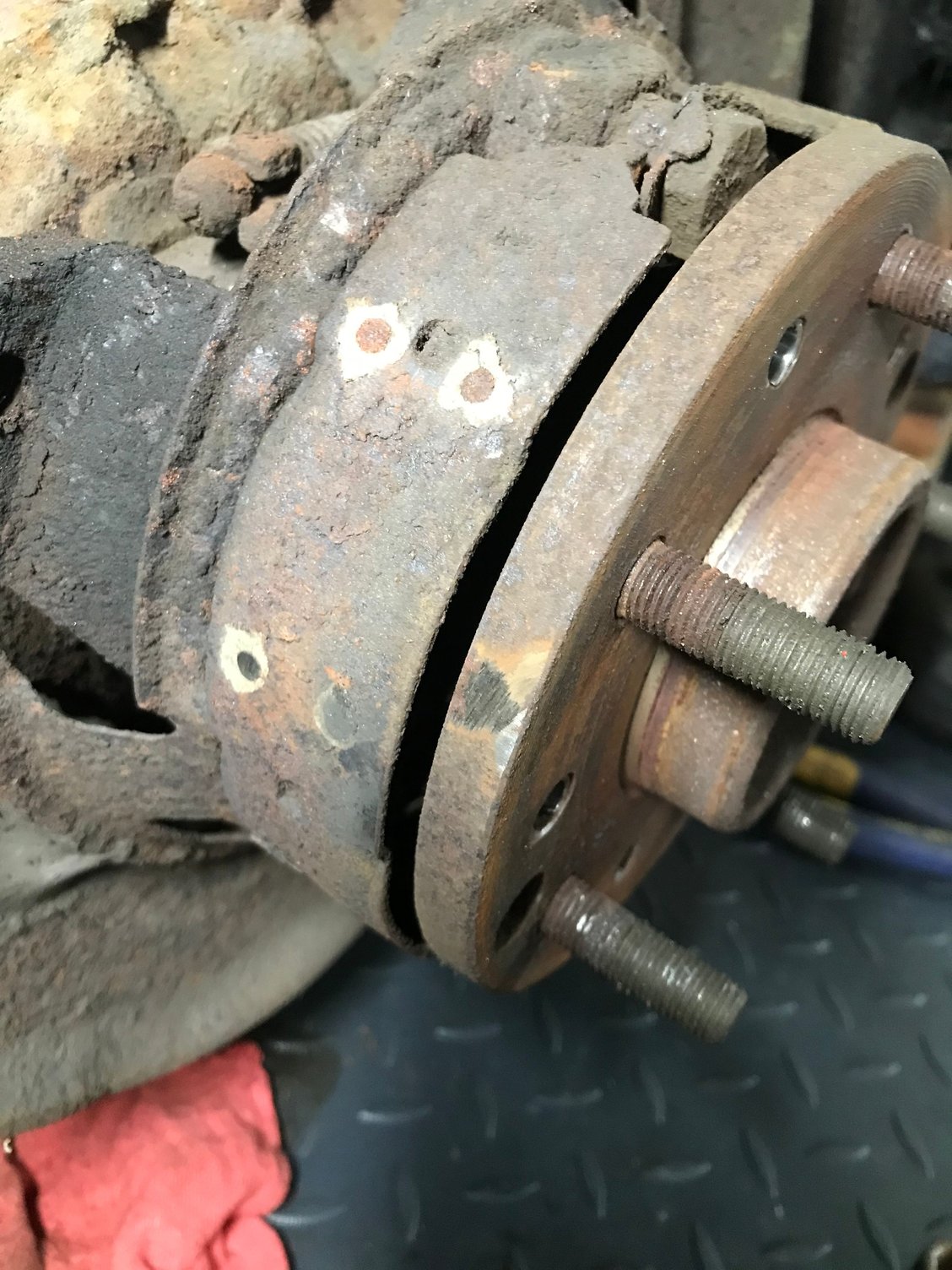

Left front caliper. Why take the time to find the correct cotter pin when any old thing will hold the pin in place. It was rubbing the inside of the wheel. This would have been gone in another couple of miles. Why do people think this is OK.
Seriously the E brake is not working? I can’t imagine why it would not hold the car. I think these are original! This will be replaced.

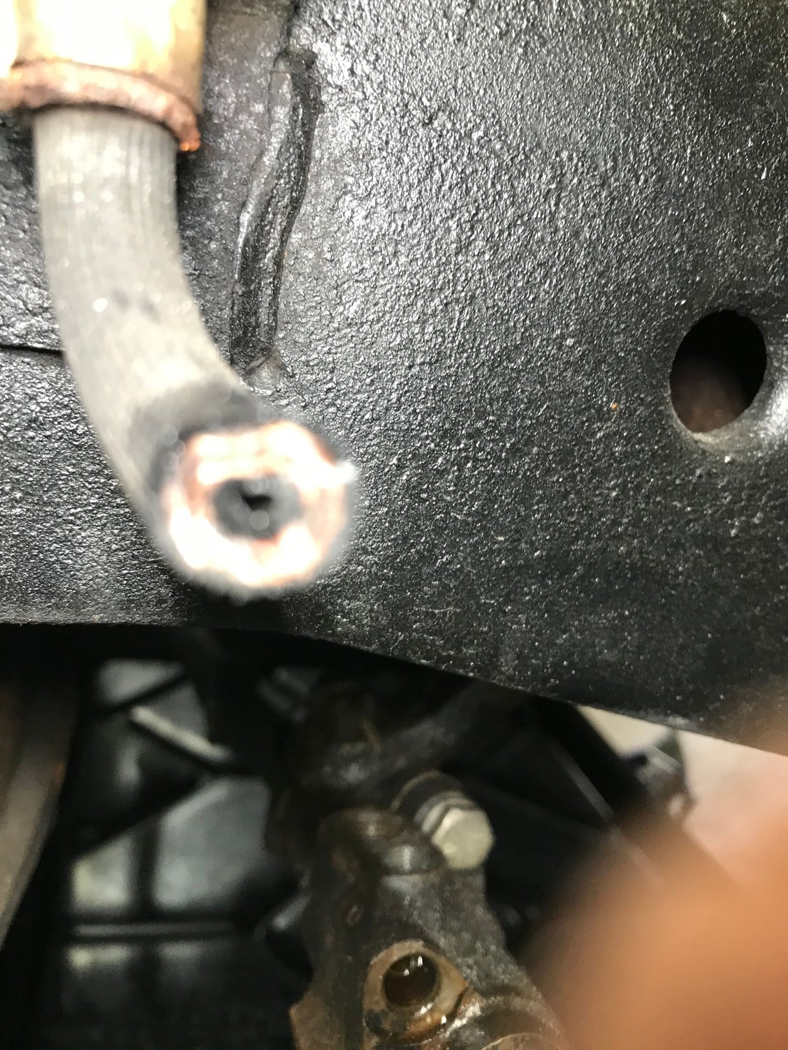

Bad picture but you can see after 44 years the rubber brake hose has swelled a lot. The hole is very small so brake fluid travel is limited. All the brake lines are going to be replaced. Just cut them all off. New ones on the way.

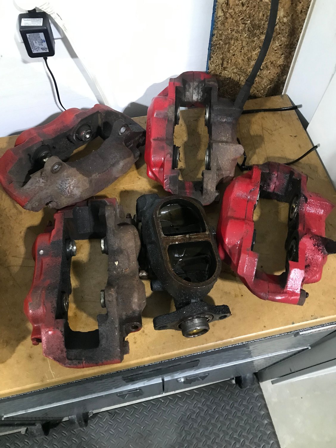

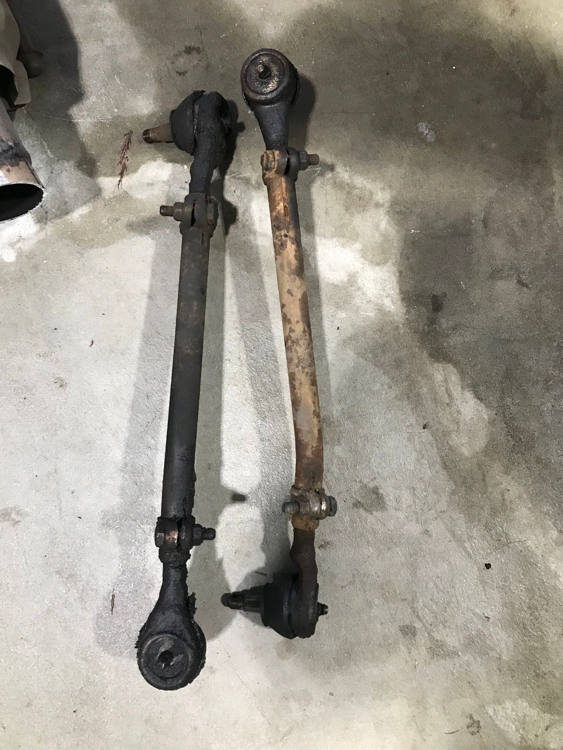

Either this car was hitting curbs or the alignment guy said screw I’ll bend them instaed of threading them in or out. These don’t look straight to me.
Cores. Someone wanted red calipers so just slap some red paint on them.

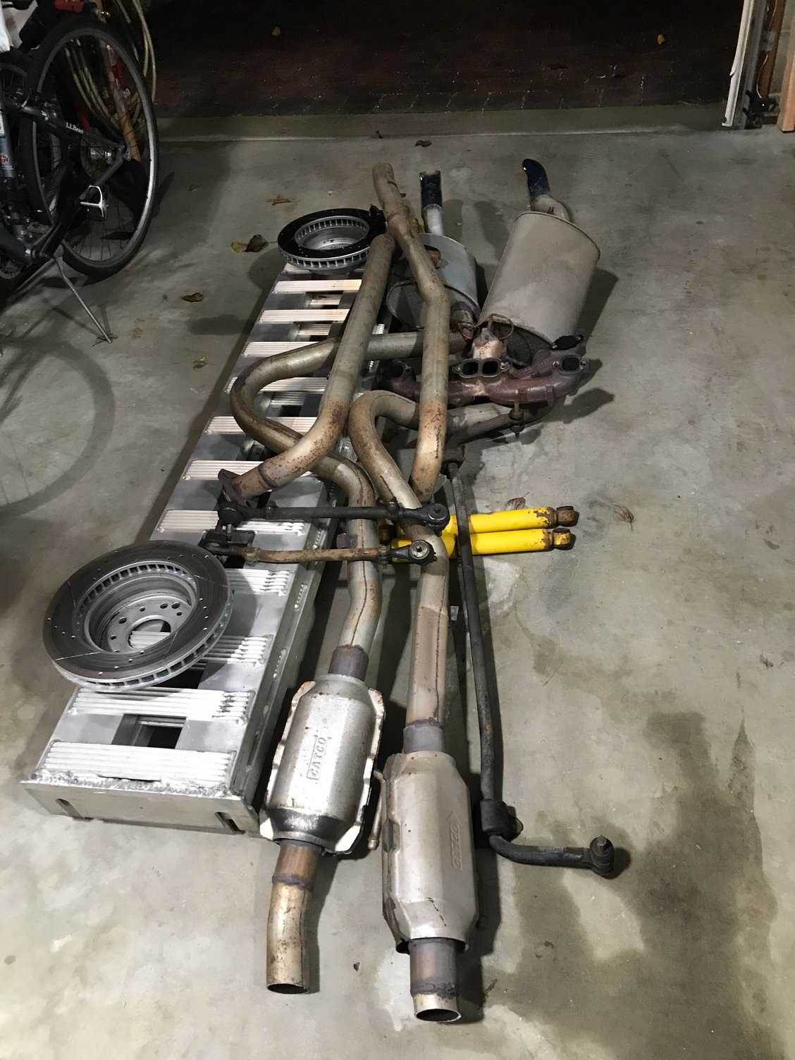

Pile of scrap metal other than my approach ramps.
All cleaned up and put away for the night.

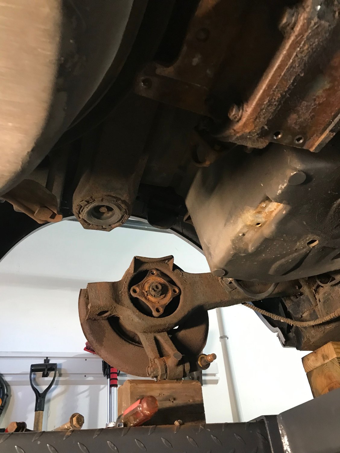

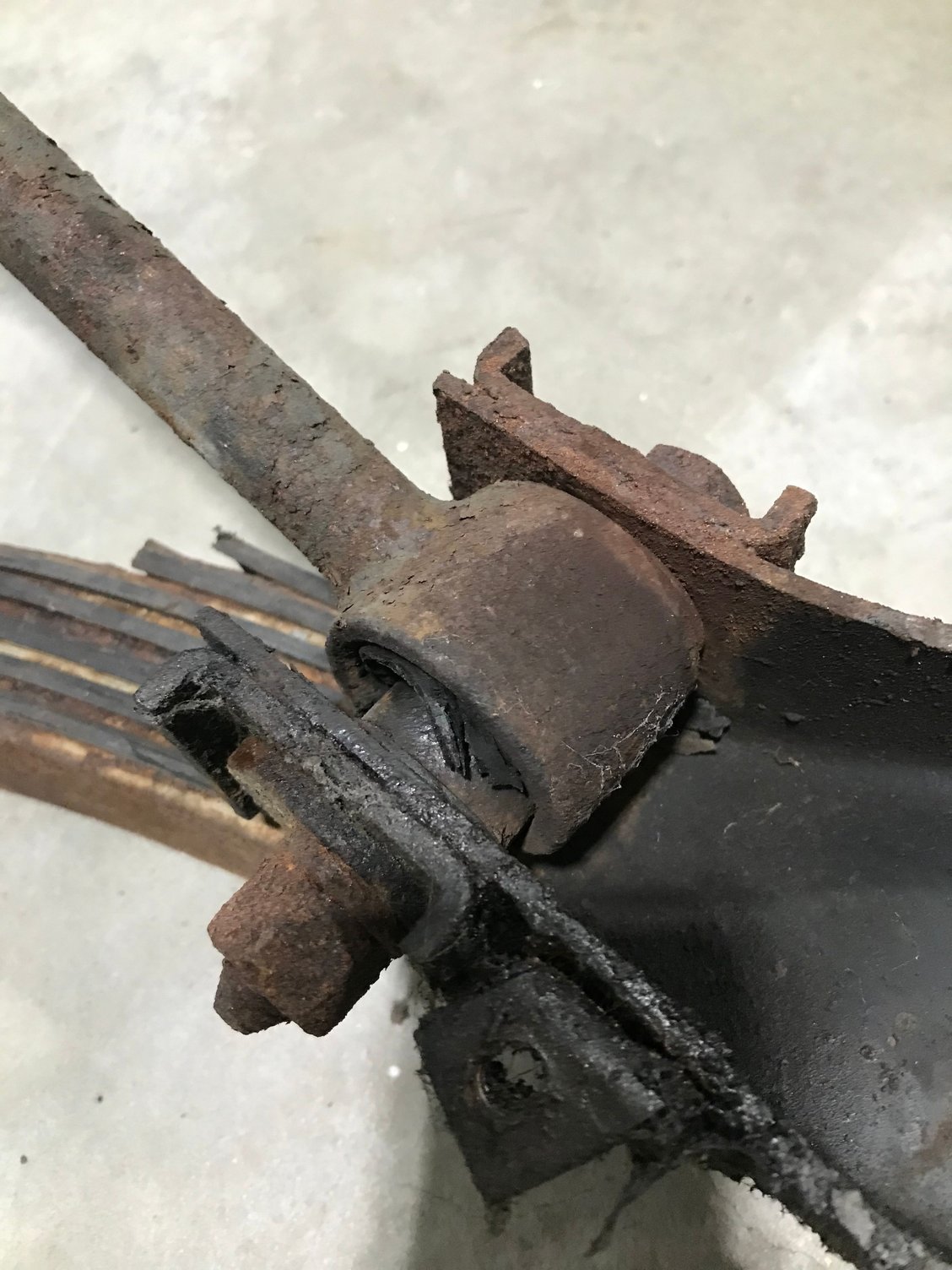

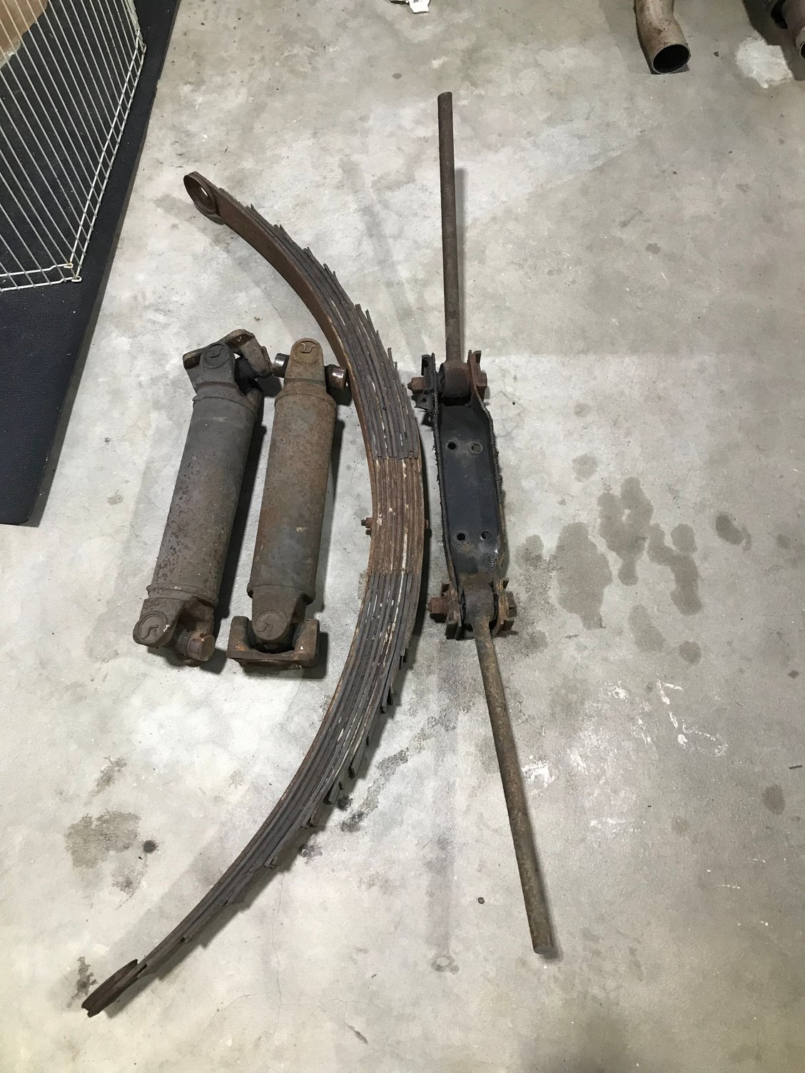

These strut rod bushing have about had it.
All that’s left is to remove the trailing arm. I’m sure the sawzal will have to be used.
Here are the parts that came off today.
The ujoints are the strap type and were so rusted in there I had to cut the straps and remove the half shaft. I did not even try to remove the shock mount. Going to replace the strut rods so I just cut them off. I’’ let the rebuilder remove the shock mount. Forgot how heavy those steel springs are. I need to make a run to the scrap metal guy soon to get rid of this garbage. t
