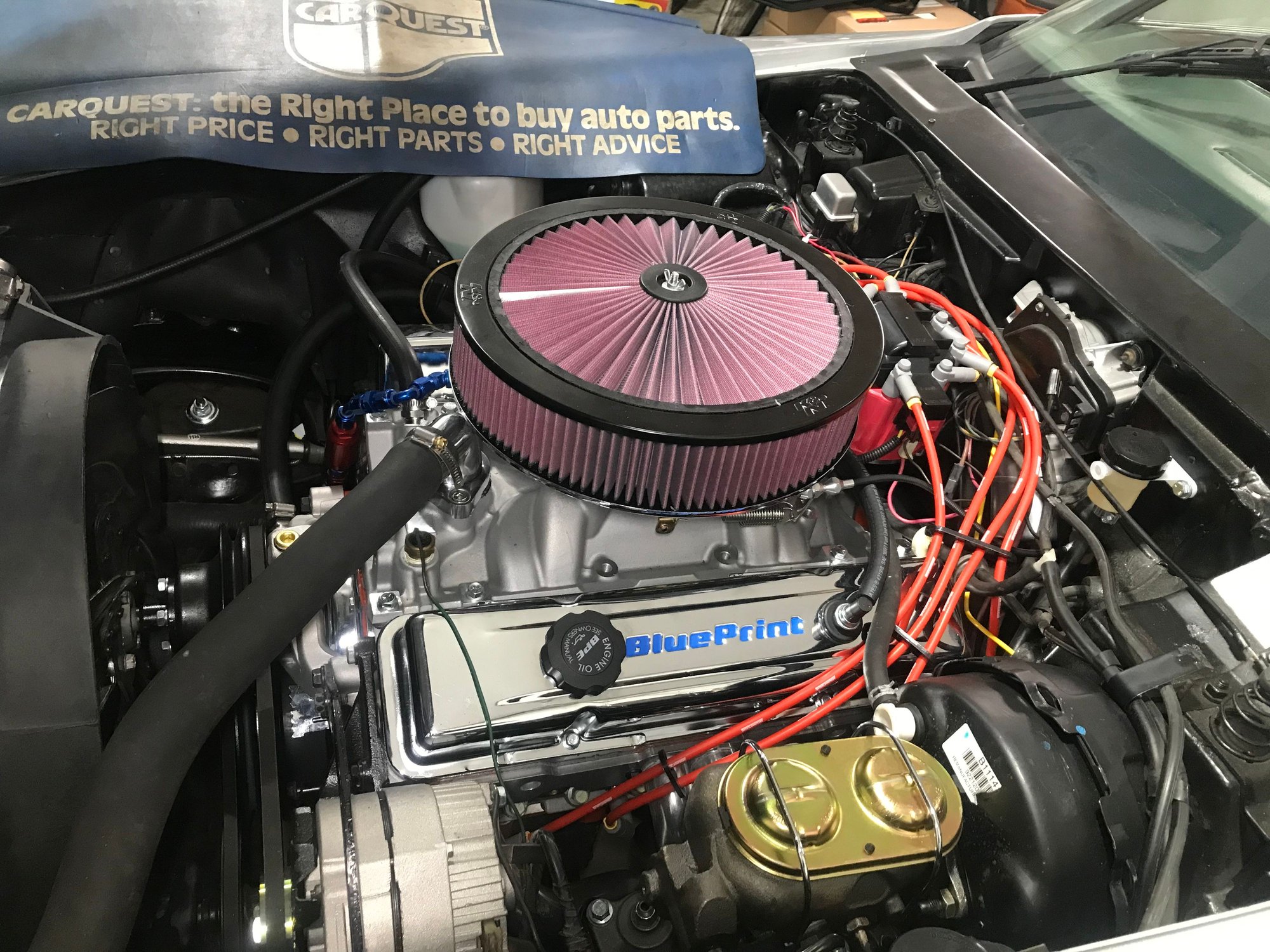

Coming to an end on this 77. I took a week or so off and went to Florida and got back and started to finish this. Here is the motor pretty much done and running. Blueprint said this would not fit under a Corvette hood. Well a drop base and 2 K&N filters and it fits with room to spare. about an inch clearance. I do have a video of this running and took it around the block with open headers. Car runs good and will have plenty of power. The owner is stopping by today to drop off a new radio and center console pieces. These are the last pieces of the puzzle. I am farming out the exhaust system as I’m not satisfied with any of the aftermarket ones. They just don’t fit correctly for anything that will flow well. This has been a fun winter project but now I have to move it on to the owner so he can enjoy it and I have many other projects for this spring and summer. I’ll see if I can upload the video somehow.
