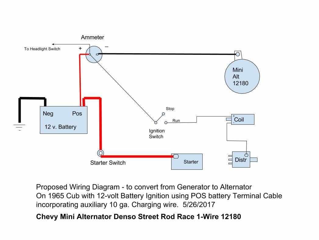

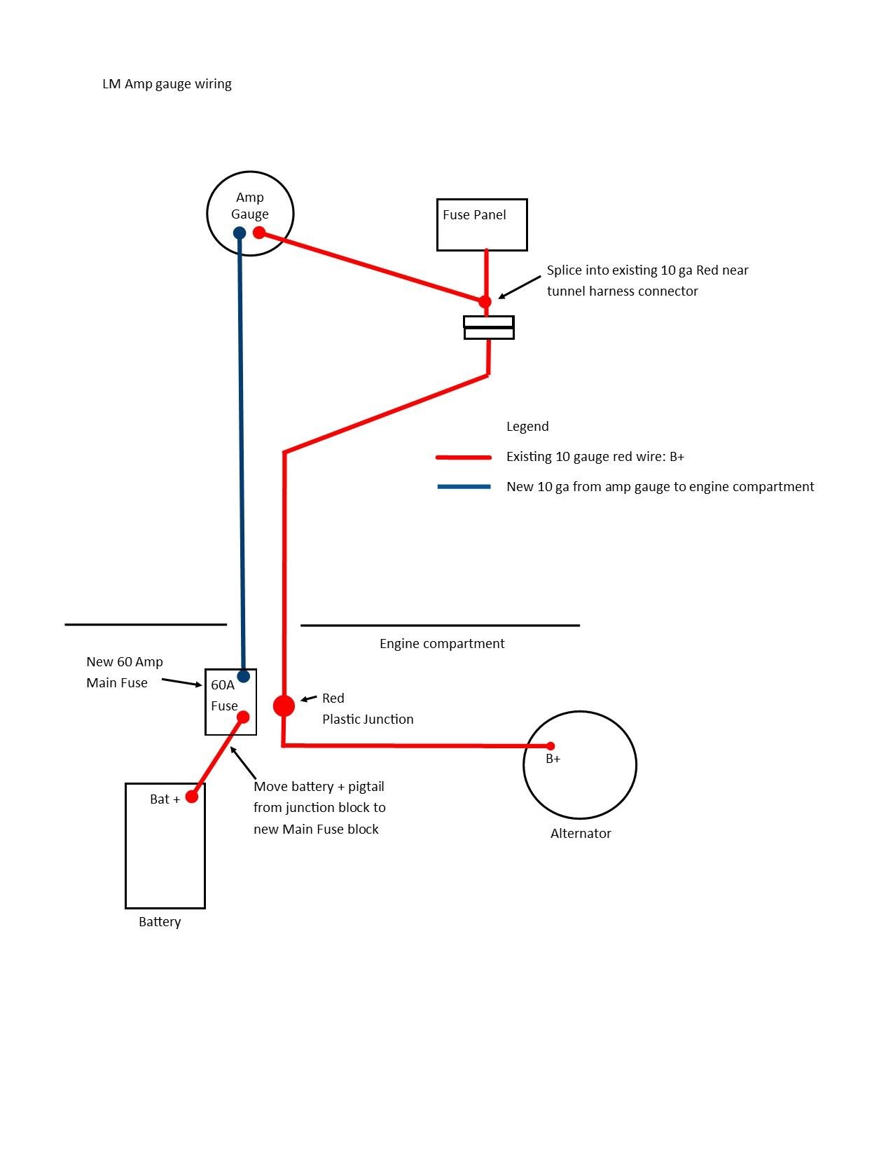

Okay, the ammeter gauge issue I think I understand, the prior owner put a 1 wire alternator in it and never bothered to re-wire for the gauge. That said, I ran across a couple of diagrams, neither Vette specific, that may be correct for remedying that Both? One or the other? Can the gauge wire run in parallel with the battery wire? Seems it would need to be really heavy duty based on my limited ability to read electrical schematics.
