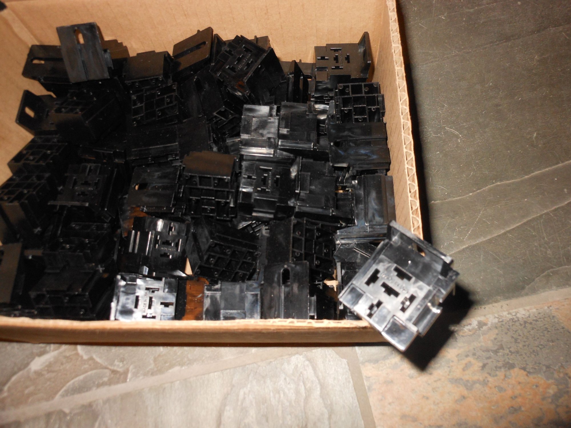

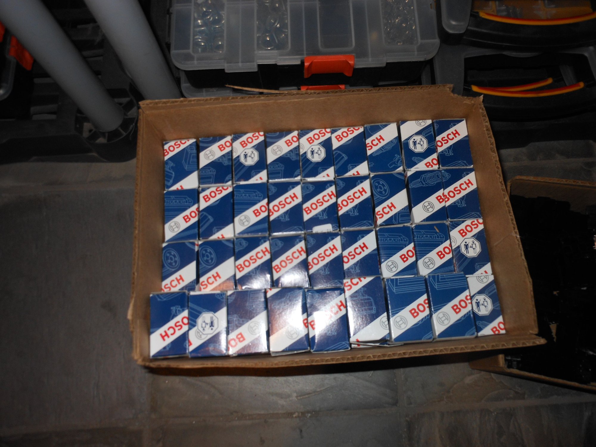

Originally Posted by QUICKSILVETTE
I also like the relay idea, my question is how do you get an exact relay the one in the diagram you made?
Summit Racing has them- but I think I have more than them!!!
Quality- never had an issue with one ( out of thousands!!!)
$6 not made in China
https://www.summitracing.com/parts/BCH-0332209150
Here's the socket it like - Made in the USA - Hella-
