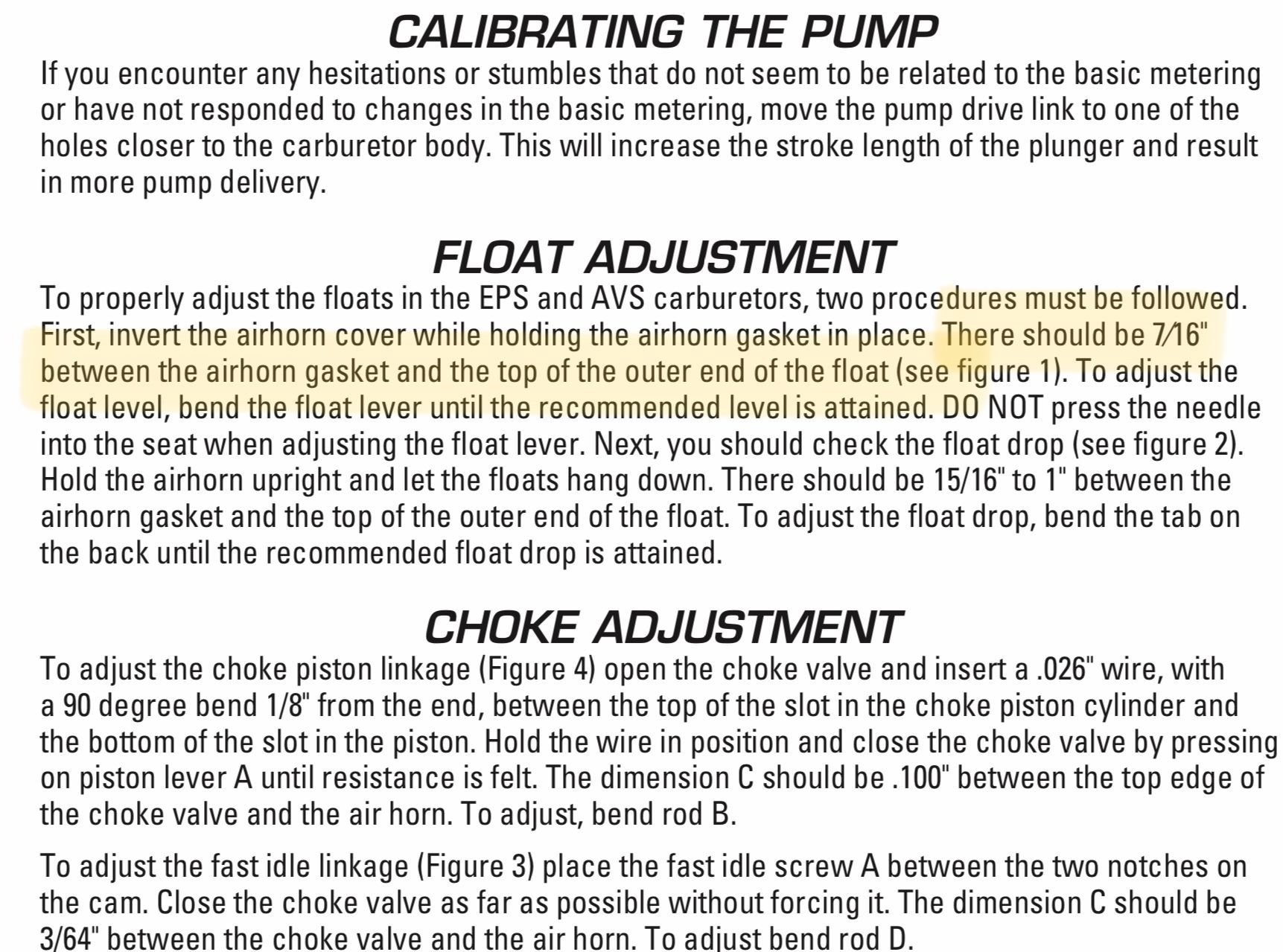

Originally Posted by Cmurray79
I just adjusted my floats to 7/16 and 1 inch a month ago. I’ll double check them too.
What in the world type of carb do you have with a 7/16" float level...??
AMEN.

Old Dec 25, 2021 | 10:16 AM
Factoid's Avatar
Factoid
Joined: Jul 2018
Posts: 10,588
Likes: 8,409
Isn’t that the initial adjustment for an Edelbrock float?
This is from the Edelbrock tuning manual.
To Valve adjustment and backfires
I shouldve clarified in the original post, its an edlebrock 1406. New accep pump didnt change anything, as well as changing the location of the accel linkage to a more agressive fuel load
yes this is what I was going off of, and havnt had issues in the past with it. I’ve just gotten back to my car, i was in AZ since New years
