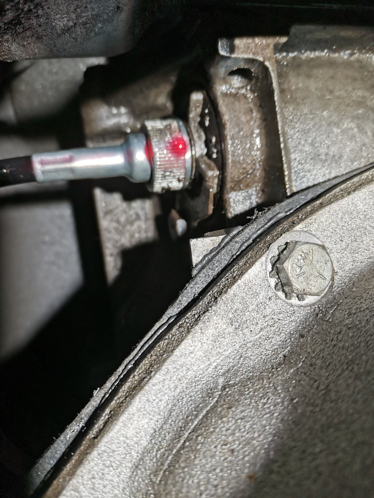

Is there a seal or "O" ring in here? It is pretty tight but still leaks.

There are 2 seals. One is an O-ring around the outer diameter of the large speedo gear insert. The other is a lip seal that seals the spinning inner shaft to the inner diameter (bore) of the insert. Tightening the speedo cable has no effect on leaks - there is no seal in the cable.
Thank you Lars, I presume all fluid needs to be drained to change these?

Nope. The speedo gear insert is above the pan fluid level. You'll get a few drops leaking when you remove the insert, so just put a drain pan under it when you yank it out.

IF the inner lip seal on the TH400 is similar to the one on the TH350 then replacing it may or may not solve the leak depending on the condition of the old seal. I replaced mine when it was leaking only to find it still leaked. What I ended up doing was putting and o-ring under the lip portion of the the lip seal ( where a spring normally resides, Don't recall if this one had a spring or not), to force it tighter around the sealing area and that did the trick.
