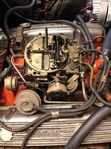

Tks all for the replies, the NAPA auto guy was hinting around about having it rebuilt, so yes I will go that route. If Lars or Cliff have a web site or email address it would be appreciated. Pictures attached.

Looks like a decent carburetor for a good setup!
I would like to make a couple recommendations before you remove it.
The brake booster pipe is not being reproduced and are getting hard to find.
Put a couple rags under the pipe nut and carburetor bushing, apply some good penetrating spray (Kroil or PB Blaster) around where the pipe nut rotates around the pipe, just a shot or two and let it sit a few hours then apply again. Yellow Arrow
Before you do go to remove the pipe, remove the single attaching screw at the throttle cable support bracket. Red Arrow
Doing this first you can see if the pipe is starting to twist at the support and will prevent the spot-weld in the thin tin support to rip.
I have seen many of these pipes destroyed.
Use 2 wrenches.
Do the same process for your fuel line,
And use 2 wrenches
Nice Car!

Thank you! Yea I started to take it off and the fuel line was not being cooperative, I sprayed it and will resume tomorrow. Sending to Lars for rebuild. Really appreciate the feedback and advice! That would of been a huge mistake to buy the Edelbrock if I had a original carb. which was rebuildable.

Spray on the nut isn't going to do anything. You just need to use the correct flarenut wrench on the 5/8 fuel line nut and a 1" open end on the inlet nut and put a bunch of force on it. Never attempt to do it with an open end wrench - use a flarenut wrench. Buy one if you don't have one.

I have received Tom's carb, and it is a beautiful, pristine example of a near-perfect 1975 Vette Q-Jet. Completely unmolested, and in great rebuildable condition. Some minor problems with a defective rear pulloff, vacuum leaks, a low float level, and other normal setup issues. The carb is going through final cleanup and detail prior to final assembly. This thing should come out looking nice, and is going to run really well. Photos of the test-run to follow...
