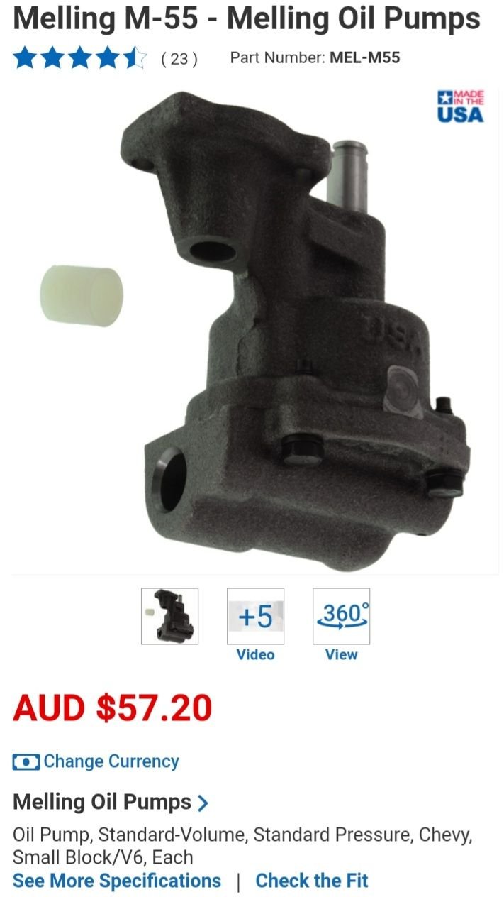

Well, now that I've got my engine running as it should. Next project. Replace my 45 year old oil pump. I'm thinking of ordering this one for my mild 350. thought before I do. I'd throw it out there. Thoughts?

I agree, However, I live in Australia. if I get it apart and then determine that it needs a pump. then order one. I'll be down for 3 weeks. I would rather be prepared, So, What do you guys think of this pump? or is there something else I should be looking at?

Melling is a good choice.

Melling pumps are good...and just about everyone sells them under their own re-branded names.
I'd opt for the "Z-28" version which is a stock volume pump with the high pressure spring. I like a little extra pressure...but I hammer on stuff a little!

The Melling is the best choice as stated. Do not forget to buy an ARP mount stud and IS55 steel collar driveshaft.......

If you can keep the stock pump I would suggest that. At one point the new Melling pumps have thin castings compared to old and were cracking.
