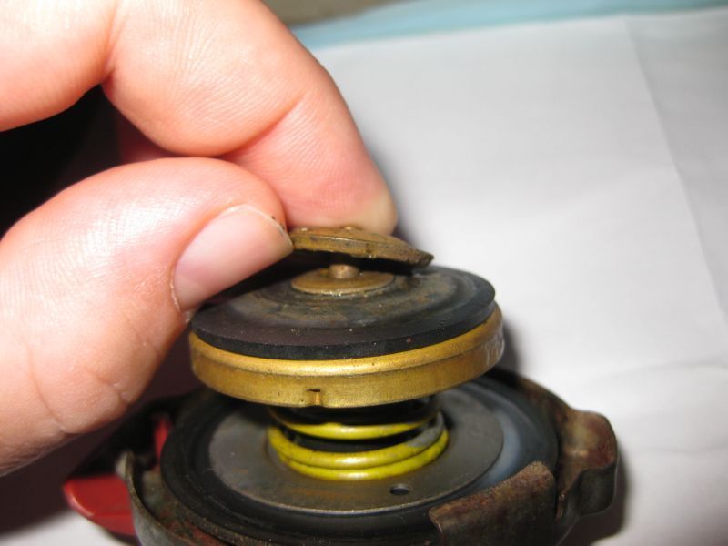

By "red pressure release tab", do you mean the lever, like the Stant cap uses? I use them in both of my cars. Perhaps you just got a faulty one. But, if you pull the lever, it will release the pressure seal. One way or another, that will equalize pressure in your system. The hose may pop back, and fluid may flow from the expansion valve back into your system.
There are two types of the Stant caps, though. Does yours have the vacuum release?
Stant 10330
Photo is from here:
https://ls1tech.com/forums/conversio...uestion-2.html
More photos here:
http://www.turbosport.co.uk/showthread.php?t=117321
