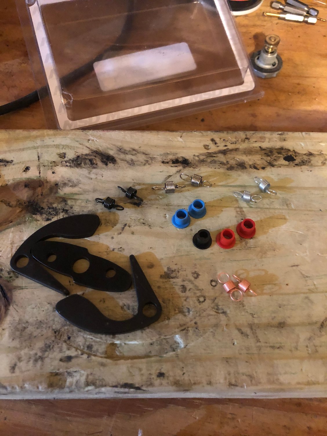

yes sir. I am bumping to 14 just for test since 24 is total mechanical curve spring is going to give me and take it from there. I think there’s lots HP left on the table on my motor as it sits right now

I got the parts today. It’s a wasted of part where they send you weights and bushings and you can’t use them. Only thing out of 30 msd part is the light springs copper in color which brings it all in at 3000. I called msd and said what a waste it is but they said it’s just way they are packaged. Anyway, springs are installed and tomorrow or Saturday I will fire her up and retime and retune. I don’t even know what the even pack those black springs maybe for track and race purpose. Msd also said that 8428 kit is mainly for GM stock HEI where they need to use the bushing and weights. For my msd street fire, only the spring is needed.
