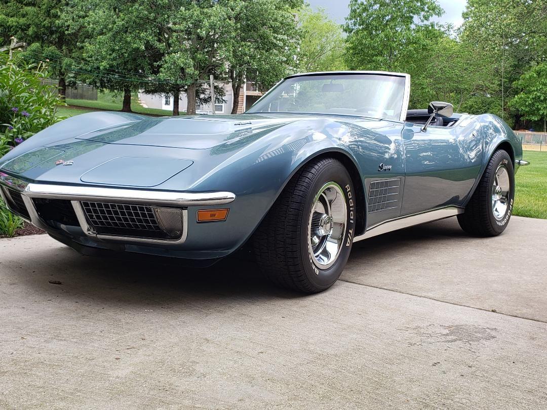

I have a 1975 tachometer in my BB restomod. I used it to get rid of the gear driven cable drive tach used up to 1974? When going thru the gears under hard acceleration, it is about useless because the needle flops up and down, bouncing until finally settling once I am near the top of the rpm near the shift point. Is this just part of using this tach or does some one have a fix?
It has an MSD distributor 8365, tach pick up single wire.
Has anyone tried the in line 10K ohm, 1/2 watt resistor?
08/27/2022, UPDATE, After traveling for a couple months to escape the cold weather and finishing up on multiple house repairs, I got back to the "hobby" car. I put an inline resistor (10K x 2). Shortened it, soldered 1/4" male and female spades on each end, covered it with shrink rap. It absolutely works. Steady as can be. I believe it eliminates the MSD coil interference. I am sure a tach filter would have worked also. Thanks for the suggestions and advice. Sorry if it was a "dumb" question to begin with. Didn't mean to frustrate anyone.

wow what a great car and color...
