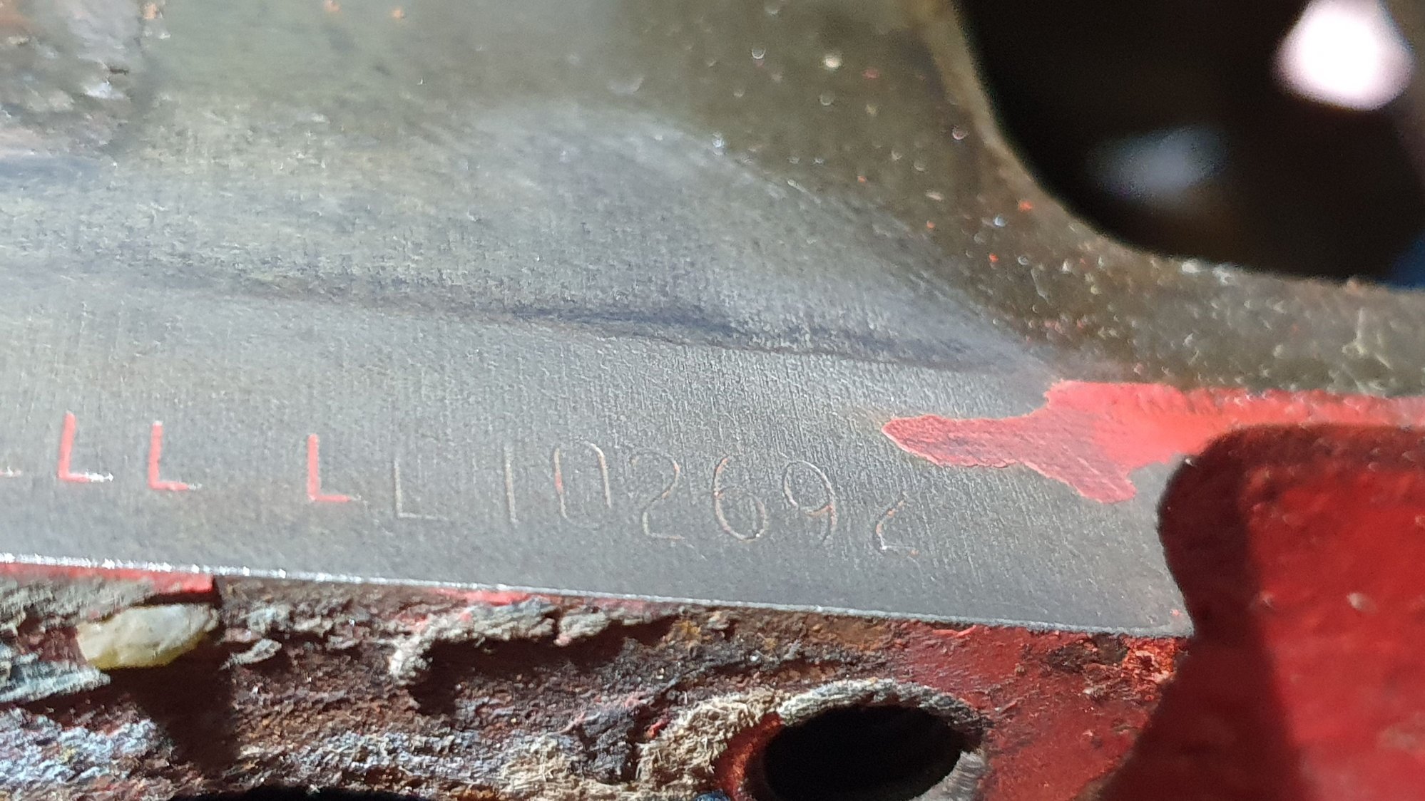

What BB engine block do I have here ?

IN indicates 66-68 396/325 hp. VIN derivative makes no sense.

Heads off....what size is the bore?

Thanks !
And yes, it looks a bit crazy !!
Jebby
I will measure tomorrow, when I go to the workshop

Shoot some pics of the “shelf” area in back. Left side should have the block casting # and the right the date code for when it was cast.
Ok I will, tomorrow :- )

couple extra Ls ,, Is this a 4 bolt main motor
