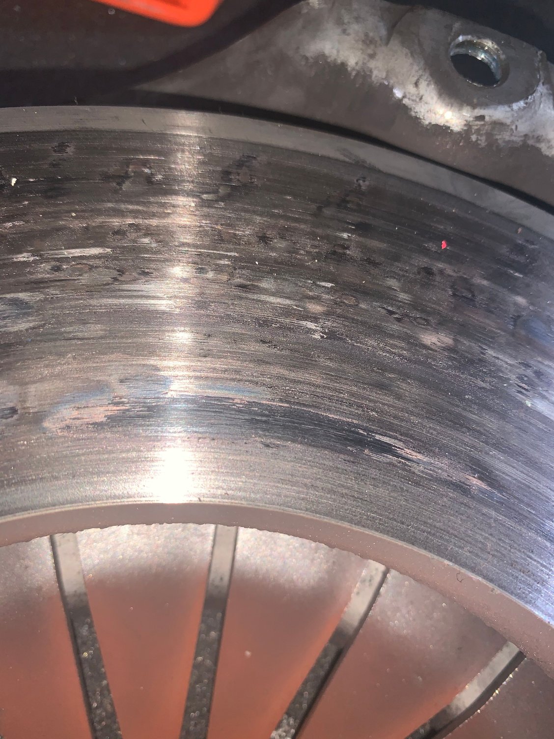

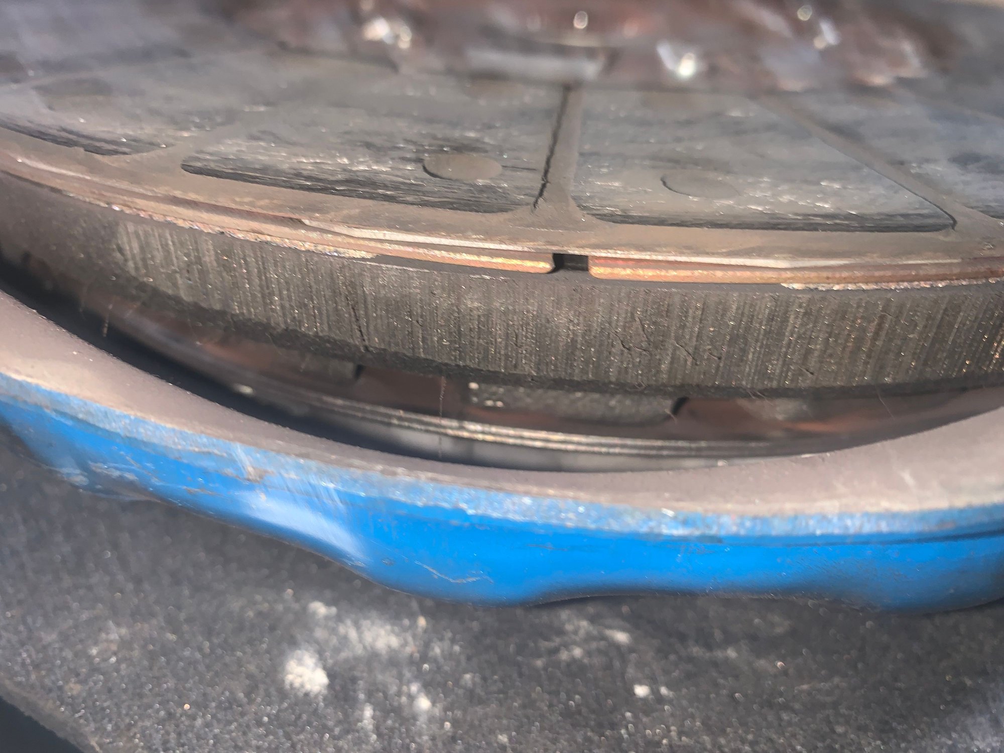

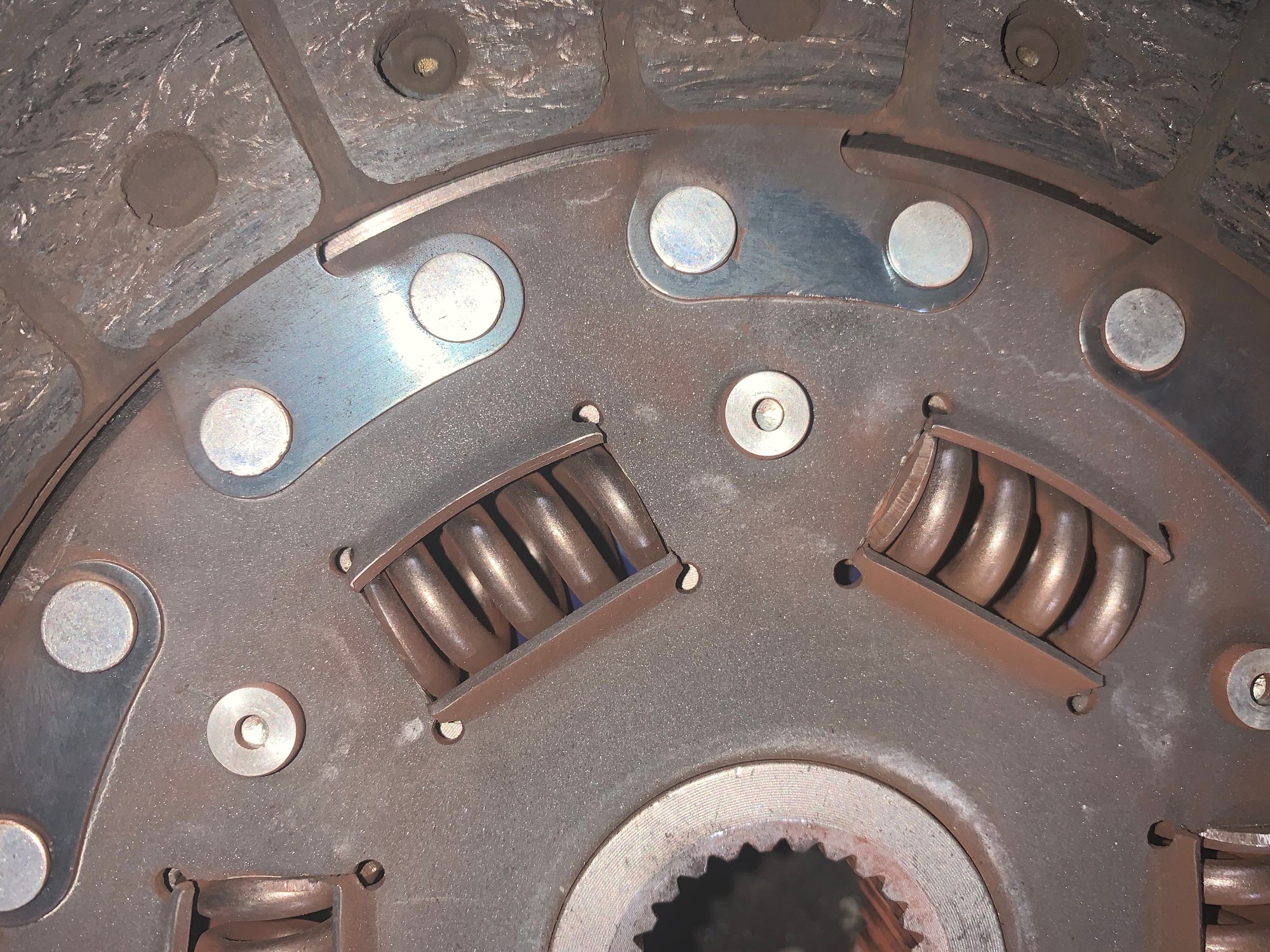

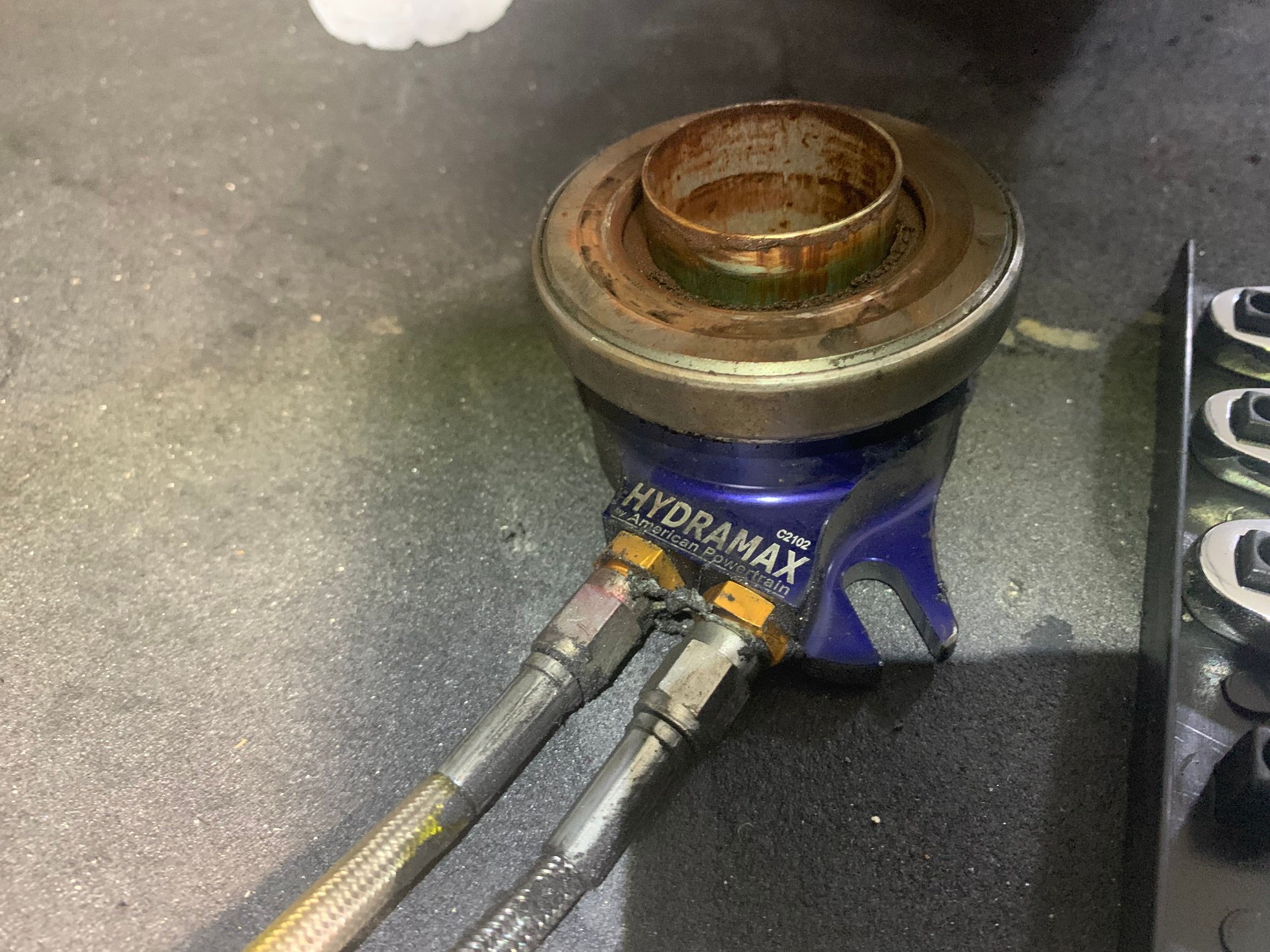

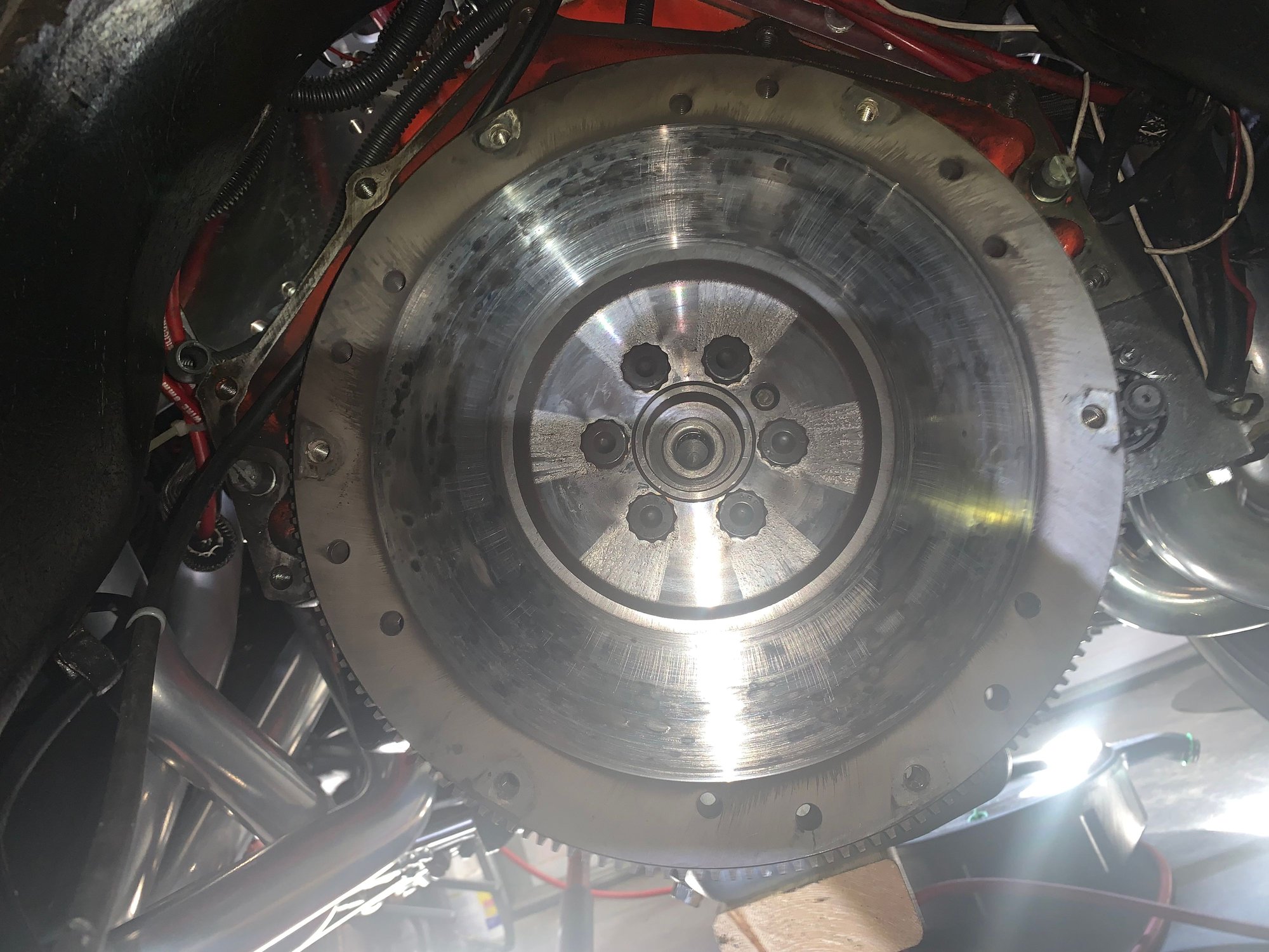

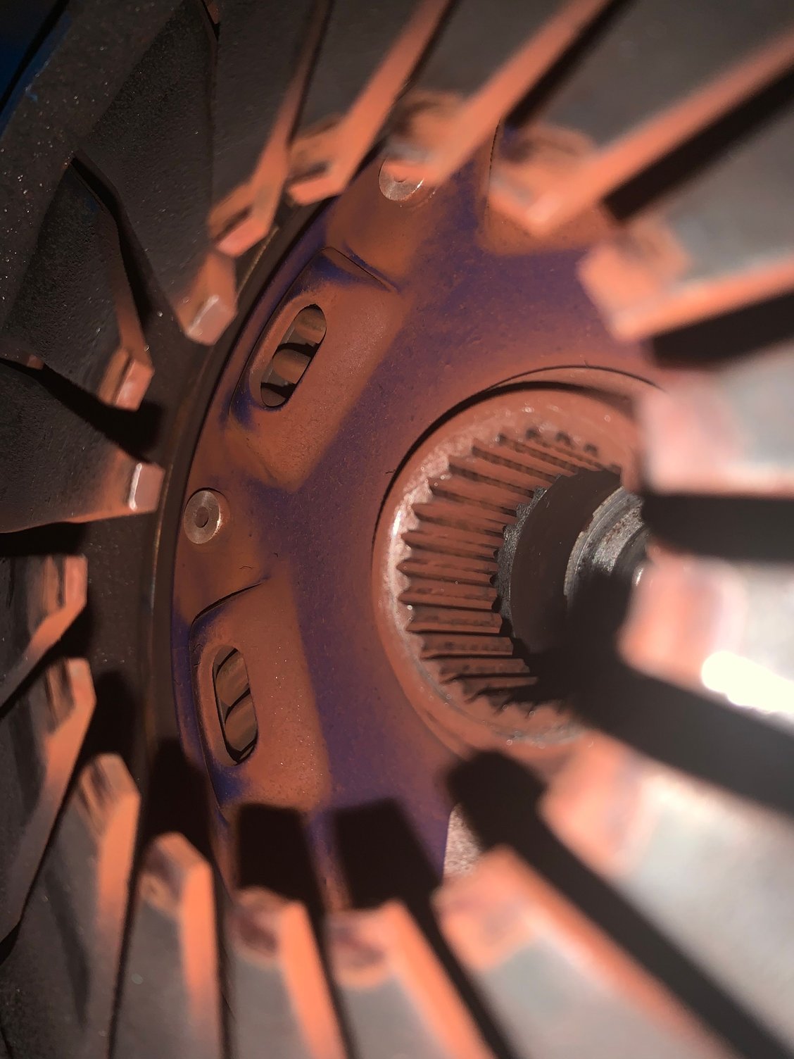

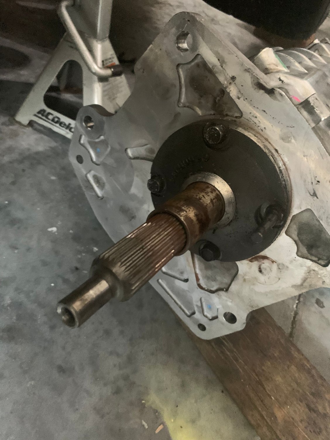

Ok, finally had some time to pull every out. Pictures of all components below. Please keep in mind that this set up was brand new and has at most 800 miles.
advice and questions welcomed.

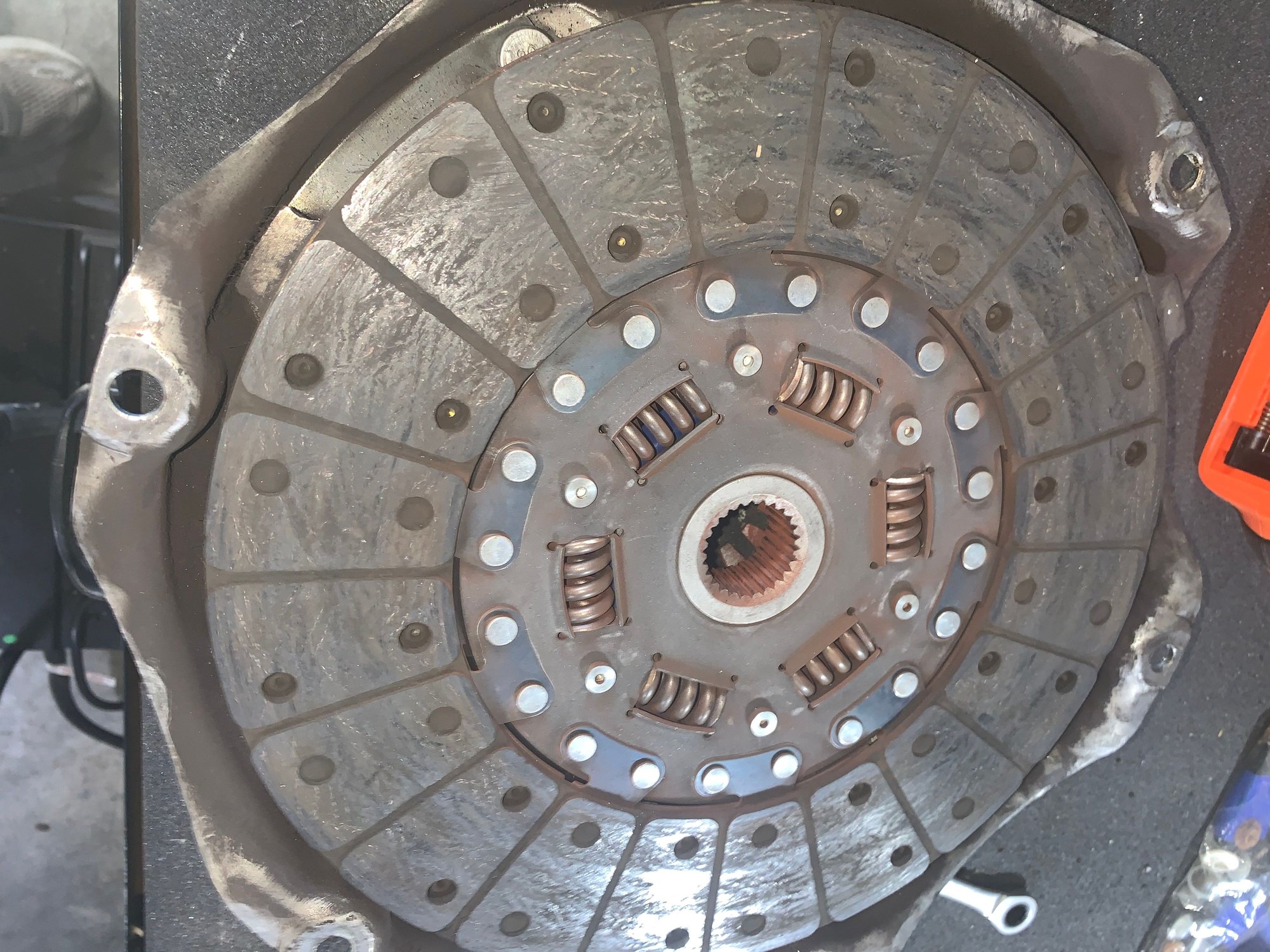

The disc looks like slightly uneven wear in the pads but could just be my vision. Do these look like 800 miles of wear? I don’t remember how thick they were new. Rivets look untouched

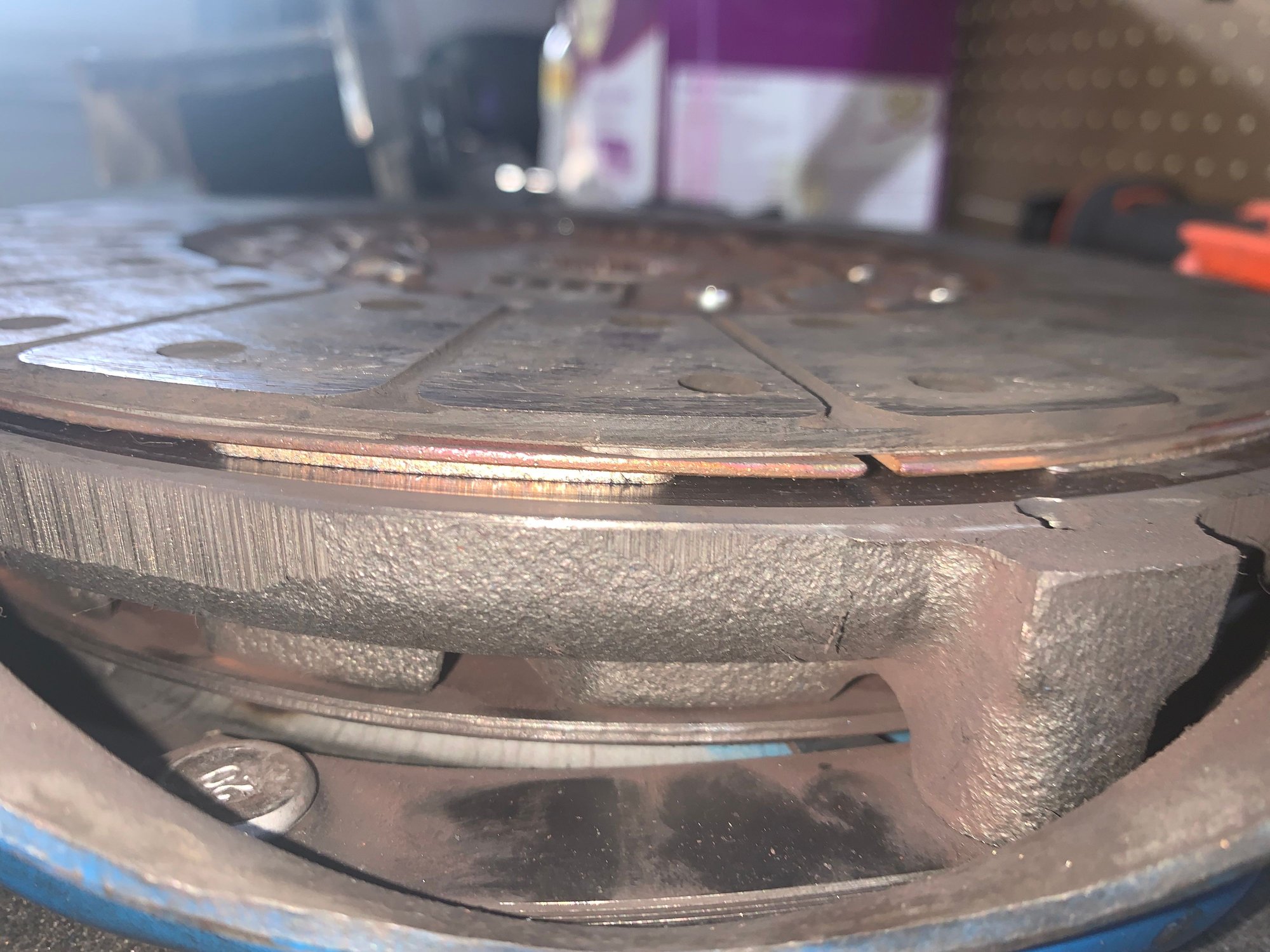

Side view of disc

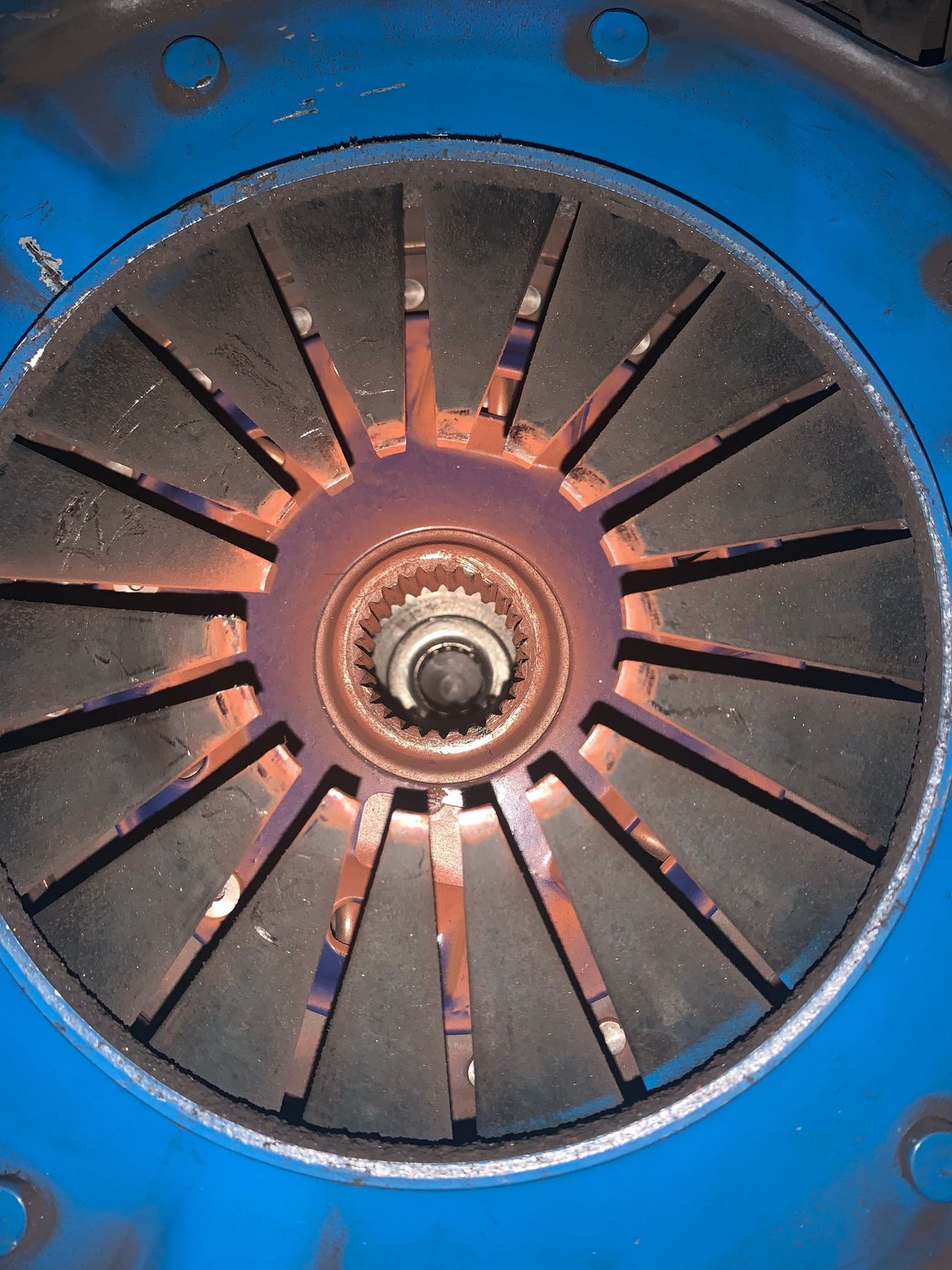

A couple fingers look bent in. Probably from my install fight when new. Notice a ton of dust built up in orange.
PP surface
Flywheel looks ok to me. How do you know if it’s glazed?

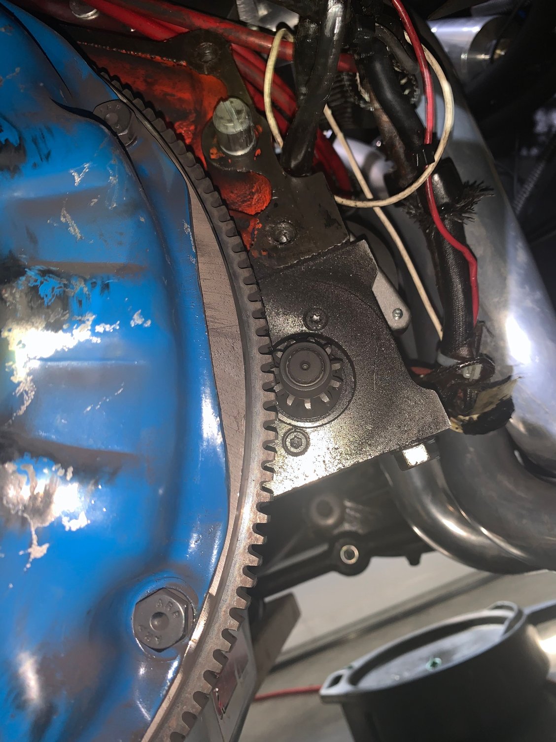

Starter area with heavy oil film. Not sure where that’s coming from.

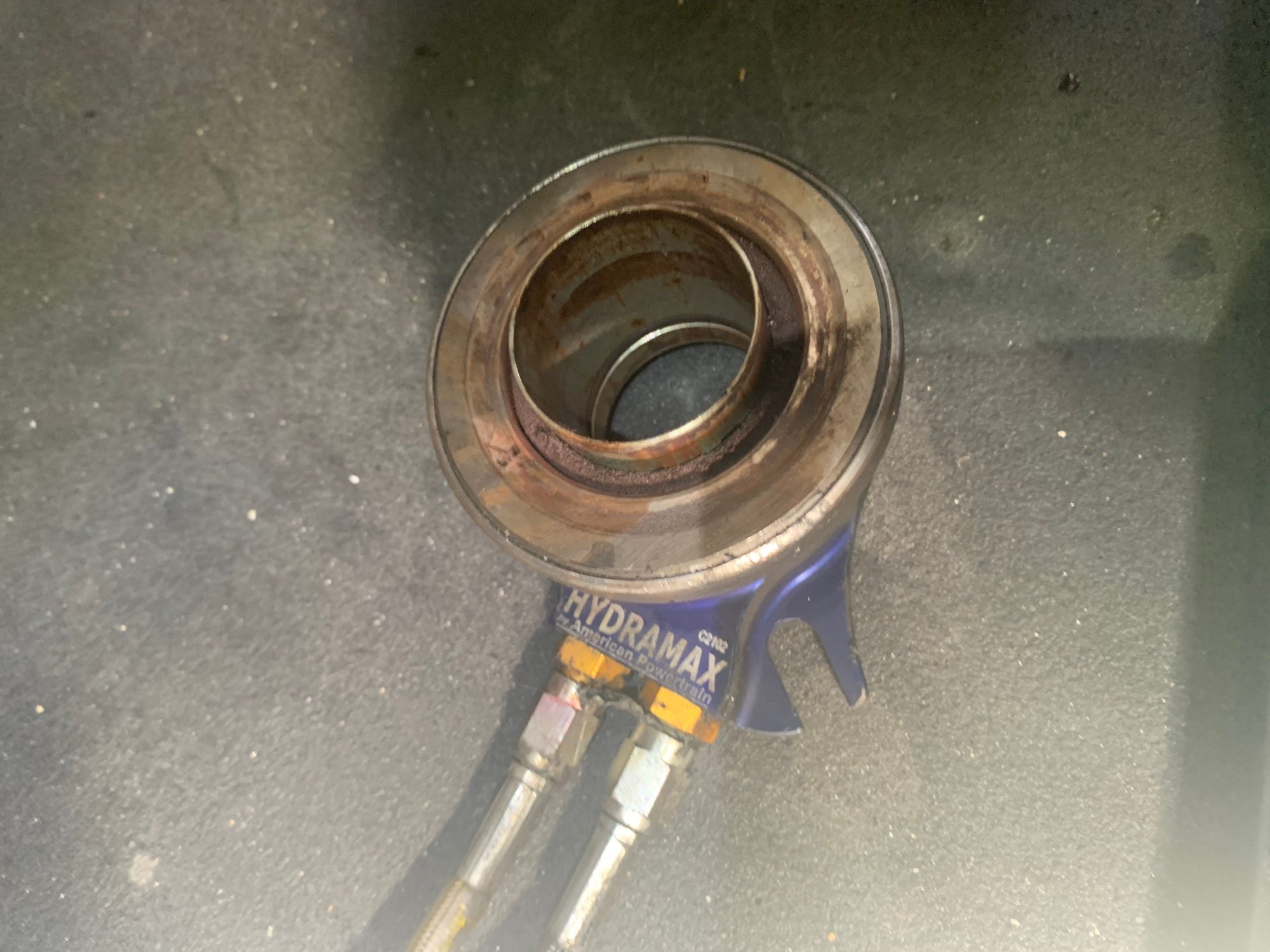

TOB. Don’t see any issues with it. Looks like a good clean up and reuse. Any issues with that?
Tranny after removed. Had to tighten down the 4 bolts holding the shifter to the tranny as they were a little loose. Other than that the shaft has some very slight movement but don’t remember if that’s normal or not.

my tranny shaft also could move no issue..
probably nothing to do with your issue but... what's up with the fingers being out of shape? and length?? what brand is that? i don't think you bent them
also maybe the clutch itself is not releasing as designed? i think Lars did a write up i cannot find..
EDIT
here it is
https://www.corvetteforum.com/forums...vel-range.html
mine were all same size?

Bent fingers is from cooking the clutch. Heat does that. Heat comes from slipping. The heat warps the diaphram spring. Maybe the disk warped too.
Clutch must be replaced after the cause of the slip has been identified.
My money is on the throw out bearing setup keeping pressure on the fingers with your foot all the way off the pedal. Load on the engine makes the disk slip creating the heat.
This would be a lot easier to fix with a stock mechanical pedal linkage.

I really don’t recall but I’m betting the clearance was miscalculated by me. I will be ordering a new clutch and pp plate. This one was a centerforce. Not sure I will go with that again. I will measure the clearance when I get it all put back together.
based on the pictures, is the flywheel good? Should I do anything to it while I have it exposed? It has 800 miles on its life.

I would have it resurfaced so when you get a new clutch it will be embedding the same disc material. You can buy a surface hone like the one that brush research makes for flex hone

What is causing those trails of goop on your flywheel flinging out from under the flywheel bolts? Is that just a lot of anti-sieze? Whatever it is, It probably isn't helping you there.

I'm betting on improper clearance between the TO bearing and the PP fingers. Looks like it was not fully releasing and you were getting a lot of slippage and eat. I also do not like the looks of those fingers. They should all be the same. I just went through this with an SST kit. I had to put a spacer between trans and bellhousing as they suggested a minimum of .150. I was at best I could get was .095. SST sent me a spacer to install. I did and so far we are good. You TO bearing is a different design but I'll bet your clearances are off.
if we are looking at the same thing it’s clutch disc material.

i think he means these lines, might have contaminated surface..
One lesson i learned with my McLeod clutch which has been fantastic.. or any other clutch.. i use an entire roll of paper towels with lacquer thinner to clean the flywheel and plate before it stopped being black.. clean very well...
I believe that was the way the wheel was made.
