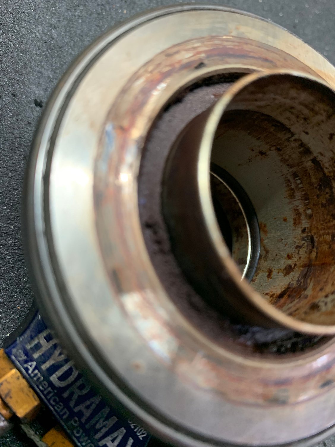

The tob has a ring on it where it was touching the fingers. It has dug into the surface of the bearing. Is this normal? How do I account for this groove depth when I measure in setting it back up to achieve spec?

does the bearing turn freely? the rollers are supposed to roll and the flat surface is supposed to turn at the same speed as the fingers. looks like they are spinning across the surface, goring it. so i call that a bad bearing...

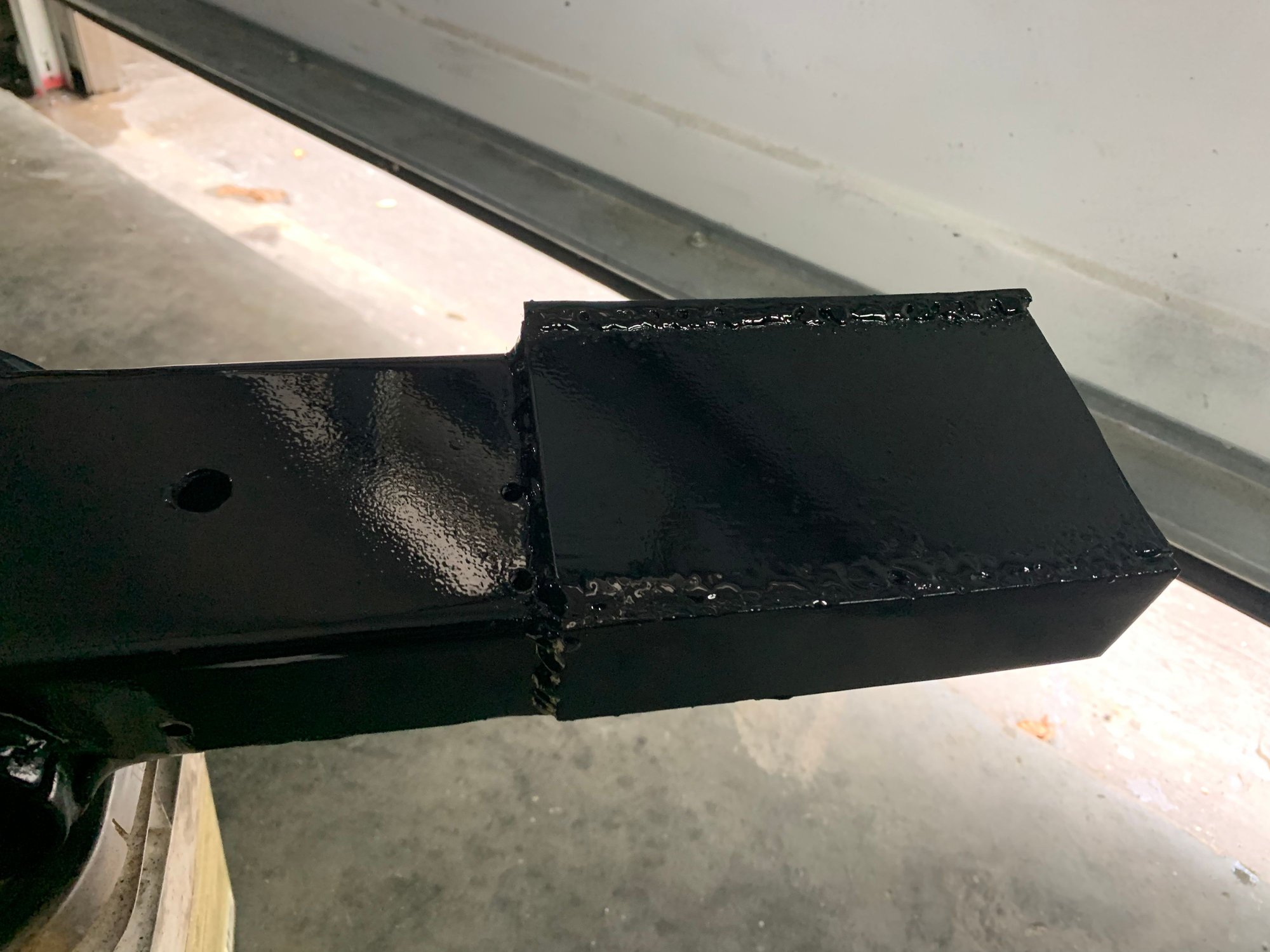

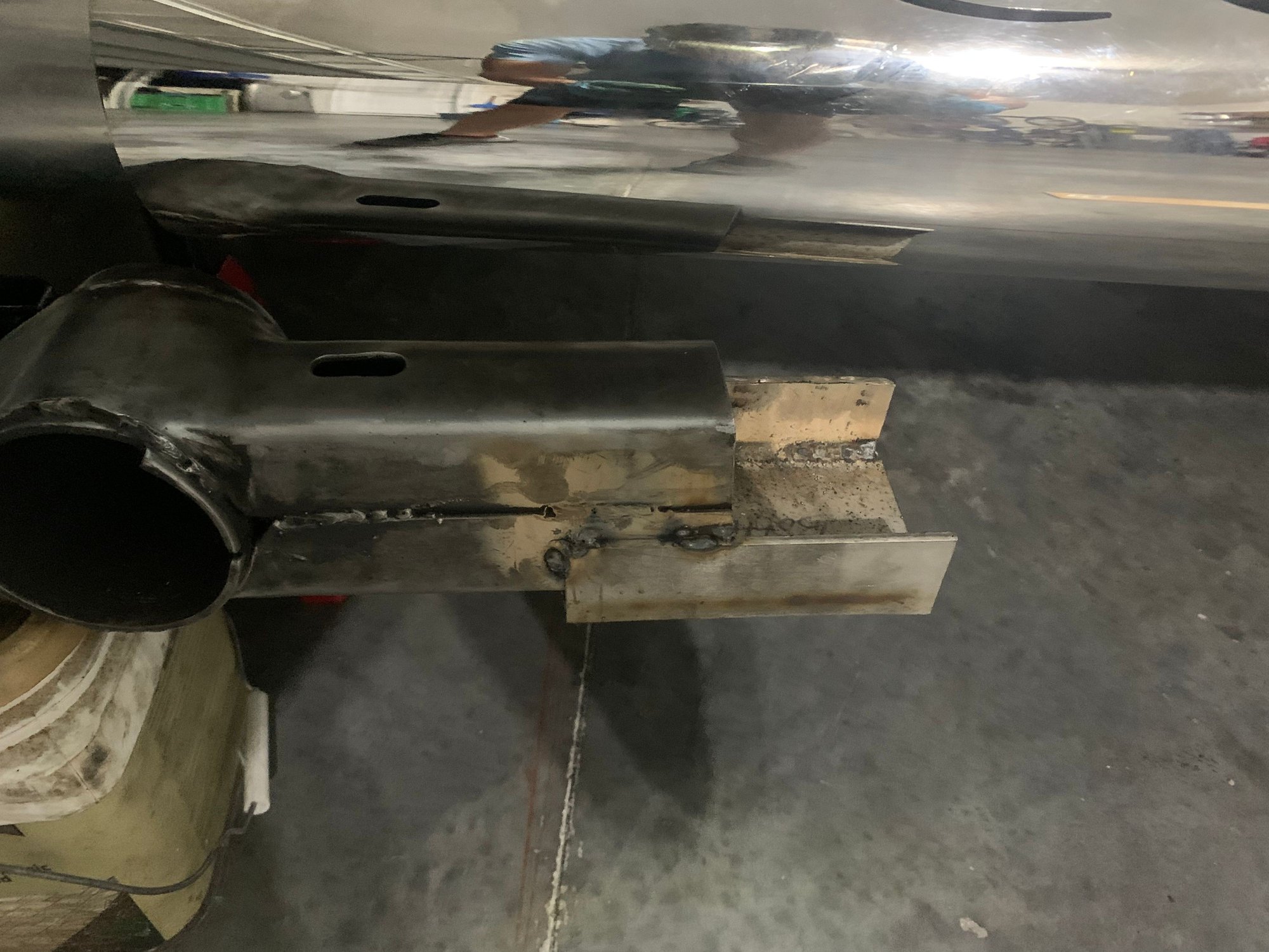

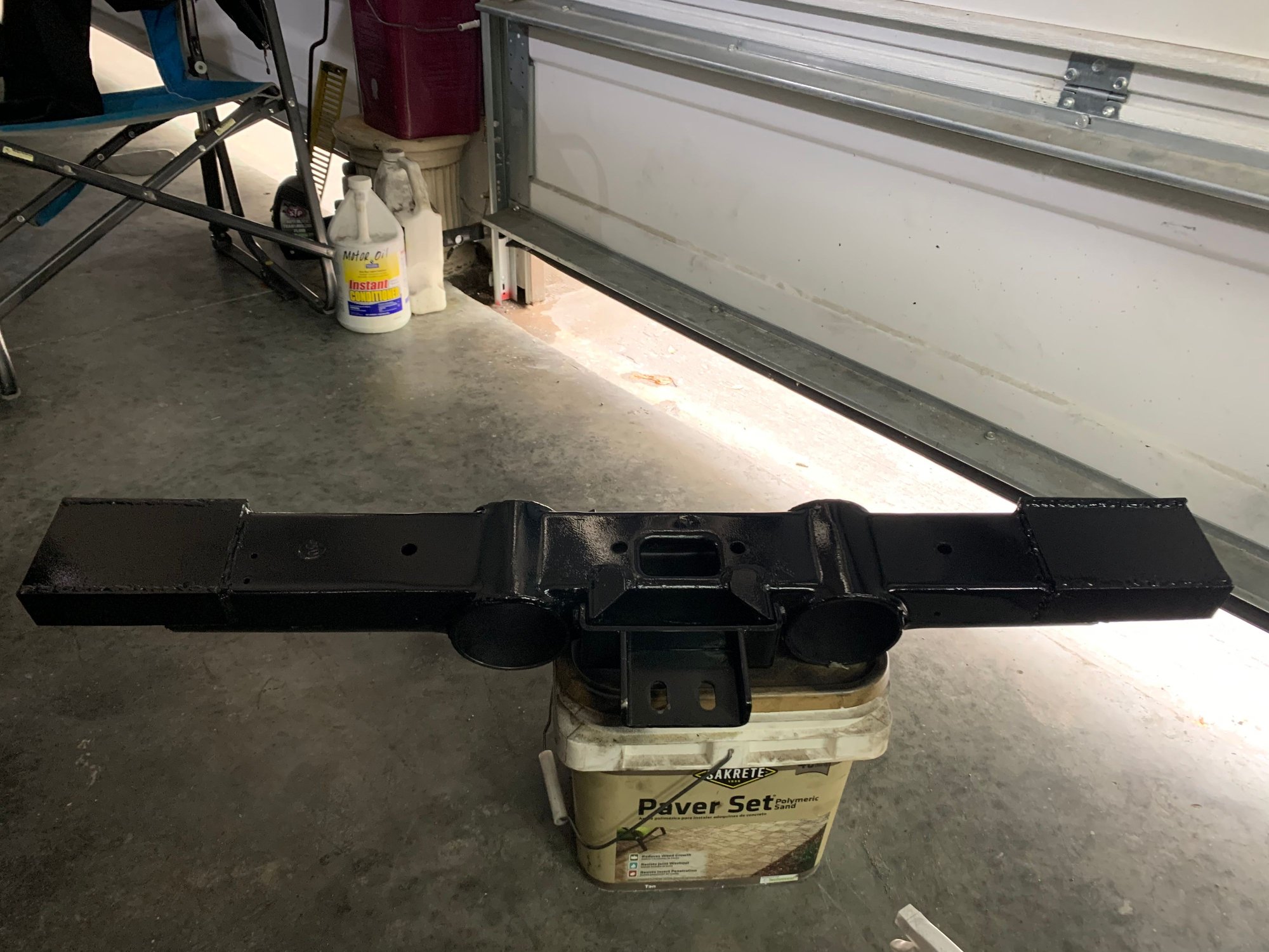

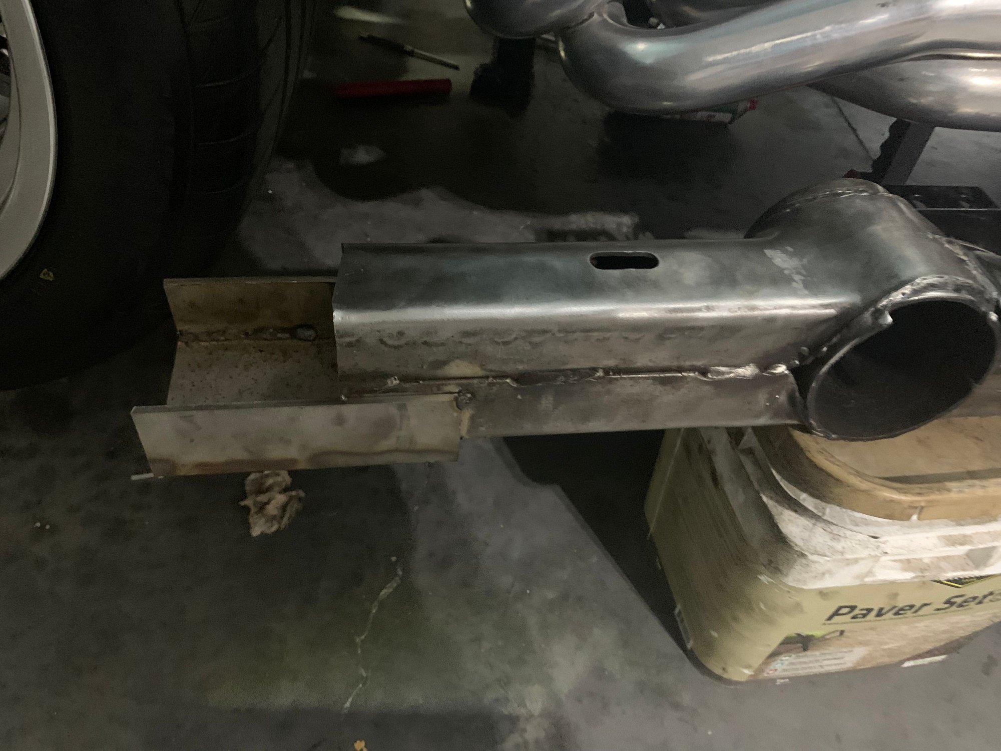

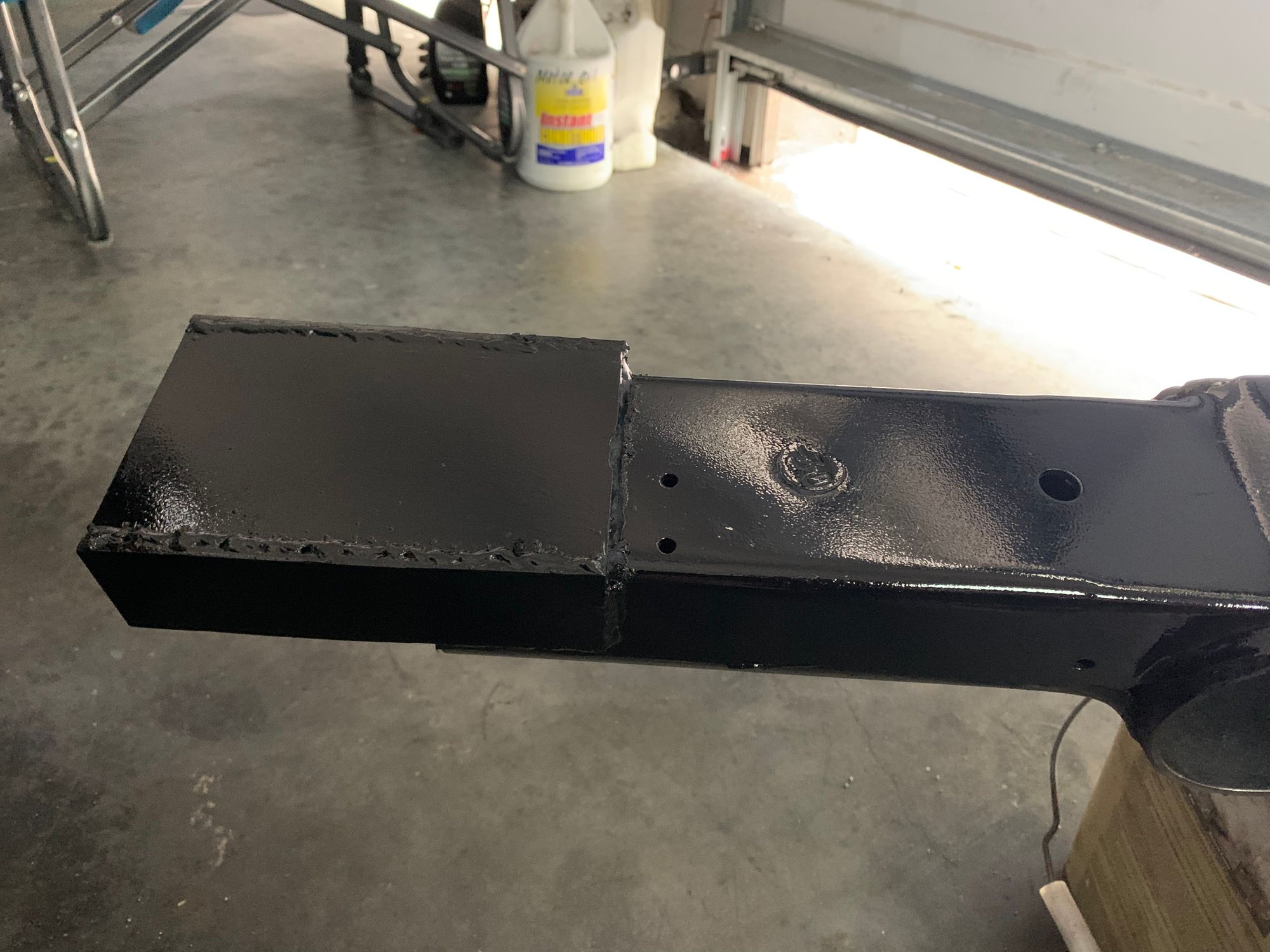

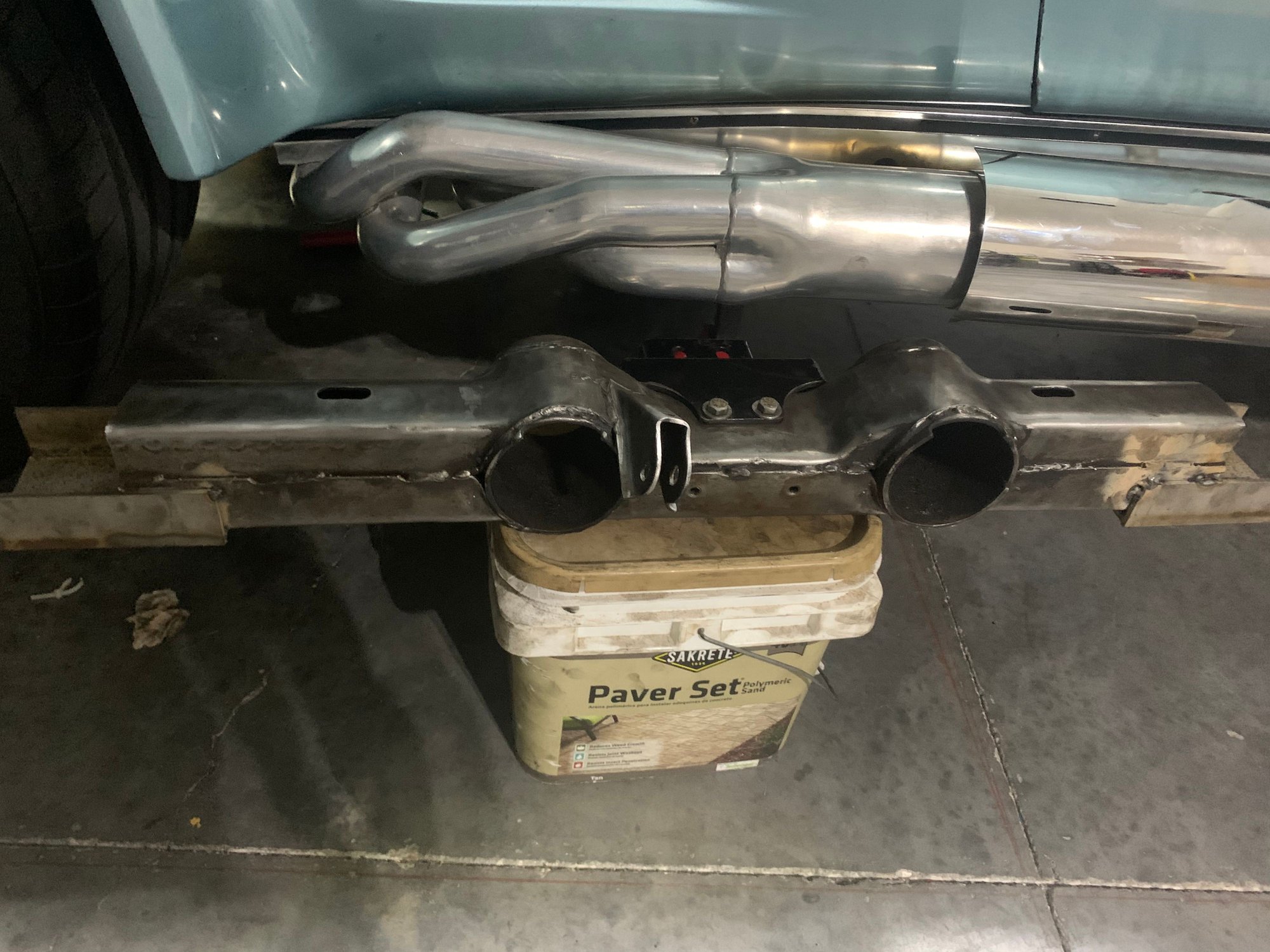

Finished welding the cross member brackets and painted it. Got the clutch in and got my measurements. Face of tranny to face of bearing is 2.55. Fingers to face of bell is 2.607. Not enough space. Before I proceed I’m going to put some thought into this and remeasure a few times.

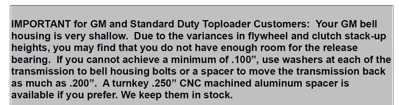

OK so you have about 57 thou free space. Most specs call for around 150. So you need to remove a shim, if present, get a thinner throwout bearing, or add a spacer between block and bellhousing. I think that was what Gordon said he wound up doing. I would call whoever you got the T/O bearing kit from and spec to them.
I just lifted this from the Hydramax install notes.
They mention this issue: And also adding washers or the plate Gordon did.
thanks, Leigh. That’s what I’ll end up doing. I’ll get some washers I can place between bell and tranny to get me in the spec. Going to remeasure a few times first. This is a McLeod clutch so not the same depth necessarily as the centerforce one I had but it may be that I had the bearing in too tight with no space all along and it didn’t show signs of slippage until after 800 miles. I’ll keep the thread up until I get final solution. Thanks for your help.

SST sells a spacer that goes between the trans and the bellhousing. As I recall it is .250 thick. Does you TO bearing give you a max clearance.

And BTW I love the home-made removeable crossmember mod too!

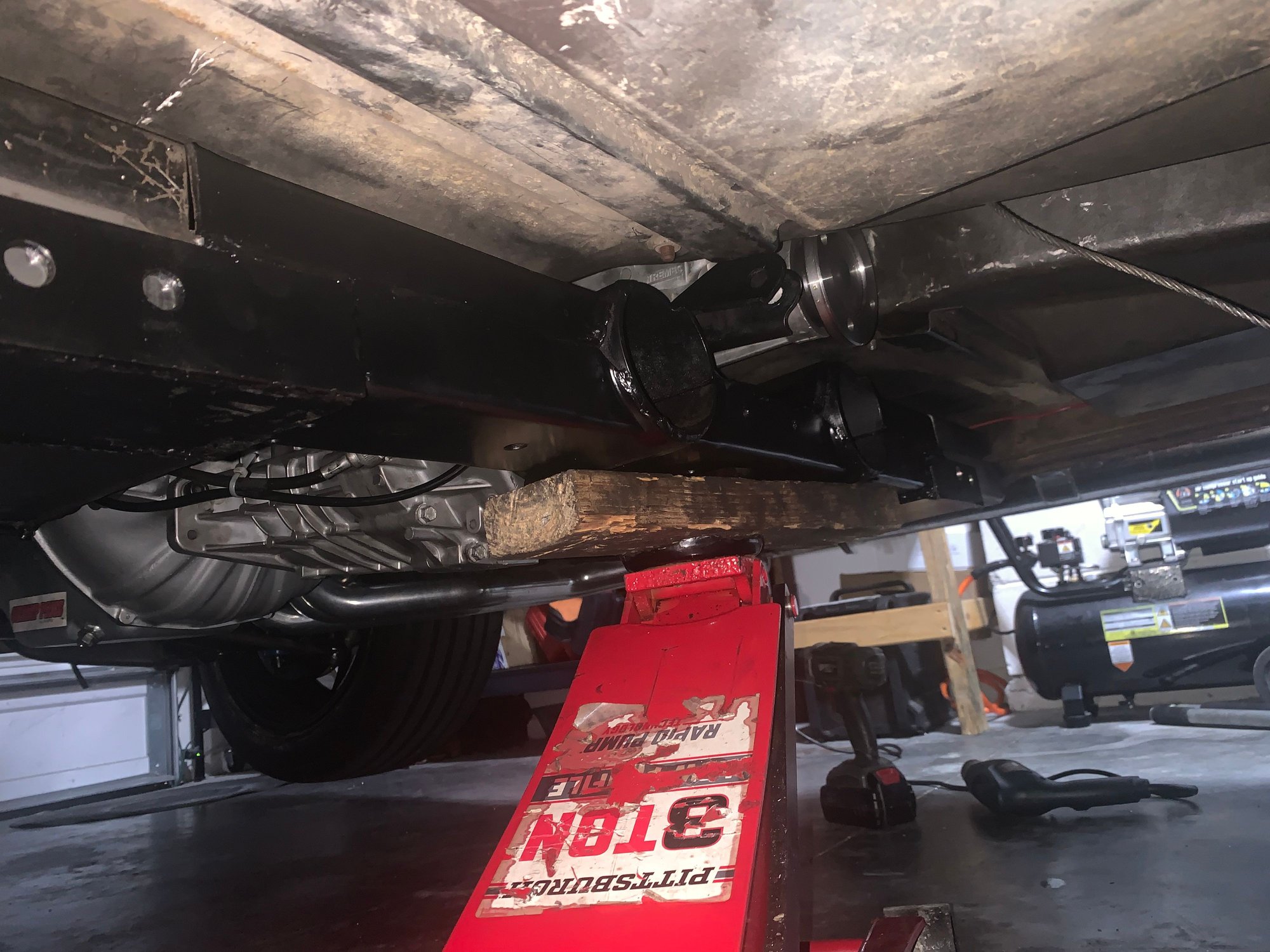

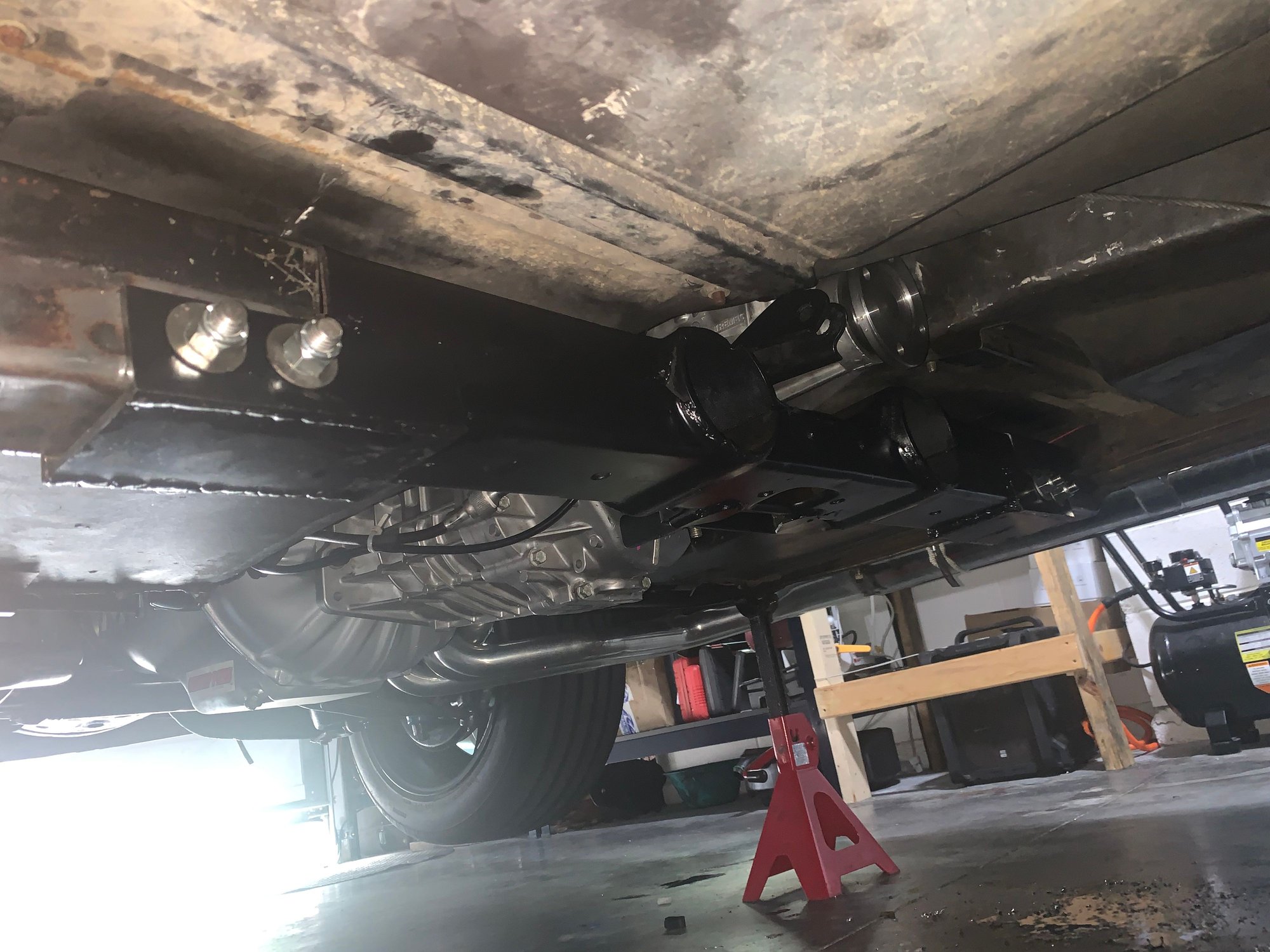

Got the crossmember mounted to the frame. Got the tranny filled up with oil. Just need to drill out the holes for the bolts. I got my daughter to push the clutch pedal so I could look at the tob. It was definitely moving but not sure if it’s moving forward enough. Hard to tell but hopefully I’ll be firing it up soon to test things out.

Finished putting in the removable crossmember. Just have to put in the driveshaft and the ebrake line and pulley. Test tonight! Any advice before I fire it up?
